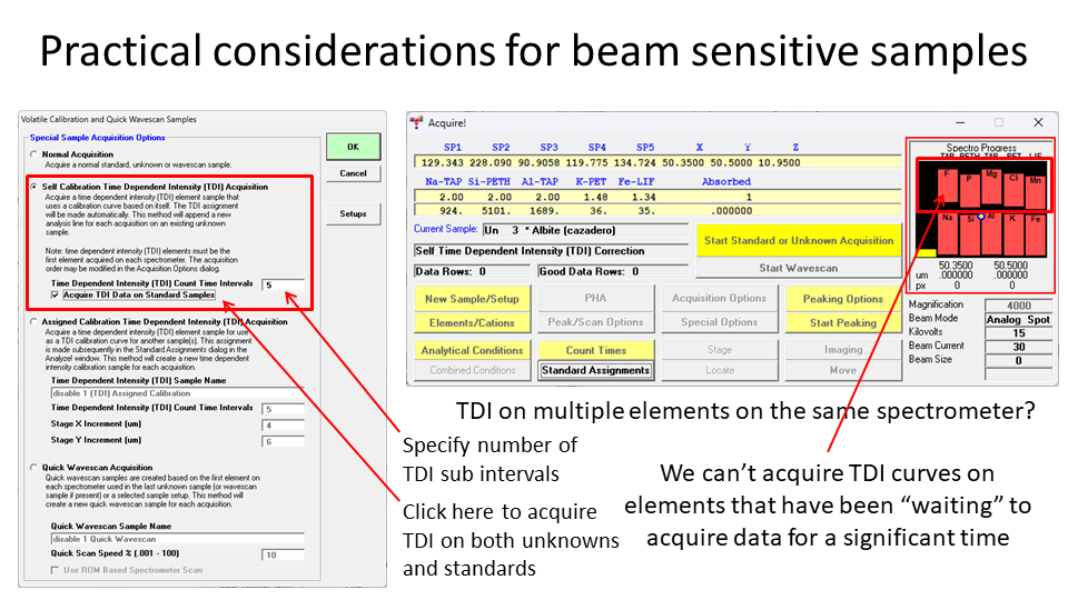

It would be great to be able to do TDI correction for EDS elements, I'm currently having the issue that I can do Si TDI, Na TDI, K TDI, but cannot do Al TDI because I'm using  2 TAP, 2 PET, 1 LiF, and you can only do TDI on first element. If I could do EDS TDI, I'd be able to do TDI on all the major elements and not be limited to 5 elements and by the spectrometer crystal selections.
#84
Quote from: Ben Buse on Today at 02:29:26 AMIt would be great to be able to do TDI correction for EDS elements, I'm currently having the issue that I can do Si TDI, Na TDI, K TDI, but cannot do Al TDI because I'm using  2 TAP, 2 PET, 1 LiF, and you can only do TDI on first element. If I could do EDS TDI, I'd be able to do TDI on all the major elements and not be limited to 5 elements and by the spectrometer crystal selections.

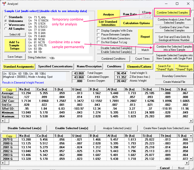

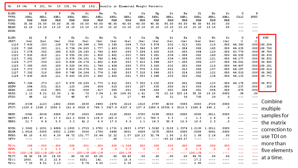

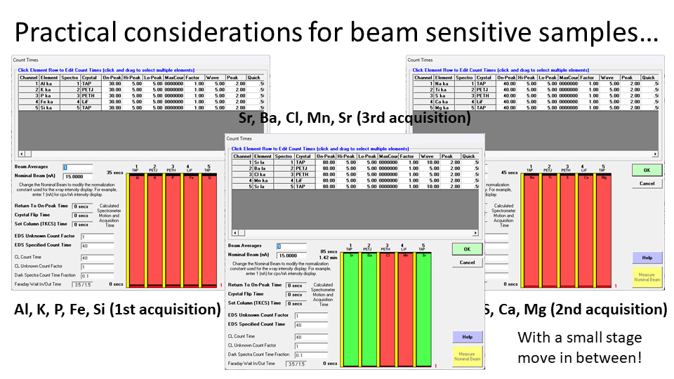

Adding TDI to EDS elements would require that we acquire multiple EDS spectra for each data point. The code changes would be massive.
But there is a solution for applying TDI corrections to as many WDS elements as you want. Normally we acquire all the WDS elements in one sample setup:
But instead we could acquire more than one sample setup each with a TDI element for each spectrometer:
Where each sample setup is acquired in the Automate! window (or manually in the Acquire! window) with a small stage step in between each sample. Then we combine the samples using one of these two buttons in the Analyze! window:
Then we get the output of all the elements each with TDI corrections:
