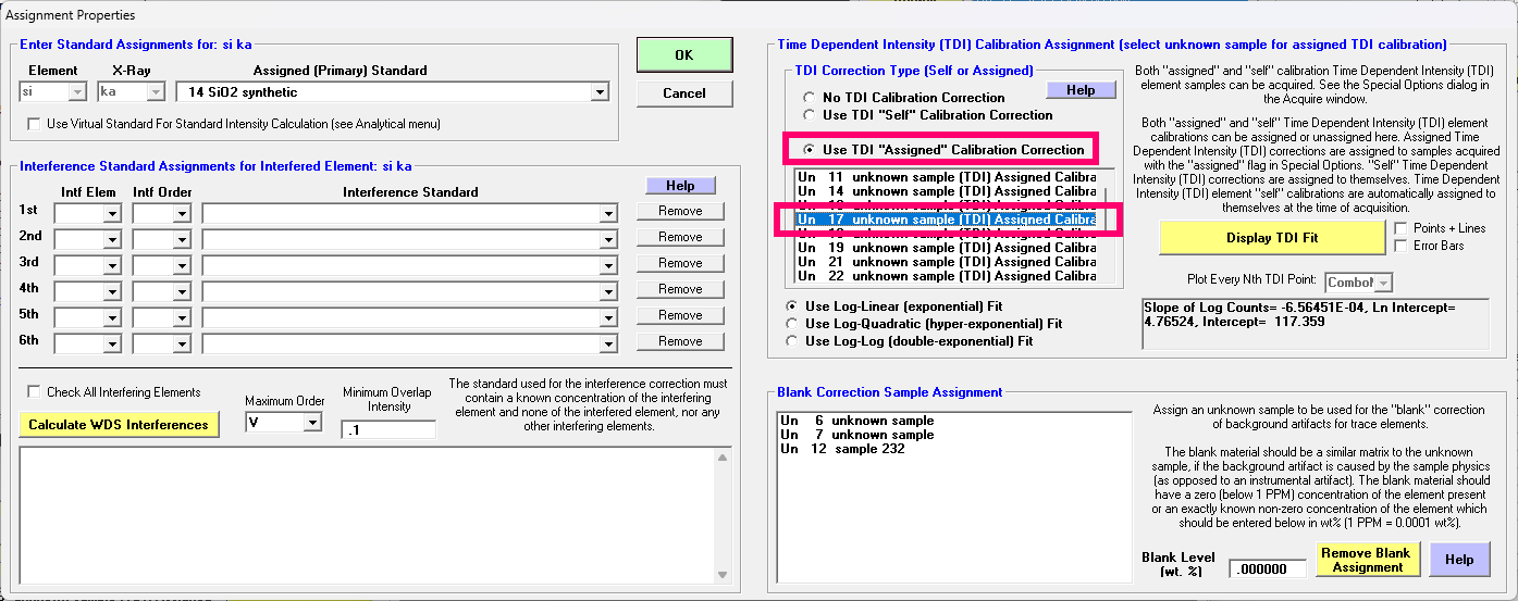

When I assign different TDI fits to the sample, either from the Standard Assignments dialog or the Run | Save Time Independent (TDI) or Alternating (on/off) Intensities menu, when exporting using the Output | Save Time Dependent Intensities menu window, it exports different fit coefficients for the different assigned fits.

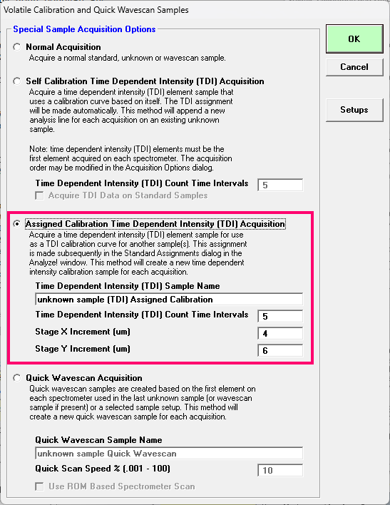

There is also another option for acquiring TDI calibrations on more WDS elements than one has WDS spectrometers and that is the "assigned" TDI acquisition option:
With this method the software acquires TDI calibration curves in a material that is similar in beam sensitivity to ones unknown with a stage step in between each group of elements.
This "assigned" TDI calibration can then be *assigned* to any normal unknown sample from the Standard Assignments window as seen here:
Originally I developed this method at UC Berkeley back in the day because Ian Carmichael wanted the TDI (or volatile correction as we called it back then) applied, but wanted to be sure that the same slope correction was utilized for all data points in the sample for statistical purposes.
That is, any variation in the data points was therefore due primarily to compositional variation rather than to the TDI statistics themselves.
So that's another option for applying TDI corrections to many elements.
Note: we found and fixed a small bug in the "assigned" TDI acquisition in certain circumstances, so please update Probe for EPMA from the Help menu or our Resources page before trying this technique:
