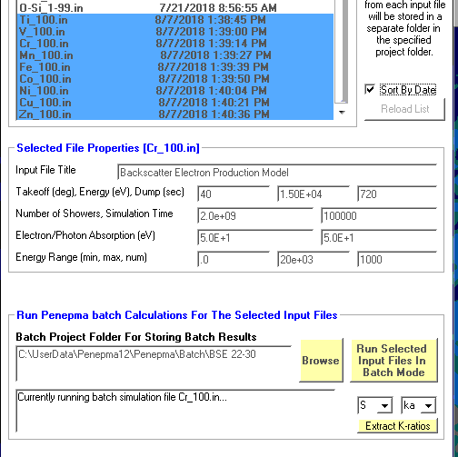

The question now is: how accurately does Penepma model these nuclear screening effects for elastic scattering of electrons? I really should ask Xavier, but I'll let the calculations finish first.
I'm running 100,000 sec per element so I hope that's enough precision. I did remember to optimize for BSE production. It's only on the 3rd element as seen here:
I might plot up what I have on Monday though...

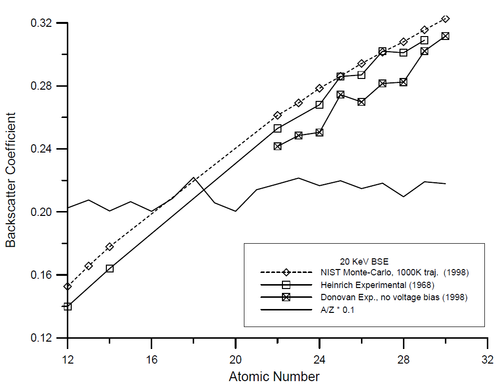

#20
Many moons ago we published a paper (Donovan, Pingitore and Westphal, 2003) on electron backscattering and the effects on that by atomic mass vs. atomic number.
The bottom line is that mass has essentially zero effect on backscatter loss, while the BSE effect is essentially solely related to the effective nuclear charge of the nucleus, therefore the effect is almost entirely due to electrostatics. This claim is something that physical scientists generally accept after a few minutes of thought, but some, at least at the time, seemed surprised by our results.
After the paper was published, we had a response from Stephen Reed who suggested our "proposal should be treated with caution, pending more rigorous testing".  Of course we are all for caution and more rigorous testing, but we still stand by the claim today, and more recently we have repeated these measurements and calculations, and found them to be reproducible both empirically, and theoretically, based new measurements and on the latest Monte Carlo models, as seen above in this topic.
For those interested in the gory details, the full paper and the response by Reed and our response to Reed's response are attached to this post:
https://smf.probesoftware.com/index.php?topic=1111.msg7448#msg7448
There will be more to say on this subject, but please feel free to make your own measurements and calculations and share them with us.

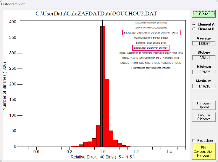

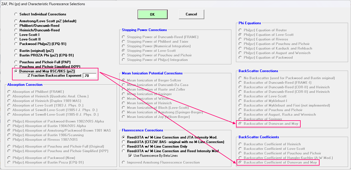

Following up on the above paper Aurelien and I published earlier this year, we've implemented the new Z based backscatter corrections in both CalcZAF and Probe for EPMA. This new Donovan and Moy (DAM) backscatter correction is available from the ZAF/Phi-rho-Z options as seen here:
To compare the new Z based DAM backscatter correction we implemented above, with an existing mass based backscatter correction, we replaced the Love-Scott backscatter correction in the Armstrong-Brown-Love-Scott matrix correction option with a modified PAP backscatter model using the new Z based fits we prepared using PENEPMA backscatter modeling of pure elements and compounds.
Here are the error distributions comparing measured k-ratios (from the Pouchou2.dat input file with 826 binary k-ratios) with k-ratios, first calculated using the existing Love-Scott backscatter correction:
Note the average error is 1.00845 +/- 0.047. Now using the the new DAM backscatter correction we obtain this error distribution:
with an average error of 1.00537 +/- 0.036, which is a small but significant improvement over the traditional mass based backscatter correction.

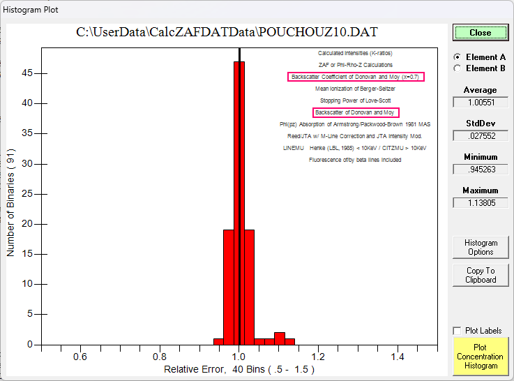

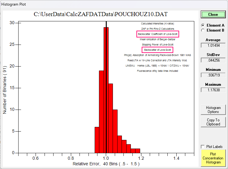

We can see the effects more easily using a partial k-ratio dataset which contains only matrices with a significant backscatter correction, e.g., greater than 10%, by calculating the same error distributions using the input file PouchouZ10.dat shown here for the traditional mass based Love-Scott backscatter correction:
which shows an average error of 1.0149 +/- 0.044. Next we examine the same partial k-ratio dataset using the new Z based DAM backscatter correction:
which gives an average error of 1.0055 +/- 0.027 which is a quite significant improvement over the mass based backscatter model!
