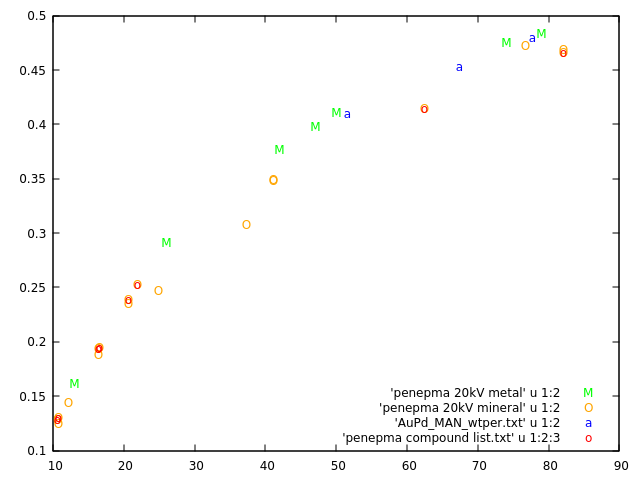

Here's a plot from penepma of metals, alloys and oxides. Errors approximate symbol size
It suggests oxides plot lower than metals or alloys, any ideas?
Win x-ray gives good agreement to penepma
Materials simulated
I should point out that density is not the problem see screenshot results for diamond and amorphous carbon are the same

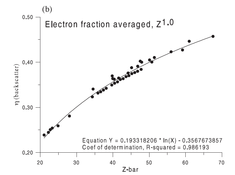

So let's refer to a figure from a paper we published in 2003 where we plotted Monte Carlo calculations (using NIST"s MQ software) of BSE coefficients versus average Z for a number of pure elements and compounds as Ben did in his original post:
Note that here we are using weight fractional averaging to calculate average Z for the compounds just as Ben did and it appears very similar to the two other Monte Carlo softwares. Now let's do the same plot but use the Z based fractional averaging (called here, electron fraction averaging, but protons/electrons- it's still Z based):
It's a better fit, but still not perfect.  What could be the issue?

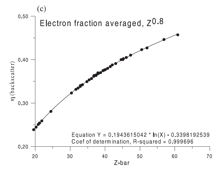

Well as we have all observed, as the atomic number increases, the amount of backscattered electrons does not increase linearly.  The BSE coefficient curves starts to bend down beginning around zinc (Z = 30 or so). Why is this?
It's because of partial "screening" of the nuclear (proton) charge by the inner electron orbitals of atoms with higher Z (as pointed out to us by Dale Newbury from NIST at the time). Basically it means that incident electrons do not always get to "see" the full electrostatic charge of the nucleus in the higher atomic number elements.  Therefore they are elastically scattered a little less than one would think, given their atomic number.
So we need to correct for this nuclear screening by the inner orbital electrons effect, and so we tried a couple of exponents and found the following fit of Z^0.8 works beautifully as seen here:
Like beads on a string!    :)

If you are interested in the details I've attached the PDFs of our original paper, Reed's comments to our paper and our response to his comments. The latter is fun reading.

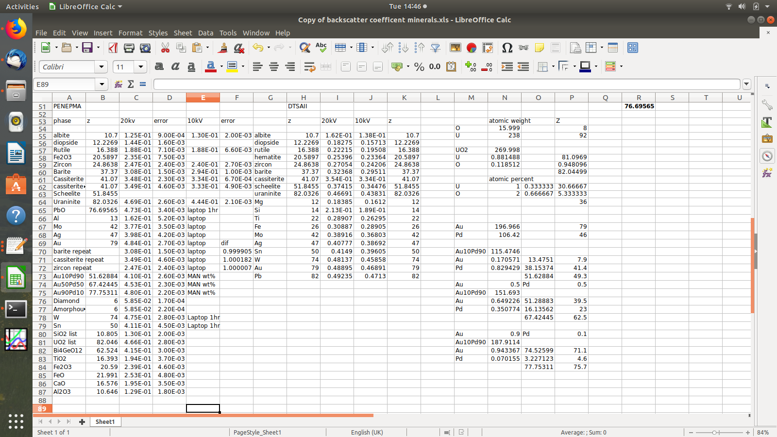

I've attached a spreadsheet which calculates the MAN using the different equations

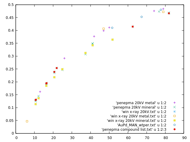

Here's the data for the metals and the binary compounds. You can see using electron fraction and 0.8 exponent, gives good agreement to metals' line.
And following Jon's good advice, I've added some axes labels, now we've solved the brain teaser ;)
So the Z fraction to the 0.8 exponent are the light symbols?   And the dark blue M symbols are the pure elements?
Now just do a bit more work on your legend and you'll have an actual plot!    :)
Yes I think your right! It certainly wouldn't get published!
light blue: exponent 0.8,
pinky purple - mass % calc.
black 'M': metals

The electron fraction Z to the 0.8 power is just a model, as weight fraction Z is just a model. The advantage of the electron fraction (or proton fraction or Z fraction whatever you want to call it) model, is that it makes one less faulty assumption than the weight fraction Z model: which assumes that mass affects elastic scattering of electrons.

When we did our original literature search for different ways to calculate average Z, we found that none of them worked that well for calculating BSE trends. The one that was closest was Saldick and Allen, 1954.  That was when we started thinking about what would be a better model and then we came up with the electron fraction model.
Then we noticed that our model and the Saldick and Allen model gave the same results, even though the equations looked quite different. Then we realized that their expression and our expression were algebraically equivalent!  See our paper here for that discussion:
http://epmalab.uoregon.edu/publ/Compositional%20Averaging%20of%20Backscatter%20Intensities%20in%20Compounds%20(M&M,%202003(.pdf
Of course as we pointed out above, the electron fraction Z to the power of 1.0 model was only marginally better than weight fraction Z model, and that was when we tried some different exponents to account for nuclear screening, and found that electron fraction Z to the 0.8 worked really well.
