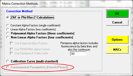

Hi Jakub,
As you know the idea of the quantitative spectral interference correction is to correct for the differences in the matrix correction between the standard used for the interference correction and the sample being measured.  Since the standard used for the interference correction must contain a known amount of the interfering element, *and* none of the interfered element, *nor* any other elements interfering with the element of interest, they are likely to be compositionally different. In fact, since we generally prefer an interference standard which contains a high concentration of the interfering element (for best precision), this is usually the case. Though not always!
But there's a trick we use in the spectral interference correction code to make the matrix correction of these obscure interfering emission lines much easier.
Because any photons from any interfering emission lines are being detected by the same spectrometer (which is already tuned to one of the major lines of interest that we are measuring), we can make an assumption (at least for the case of first order emission lines causing the interference), that the photon energy is the same as the emission line that is being interfered with.
Therefore we might assume that we can apply the same matrix correction (for the line being measured), to the line causing the interference.  However, this assumption breaks down if spectral interference is caused by a higher order reflection. In these cases, the photon energy of the interfering line is at least twice the energy of the line being observed, so in these cases we simply skip the matrix correction and just utilize the concentration ratios without a matrix correction, as suggested in our original paper. The justification being that a high energy emission line has a small matrix correction, and is therefore close to unity.
You can see that (if you had PfE), by running the software in "Verbose Mode" and looking at the output as shown in this post:
https://smf.probesoftware.com/index.php?topic=626.msg8020#msg8020
The other assumption is that the fluorescence effects are the same for the measured line and the line causing the interference in the interference standard and the sample.  For K edge fluorescences this is going to a reasonable assumption, but it starts to break down for L and M edges. So this assumption is at least approximately the case, but to be absolutely rigorous, we should perform the full matrix correction of each interfering emission line, which as you point out, would be a lot of work!
As you know, CalcZAF only calculates matrix corrections for 12 different emission lines (Ka, Kb, La, Lb, Ma, Mb, Ln, Lg, Lv, Ll, Mg, Mz), so for those really obscure lines, this is going to be difficult.  For the example you mentioned of Y LG3 interfering with Pb Ma, the Y LG3 line is a first order reflection, so you are good to go with the assumption that the matrix correction for Y LG3 is approximately the same as for Pb Ma.
In fact, we have not observed cases where the simplifying assumptions made above caused any problems, but we would be interested in learning of such cases if you come across any.

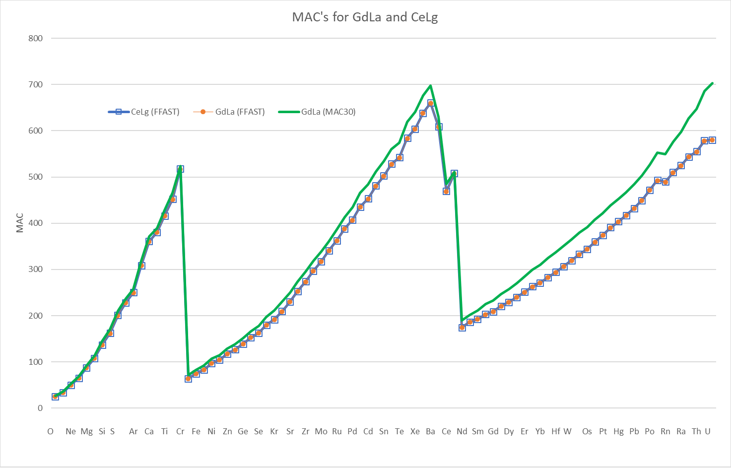

I would like to ask you if you could be so kind as to make one thing possible in CALCZAF. There are several MAC datasets, but only one of them (FFAST) having values for additional lines, such as e.g. CeLg. The user is allowed to edit MAC's in any of the datasets. I can insert MAC's for the CeLg into the USER MAC database or even into some other. However, if I want to define a composition and calculate ZAF for the emission, CALCZAF want me to choose FFAST even though there are values for the additional line in the dataset of interest.
Maybe someone wishes to ask, where do the MAC's for the CeLg come from and why do I need such an uncommon calculation.
(1)   We can find in the X-ray database, that energy of CeLg is very similar to that of GdLa (6.0511 vs 6.0561 keV). If we plot MAC's (from FFAST) for both with increasing atomic number of the absorber, we can see they show (almost) identical values. (Here, I want to note, that some pairs with similar energies other than GdLa+CeLg may differ in the position of an absorption edge = the overlap may be disrupted at the edge). Plot of GdLa MAC's from MAC30 database shows some shift towards higher values. So, I adjusted the CeLg-pattern from the FFAST database to be compatible with GdLa from MAC30 database as an approximation, because I do not want to use FFAST for my calculations.
(2)   Why to do this? I have been calculating some interference corrections and testing some situations, where spectral overlaps are relatively strong. In some cases the interference standard (with high concentration of the interfering element) can give apparent concentration of e.g. 7 wt.% of the interfered element. So, for the calculation of ZAF in the interference standard, I guess, there could be significant matrix effect of the interfered element although its concentration in the matrix is zero. So, my idea was to calculate the ZAF directly for the (additional), interfering line rather than for the interfered line in such situations. So that the effect of interference standard matrix is not affected by the elevated total and the fake 7 wt.% of the interfered element.
So please, is it somehow possible to enable CALCZAF to run calculations with the additional lines + other than FFAST database selected?
Thank you very much. Best regards, Jakub Haifler

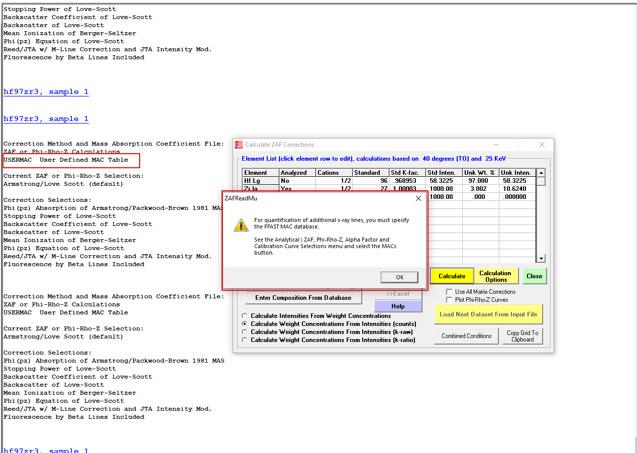

Quote from: JakubHaifler on June 24, 2019, 06:24:33 AM
Hi Jakub,
I am sorry for the warning message you are receiving.  When Philipp Poeml and I added MACs for the "additional lines" (e.g., Ce Lg, etc.) to the FFAST table, I was concerned that people would try to utilize the other (historical) MAC tables for these lines. But of course you are correct. If someone is creating their own table of MACs using the USERMAC table, they should be able to.
I am at the QMA 2019 meeting this week, but if you can wait until next week I will change the code to allow one to utilize the USERMAC table for these "additional lines".
Hi Jakub,
I was just talking to Philipp Poeml about your interference calculation efforts. One thing Philipp mentioned was that we should add the Penelope and Pouchou MAC tables to CalcZAF. So we will work on doing that as soon as we get home from the conference.
Hi Jakub,
I made some changes to the code in CalcZAF that should allow you to utilize the "additional" x-ray lines, e.g., Ce Lg in the USERMAC MAC data file for your calculations.
Be aware that MACs for the traditional x-ray lines (Ka, Kb, La, Lb, Ma, Mb) are stored in the USERMAC.DAT file (imported from the USERMAC.TXT file), while MACs for the "additional" x-ray lines are stored in the USERMAC2.DAT files (imported from the USERMAC2.TXT file).
I tested it a bit and it seems to work, but please let me know what you find.  You can update using the Help | Update CalcZAF menu.
