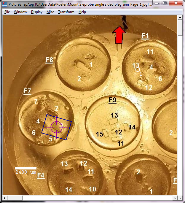

However Probeman then realized that the stage limits (yellow lines) were not displaying correctly on the rotated sample as seen here:

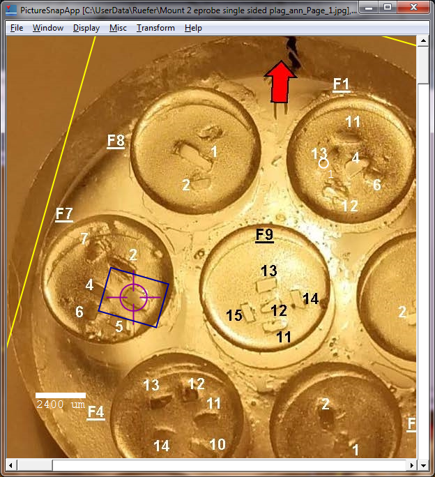

So today, Donovan spent the morning at Probe Software re-writing the stage limits display code to accurately display the stage limits even when the sample is rotated as seen here:
Note that the stage limits (yellow) now agrees with the FOV (dark blue).  Please update to v. 1.7.7 of PictureSnapApp to get this new feature.
