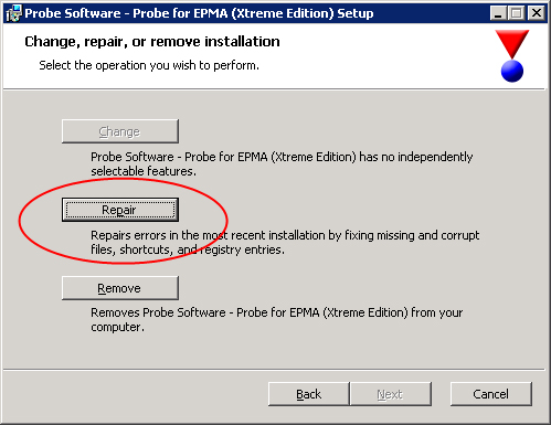

If you suspect that the CalcZAF.exe and Standard.exe files were not updated properly from the normal update, you will want to re-run the ProbeForEPMA.msi file (no need to download it again), by simply locating it in the Probe for EPMA application folder and double-clicking it. You will eventually see this screen:
Just click the Repair button and the CalcZAF and Standard exe files will be properly updated this time.
