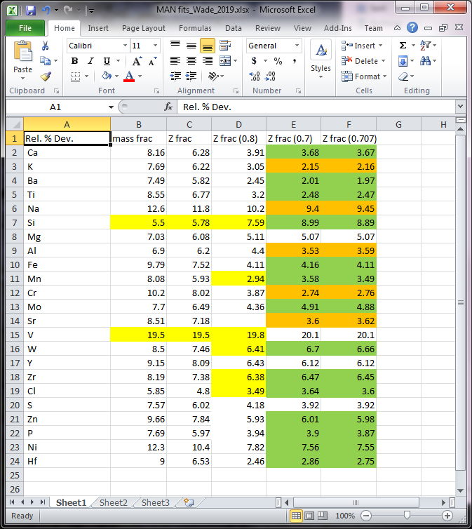

I also include this screen shot of an Excel spreadsheet with a summary of the Z exponents for Ben Wade's MAN fits to continuum data:
If you're at M&M and see me, please feel free to ask me what the color coding represents, though you may indeed figure it out before I explain.

The exponent is simply tuned to the data (much like the PAP models themselves!) to provide the best fit. As Aurelien Moy points out in his recent paper, the best fit exponent seems vary slightly with x-ray energy.
As to why a fractional exponent, well it seems to be related to a geometric charge screening effect of the distribution of coulombic charge, e.g., Yukawa Potential. This would imply a Z^0.66 response. We are currently working on this idea...
In the case for a fractional Z exponent for backscatter production, we explain in some of our publications that the fractional exponent seems to relate to the decrease in backscatter production at higher average Z, due to well known screening of the nuclear charge by the increase in inner orbital electrons. Essentially another geometric screening effect.
