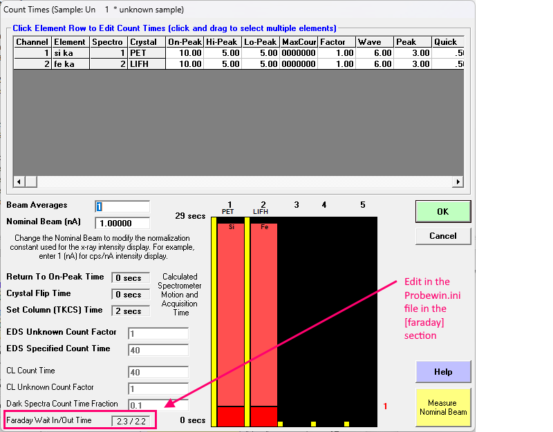

Just a reminder to people that if you start seeing your beam current measurements looking a little unstable there could be several reasons:
1. The faraday cup mechanism could be sticky or dirty. This your service engineer will need to fix.
2. The settling time of the picoammeter is longer than the "faraday wait in time" parameter. You can adjust this in the [faraday] section of your probewin.ini file.
Our experience is that each new model of the JEOL EPMA instrument has a slower picoammeter than requires more "settling time". Recent JEOL instruments (8230/8530/iSP100/iHP200F) can require up to 3 seconds or more of faraday "wait time" for accurate beam readings.
Note that the FaradayWaitInTime refers to the beam current measurement, while the FaradayWaitOutTime refers to the absorbed current measurement.
You can observe your current "wait time" values in the Count Times dialog:
