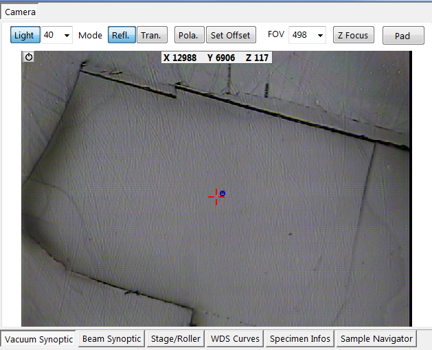

For our standby procedure we do not deflect beam, but "park" the beam on the 0,0,0 position of the stage, thus beam is not hitting neither Faraday plate, neither the tube wall - with such procedure We got so clean column that after 1.5 year of our previous tip life, when service was exchanging the tip and opening the column - engineer was highly surprised how clean the tube was (previously, it was dirty like hell, when beam was been left deflected). Beam is also deflected by closing EP6 automatically. (and we were closing EP6 as TaskEnd previously, now we leave it open)
