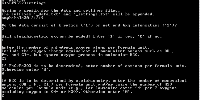

First I run a program to help me construct a settings file (here for amphibole analyses) that contains information on the X-ray line used, accelerating potential, count rates on the standards, and all other information required to process the X-ray data.  In order to do this, it first reads some files output by the JEOL PC-EPMA software.  I specify information on the formula unit as follows:

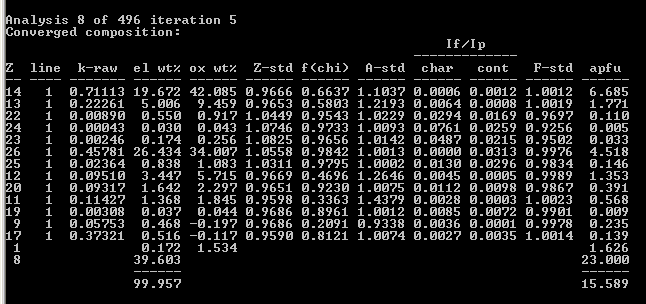

When I run my program to process the raw X-ray data, here is the result:
The elements are specified by atomic number on the left-hand side.  Note that I never had to specify a ratio of hydrogen to oxygen -- it was specified automatically in accordance with the chosen formula unit after subtraction of F- and Cl-.  For an amphibole, as long as you have reason to believe that no significant O2- substitutes for OH- on the monvalent anion site, then it's reasonable to assume that the molar OH- content of the amphibole is equal to 2 - nF- - nCl- after normalization to 23 anhydrous oxygens (or total anion charge = 46).  This should be true regardless of any other assumptions that have been made about the formula unit regarding, for instance, distribtion of Na across the M4 and A sites and its effect on Fe2O3/FeO (which would in turn affect the matrix correction factors for F and Cl, among other things).  In this case, the amphibole comes from a graphite-bearing metamorphic rock and likely grew at temperature in the vicinity of 800°C, and so Fe2O3 content is likely very low.
Also, note that the apfu sum of atomic numbers 1, 9, and 17 is exactly two.
Lastly, shame on you people who don't analyze for halogens in amphiboles!  Here's what another 51-year-old Brian has to say about it:  https://www.youtube.com/watch?v=n4bply6Ibqw

I sat down with the goal of extracting the code that I use to determine wt% H2O after considering substitution of F- and Cl- for OH-.  What I discovered instead is that my code, as it exists, could be organized much better and could also be generalized a bit.  So it's clear to me that I need to rewrite some of my code before presenting it to anyone.  I'm going to do this over the next several weeks as I get the chance.
Let me just restate my purpose as clearly as possible first:
The goal is to determine wt% H2O and/or wt% oxides of other light, unmeasured elements and/or Fe2O3/FeO using just a few pieces of information on the formula unit.  The calculations are performed during each iteration of the recursive algorithm used to determine the matrix correction factors such that the matrix corrections take into account the unmeasured elements/oxides and/or added oxygen and, if applicable, the mass of oxygen replaced by halogens.
For the general case, cation site assignments are ignored.  The following information is required from the user:
1.  Total number of anhydrous oxygens per formula unit (counting each monovalent ion as being equal to ½ O2- and ignoring molecular H2O).
2.  Number of monovalent anions (OH-, F-, Cl-) per formula unit, if applicable.
3.  Additional oxide mass fractions to be determined by specifying a number of cations per formula unit (if applicable):  H2O not accounted for in (1), Li2O, BeO, B2O3, CO2, N2O5.  More than one may be chosen.
4.  Total number of cations per formula unit (only necessary for determination of Fe2O3/FeO)
5.  If a measured element substitutes for an element in the oxides listed in (3), then the user may specify the substituting measured element and the light, unmeasured element for which it substitutes.  For the general case, it may be necessary to specify that all of the given measured element substitutes for just one of the light elements (I need to think about this some more).
In cases in which it is appropriate, the general treatment above can be replaced by one in which cations are restricted to specific sites.  The goals are the same as for the general case.  For an amphibole, for instance, a formula unit can be calculated based on the following assumptions, each of which must be tested to determine whether it violates restrictions on site occupancies:

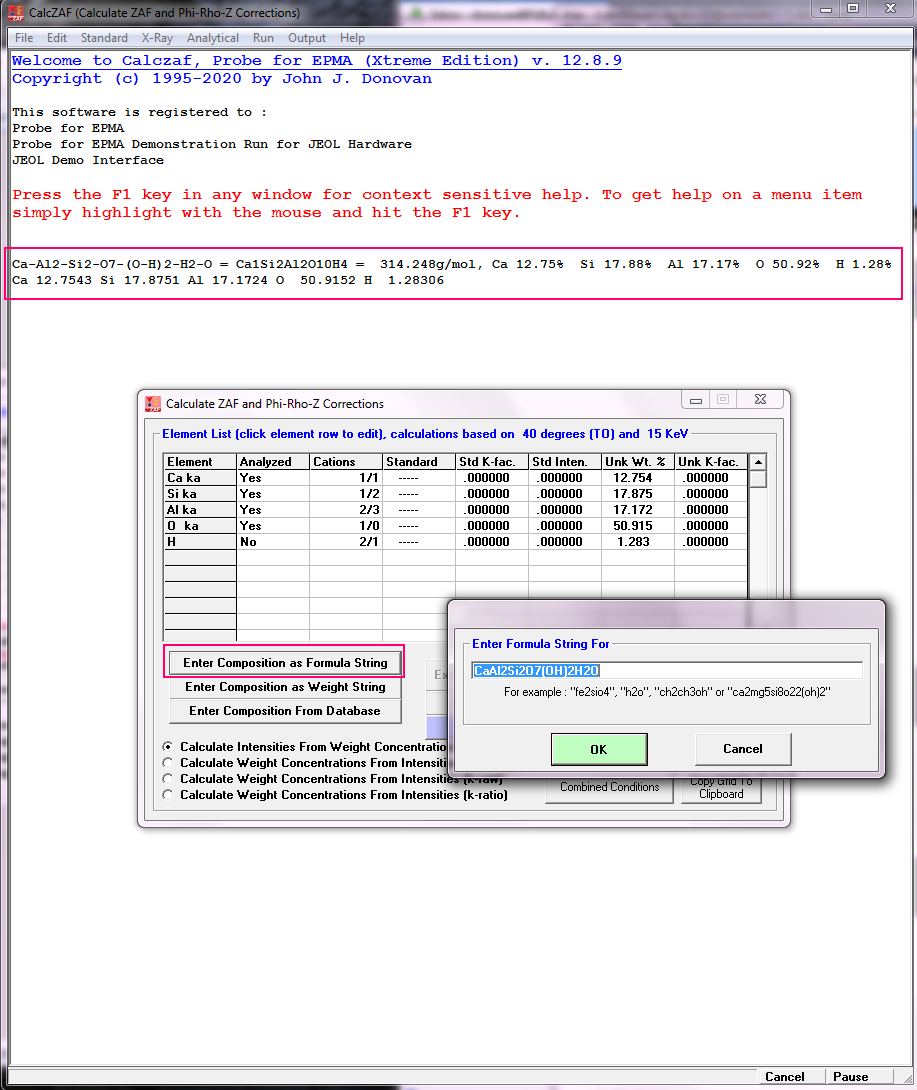

Ha!  Exactly yes. That is why I suggested just using a mineral formula.
To help with this effort, here's some code I found (and modified) somewhere many years ago (can't remember where now), that takes a formula string and calculates the number of atoms of each element:

It's pretty sophisticated in that it can handle subscripts and parentheses. It even can distinguish things like Co (cobalt) and CO (carbon monoxide) as long as you use capitalization properly.
You can play around with it using the formula entry methods in the main window of CalcZAF.  E.g.,:
