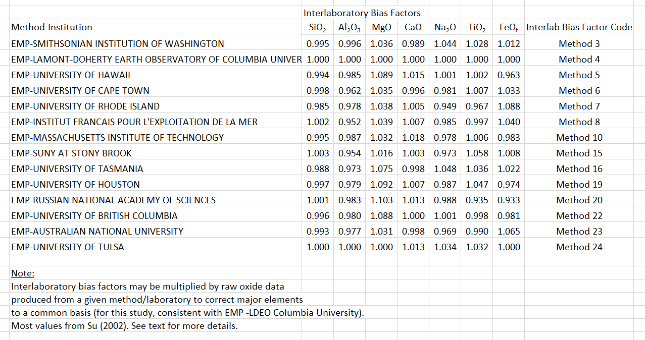

Very interesting discussion and the problem of interlaboratory bias, either stemming from unreliable standards and/or the variability in -let's call it - analytical 'rigor" between labs has been a longtime problem.
The problem with MIT data in particular has been occasionally mentioned before. I think I saw it first in a 1996 paper by Yang et al. that states:  "An interlaboratory comparison has been made (Reynolds 1995) including MIT, the Smithsonian Institution in Washington, Lamont Doherty and University of Hawaii. It is the practice in our laboratory to correct microprobe data obtained elsewhere to an MIT reference before making thermobarometric or modeling analyses (see Table 1). Although Grove et al. (1992) neglected to discuss this issue, the Smithsonian data discussed in that paper was corrected before plotting and estimation of crystallization pressure. Failure to do so can result in significant errors, and is most commonly evident as a discrepancy in the pressures estimated from the different equations."
I attached the paper.
I think there are also some small remarks in earlier papers by the Langmuir group at Harvard. We ran into this problem as well for a study from one of my MSc students (Voigt et al., 2017, Lithos) and had to correct the literature data to be able to compare various geobarometers.
I would also point you to the large study by Allison Gale (Gale et al.,  2013 The mean composition of ocean ridge basalts - Gale - 2013 - Geochemistry, Geophysics, Geosystems - Wiley Online Library) that touches upon interlaboratory bias if you haven't seen it yet (see attached table).
Here is the table of interlaboratory bias factors, showing only the values for EPMA labs.

Quote from: Anette von der Handt on October 20, 2021, 08:16:11 PM
I note that MIT had the 2nd highest Al, the highest Ca and the 4th lowest Na values. So in this table 1.000 indicates no bias from the average of reported results or from the "accepted" values?

Quote from: Anette von der Handt on October 20, 2021, 08:10:20 PM
At least one issue with the MIT EPMA lab is their "procedure" for standardization. Apparently they:
1. Acquire a single point on their primary standard (already I'm starting to worry!).
2. Acquire a single point on their secondary standard (now I'm really worried!)
3. Analyze that single point on their secondary standard, and if they do not obtain the expected composition of the secondary standard...
4. They then edit the primary standard intensity raw data until they do (OK, now the alarm bells in my head are ringing!).
Yes, you read that correctly: they *edit* the raw data intensity of the primary standard...
I'm sure everyone can understand why this "procedure" might be problematic. First we need more than a single point per sampling, to obtain an average and observe the variance. A single point has a zero variance and we won't know if that single point is simply an outlier due to some instrumental or sampling effects.
Second, no one should be editing their standard (or unknown for that matter) raw intensities to obtain an "expected" result! We should modify our models to fit our data, not modify our data to fit our models!   >:(
Third, by "nulling out" the check on accuracy by using a secondary standard, they are now essentially removing their ability to ascertain their accuracy levels. Why even bother using a primary standard?
Consider the following: let's assume they are lucky and the single point measurement of their primary intensity is good, now what if the secondary standard (kakanui augite?) is somewhat inhomogeneous? Or that single grain does not represent the wet chemistry as reported by Gene Jarosewich?  By editing the primary standard intensities, they are normalizing the calibration to that single point on that single grain, whether or not it's representative of the average wet chemistry.

The ultimate detection limit for EPMA has got to be around ~1 to 2 PPM (or worse).
For example when we did our trace element study (Donovan et al., 2011, Amer. Min.) we tuned up 5 spectrometers for an aggregate Ti analysis and got a t-test detection limit of around 2 to 3 PPM at high beam currents and long counting times.
And Ti (Ka) is pretty easy compared to many emitters and SiO2 is a relatively low Z matrix, so anything else under 2 PPM is probably going to essentially be a big fat zero (blank) for EPMA.
If only someone somewhere could grow high purity synthetic (end member) nepheline (NaAlSiO4) and/or leucite  (KAlSi2O6) synthetic crystals!  The web seems to disagree on the exact formulas, so I guess I should ask, are synthetic end members of Na and K aluminum silicates possible?
