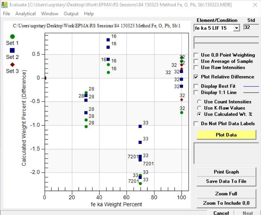

1. I did not find some impurities in Fe2O3 Taylor with EDS spectrometer (15KeV, 20nA, 10 um, 15-20 min). Energy limit is 15 keV - see photos of screen.
2. I used Evaluate application for evaluate 4 standards with Fe we have in the Taylor block: FeCuS2(28), FeS(16), Fe2O3(33), Fe(32). Sample 7201 - Fe2O3
synthesized from Fe metal (1200C, CO2 atmosphere, 4 hours) in our lab. See addition picture.

So both your Fe2O3 standards compare low in Fe compared to your Fe metal and also your Fe sulfide.  Maybe they have excess H2O or oxygen?
What are the compositions provided by the commercial vendors?
Rom
Yes, the Evaluate is easy and useful application - thank you.
All these standards except 7201-Fe2O3 are in the Taylor block which was supply by commercial vendor.
I thought about O2 or H2O in Fe2O3 Taylor - it is possible but not 2%wt.
I can add to the Evaluate diagram results for extra one Fe2O3 Standard from SPI block which was supply by commercial vendor too.
Also we can see the same composition in synthetic fresh sample 7201. I can't image that this sample obtained in the furnace at the exactly known PO2 contains less then 69.5-70wt% of Fe.

What I do find interesting is that in your Evaluate screen capture here:
Quote2. I used Evaluate application for evaluate 4 standards with Fe we have in the Taylor block: FeCuS2(28), FeS(16), Fe2O3(33), Fe(32). Sample 7201 - Fe2O3
I note that both your sulfide standards agree within 0.5% absolute with your Fe standard. This suggests to me that you might be doing things mostly correct, but that it's the Fe2O3 standards that are the problem.

   356   7.579    .057    .000  21.199    .000  11.657  10.899   4.906  43.597  99.894
AVER:    7.534    .054    .000  21.199    .000  11.657  10.899   4.906  43.597  99.846
SDEV:     .035    .018    .000    .000    .000    .000    .000    .000    .000    .045
SERR:     .016    .008    .000    .000    .000    .000    .000    .000    .000
%RSD:      .46   33.33     .00     .00     .00     .00     .00     .00     .00
PUBL:    7.742    .077    n.a.  21.199    n.a.  11.657  10.899   4.906  43.597 100.077
%VAR:    -2.69  -30.21     ---     .00     ---     .00     .00     .00     .00
DIFF:    -.208   -.023     ---    .000     ---    .000    .000    .000    .000
STDS:      526     525     ---     ---     ---     ---     ---     ---     ---
Again about 2.5% relative low for Fe.  I did not have a Mn sulfide standard, but running Mn metal against MnO, I see a similar low accuracy:

About a 3.5% relative error. And here for Mn2SiO4 synthetic olivine:
St  275 Set   2 Mn2SiO4 (manganese olivine) synthetic, Results in Elemental Weight Percents
ELEM:       Fe      Mn      Cr      Si       S       O
TYPE:     ANAL    ANAL    SPEC    SPEC    SPEC    SPEC
BGDS:      LIN     LIN
TIME:    40.00   40.00     ---     ---     ---     ---
BEAM:    29.89   29.89     ---     ---     ---     ---
ELEM:       Fe      Mn      Cr      Si       S       O   SUM
   362    .019  52.526    .000  13.907    .000  31.688  98.140
   363    .013  52.363    .000  13.907    .000  31.688  97.971
   364    .008  52.843    .000  13.907    .000  31.688  98.446
   365    .013  52.404    .000  13.907    .000  31.688  98.013
   366    .016  52.316    .000  13.907    .000  31.688  97.927
AVER:     .014  52.490    .000  13.907    .000  31.688  98.099
SDEV:     .004    .212    .000    .000    .000    .000    .209
SERR:     .002    .095    .000    .000    .000    .000
%RSD:    28.58     .40     .00     .00     .00     .00
PUBL:     .000  54.406    .000  13.907    .000  31.688 100.001
%VAR:      .00   -3.52     .00     .00     .00     .00
DIFF:     .000  -1.916    .000    .000    .000    .000
Again about 3.5% relative accuracy.  So not good for major element accuracy!   >:(
