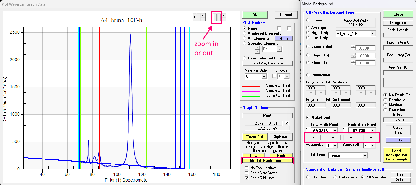

I've recently modified the peak integration code in the Plot! window Model Backgrounds dialog to only integrate the peak area between the high and low off-peak background positions.
This is consistent with the integrated intensity scan acquisition option seen here in the Elements/Cations dialog:
By the way, before I go on further with the APFs, this integrated intensity acquisition option in PFE is quite nice because at low intensities the scan step size is larger, and as the peak intensity increases, the step size decreases automatically, to allow more time to be spent on the peak itself as opposed to the background intensities.
To see the acquired integrated intensity acquisitions just click the Run | Display Integrated Intensities menu and you will see this:
If we now zoom in on the side of the peak we can see this "variable" integrated intensity acquisition step size as seen here:

So, here is an example of a linear fit to a wavescan on Al2O3 with O ka:
The Model background dialog looked like this:
Note the not quite perfect fit to the background and to get the most accurate integrated area under the peak we'll want to fit better. Now here is the same data but the background is fit to an exponential fit:
and here is what the Model backgrounds dialog looked like:
Note the smaller fitting problem with the exponential fit.  This modified code will produce improved integrated area intensity calculations for the creation of your own specified (or binary compound) area peak factors.

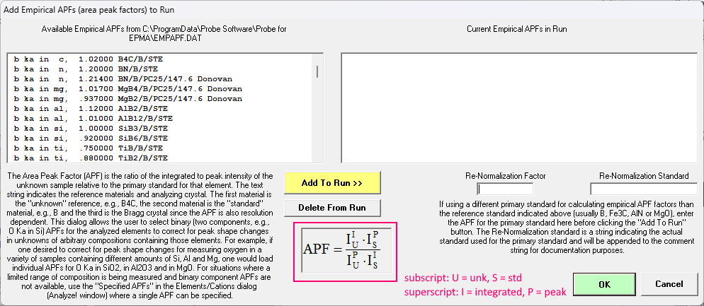

Once we have the peak and integrated intensities for our standard material and our secondary std or unknown, we multiply the peak:integrated intensity ratios as described here in the reference manual:
http://probesoftware.com/download/PROBEWIN.pdf#page=321
and obtain the desired light element area peak factor (APF). This resulting APF factor could be a single use "specified" APF for use in the Elements/Cations dialog as seen here:
where the APF was calculated by utilzing a "Standard" wavescan on the standard for the emitting element and a "Unknown" wavescan on the actual unknown material of interest.
Or these peak to integrated intensity ratios could be utilized for calculating compound binary APFs where the "Standard" wavescan is again on the primary standard for the light element emission line and the "Unknown" wavescan is on a secondary (binary composition) standard containing the light element emitting line of interest and one of the matrix elements bonded to the emitting element as shown in this dialog accessed from the Run | Empirical APFs menu as seen here:
The Model backgrounds dialog provides both ratios for your convenience. The benefit of the binary compound APFs is that they can be applied, to arbitrary compositions iteratively in the matrix correction, weighted based on the concentrations of each absorber (bonding) element to the light element emission line of interest as seen here:
The only "catch" for using binary compound APfs is that you must edit the EmpAPF.dat file as described in the manual so the user can select the necessary "empirical" APFs from the app for the situation at hand.
Why? Because the specific binary APFs selected will depend on the actual spectrometer crystal utilized for the wavescans and analysis (they must be the same and for JEOL users the spectrometer focal circle should also be the same), the compound bonding valance and lastly the crystal coordination for ultimate accuracy.  The following is a list of measured APFs from Bastin, Pouchou and myself that are distributed with CalcZAF and Probe for EPMA:

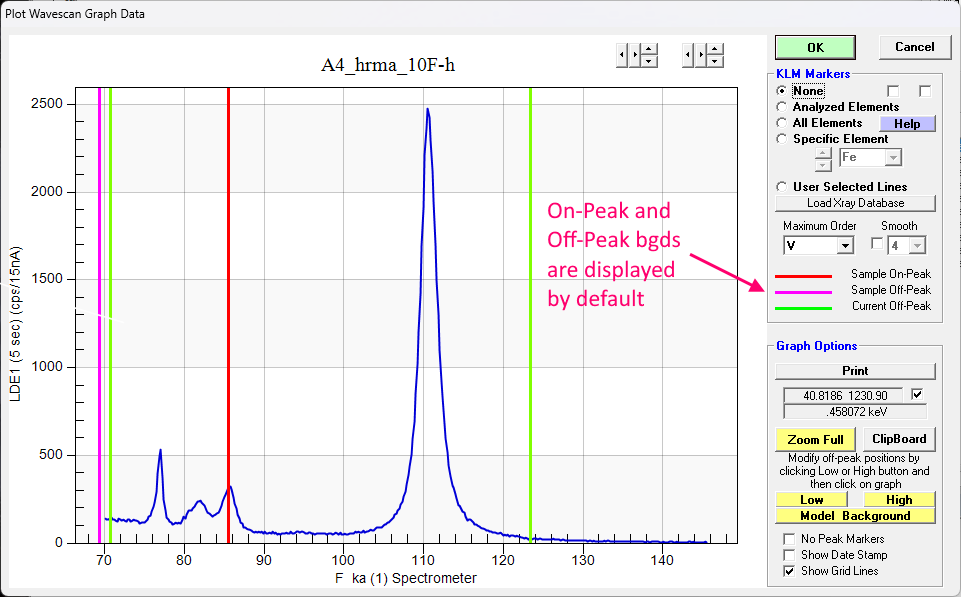

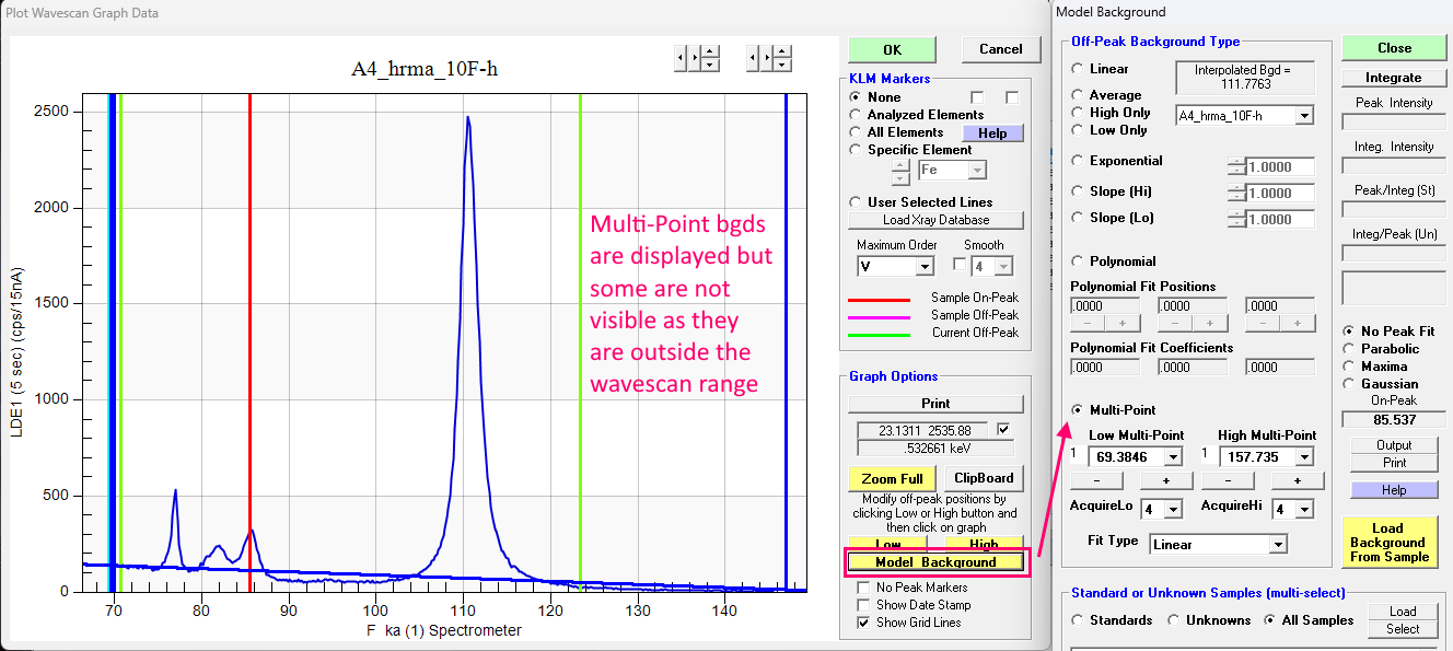

My very general (each case is individual) rules for THIS task:
-BG positions should be as close to peak position as it possible;
-shift BG position in +/-0.1 mm (voluntarist approach) shouldn't be a cause of changing peak intensity (peak-BG) more then 0.1% rel (voluntarist approach).
-BG model - linear (BG level of exponential model depends of BG range and distances BG low/high from peak position).
-one of handy marker in PFE - Gaussian line in Plot!/Model BG list. We can use points of crossing the Gaussian line with WS line for choosing BG positions.

The key issue with these APF wavescans is that the backgrounds are properly modeled, but as some of you may know, the background positions for wavescan samples may be edited after the intensity data is acquired!  This is because we are simply interpolating the background intensities based on the wavescan intensities themselves.
What Scott discovered was, that although we allow one to adjust the wavescan backgrounds from the Plot! window after the wavescan is acquired, in cases where the background positions were declared outside the wavscan range (maybe because they had not been specified previously, or in Scott's case, he had specified them, but due to a now fixed software bug, the use of this mode did not properly transfer the MPB background positions from the last unknown, when the Use Last Unknown as Wavescan Setup flag was checked in the Acquisition Options dialog from the Acquire! window, whew!), the use of an exponential fit would sometimes cause a negative intensity which would cause an error message to pop up.  Basically this pop up error message made it difficult to adjust the MPB positions in the wavescan Plot! window.  Anyway, all fixed now.
So here is what one initially sees when plotting a F Ka wavescan from the Plot! window:
Then we click the Model backgrounds button and plot our MPB positions (which Scott had not yet adjusted):
Now we start adjusting our MPB positions using the + and - buttons (hold the <alt> key to perform fine adjustments):
And when completed we might see something like this:
