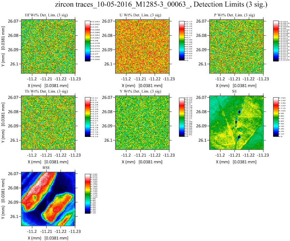

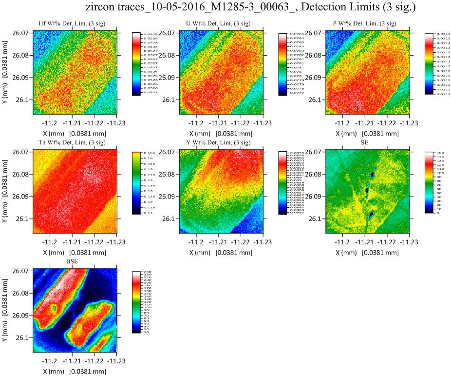

Figure 13 in the MAN paper shows the detection limit improvement for MAN backgrounds on a homogeneous synthetic zircon, but a better example might have been using a natural zircon as seen in these images below.  As with figure 13, off-peak maps were acquired for the zircon, and utilized in the off-peak quantification, but not utilized in the MAN quantification (normally resulting in an acquisition time half that for off-peak quantification). Here are the off-peak per pixel detection limits:
And here are the MAN per pixel detection limits:
If you can read the Z labels (just click on the images to make them full size), you can see the off-peak detection limit statistics are significantly worse than the MAN statistics, and the MAN detection limits actually show slightly higher detection limits as the concentration of Hf (a high Z element) increases in the core of the zircon. This is as mentioned above due to the slope of the MAN curve (usually) increasing with increasing average atomic number. Here ZrSiO4 was specified by difference from 100%, so the MAN background variance was very close to zero.

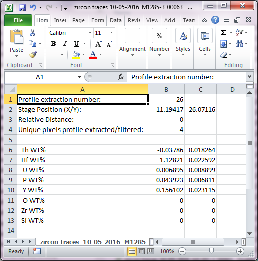

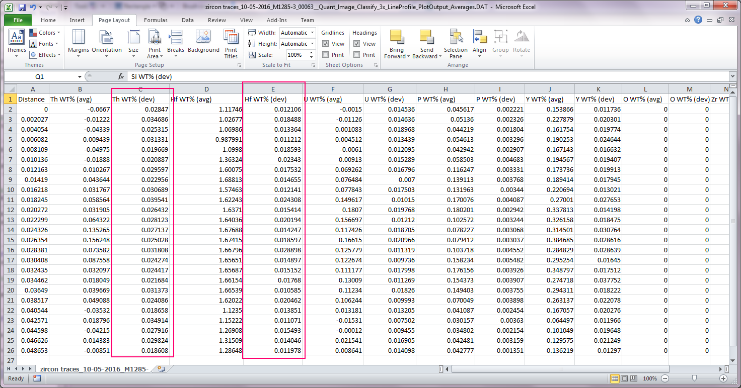

These line profiles with statistics can also (sort of) be accomplished using the line profile feature in CalcImage, if one selects the standard error output option, and selects the export to file checkbox as shown here:
But it outputs a separate file for each area, which looks like this in Excel:
This all reminds me of this conversation from three years ago:
https://smf.probesoftware.com/index.php?topic=1144.msg8000#msg8000

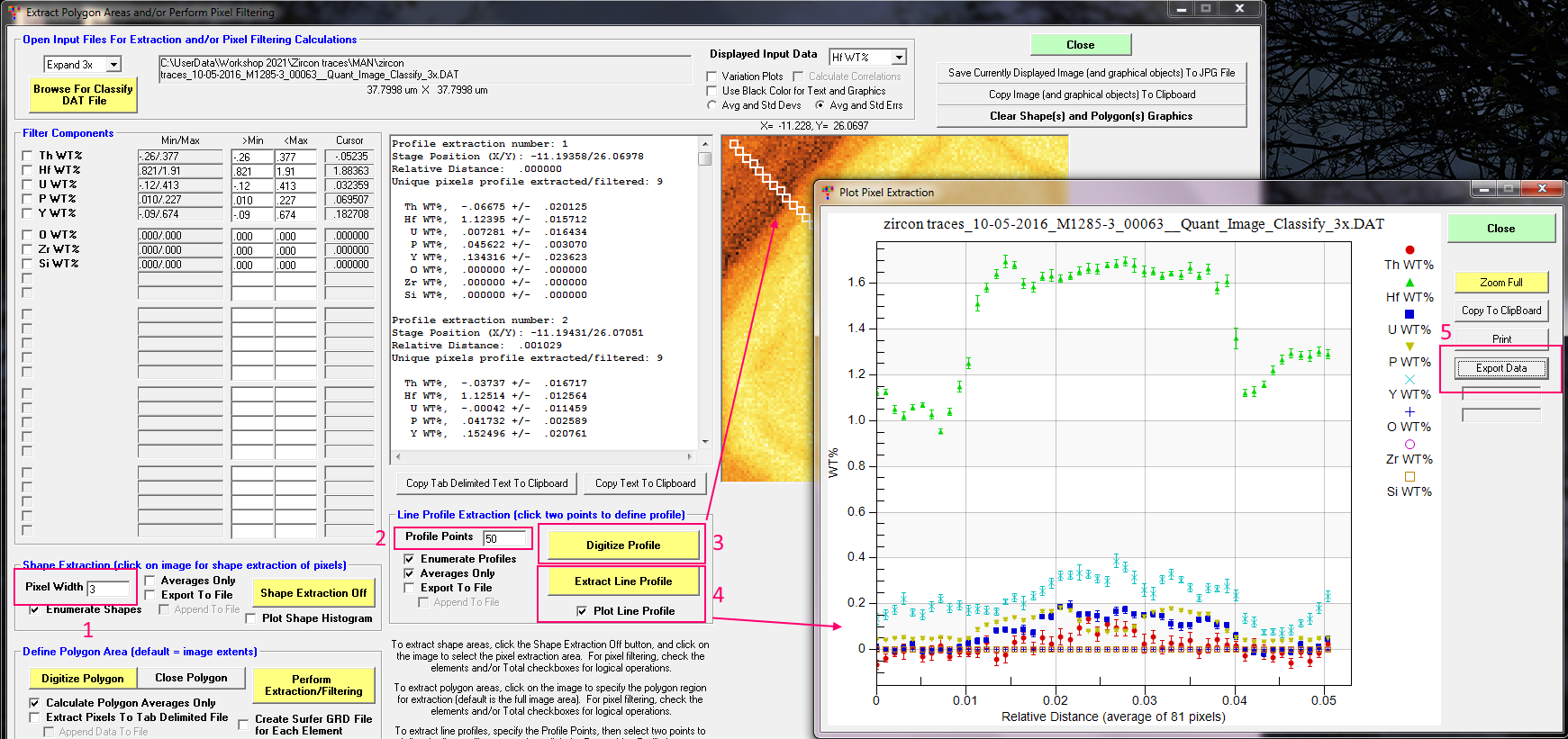

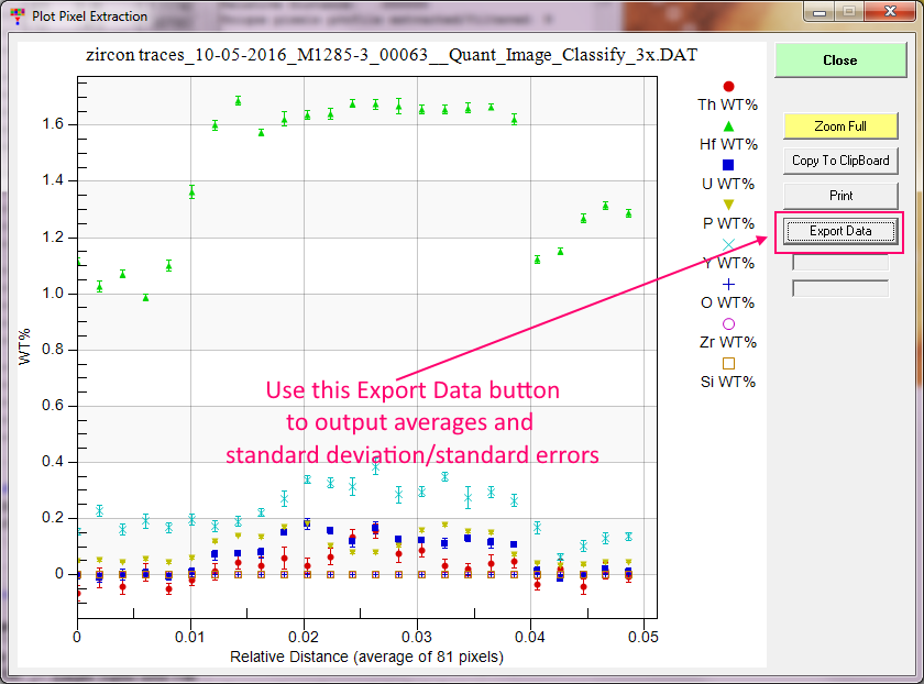

In the case of these traces in zircon, it would look like this:
And of course now, I realize that one can then export the data from this plot using the Export Data button...
OK, but I just looked at this output file and the concentrations are there but the deviations are all zero, so let me take a look and see if I can fix that today.
Ha!   I thought we had a bug but I was wrong!     8)
I had just quickly glanced at the last few columns of data which was for the O, Si and Zr columns, but since I specified ZrSiO4 by difference, and didn't map them, those columns *would* be zero!
Doh!
In fact, the averages and standard deviations or standard errors are correctly exported as shown here:
So if one would like to get a wide "strip" of averages for trace elements from a quant map simply use the Export Data button as seen here:
That will create a tab delimited ASCII (text) file which can be easily opened in Excel or any graphing program.
The size of the extraction square can be adjusted to get a nice fit of averaging versus spatial resolution as seen here:
Remember, these calculated error bars are 1 sigma statistics, so you might want to multiply them by 3 to get 99% statistics...

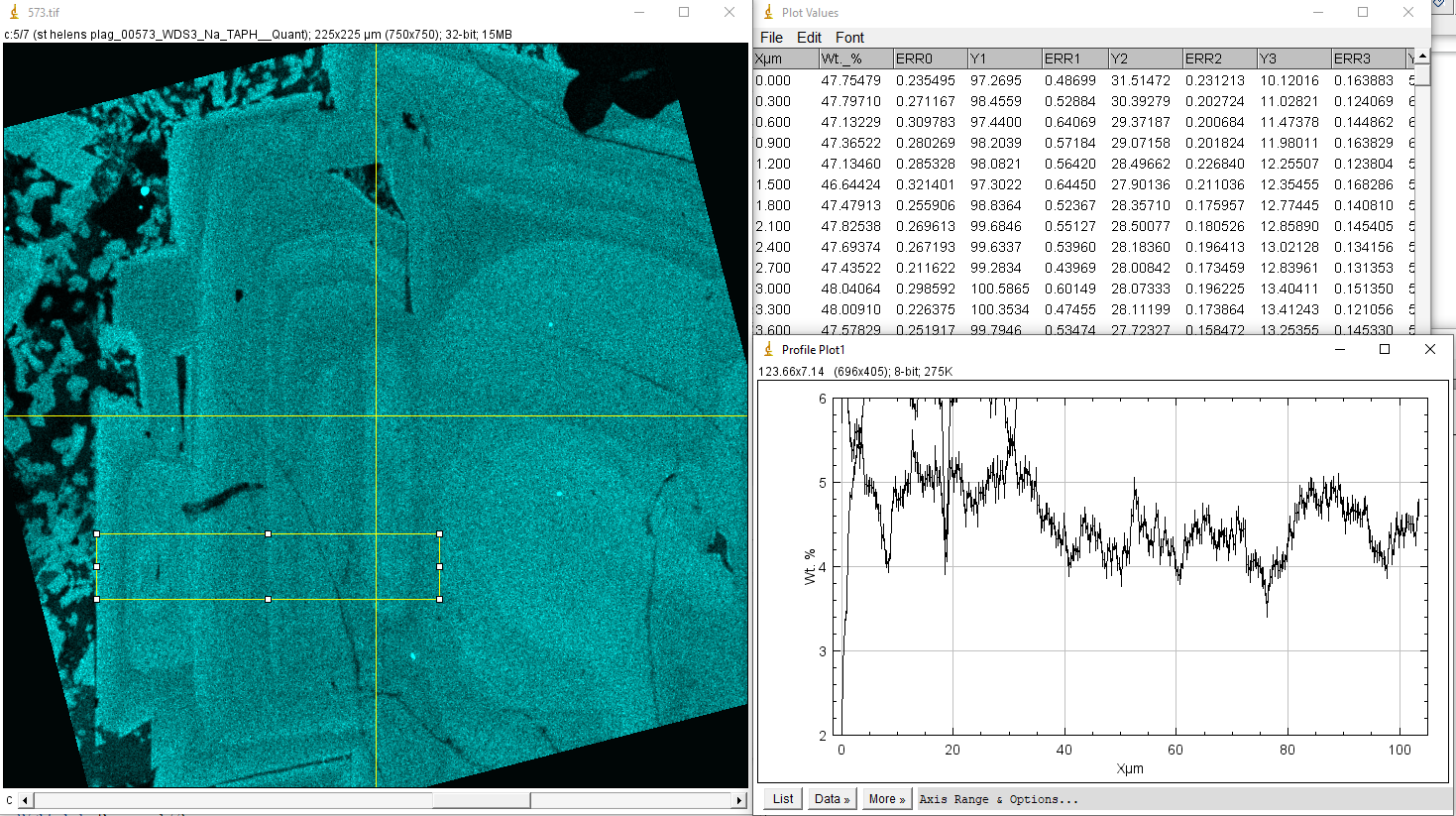

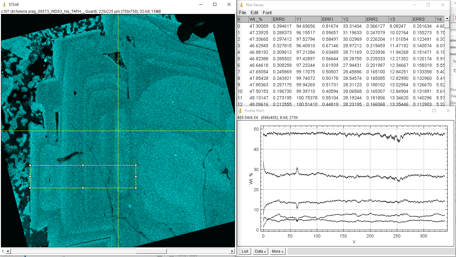

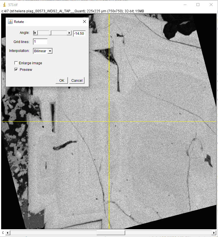

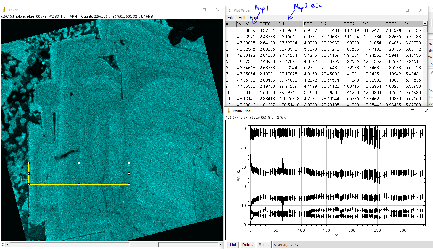

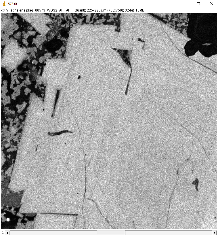

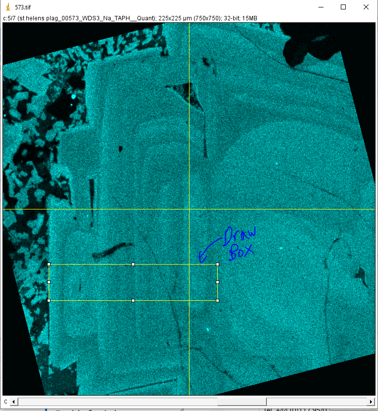

So here's an example. Data can be filtered in calcimage first to remove holes etc.
1. Create stack of multiple channels - as posted elsewhere https://smf.probesoftware.com/index.php?topic=799.msg9557#msg9557.
2. Rotate stack so wide line is horizontal.
3. Draw profile box
4. Run macro to plot profile with error bars of standard deviation
5. Run macro to plot profile with error bars of standard error
Left to right is plot. Scale currently in pixels not microns  ???

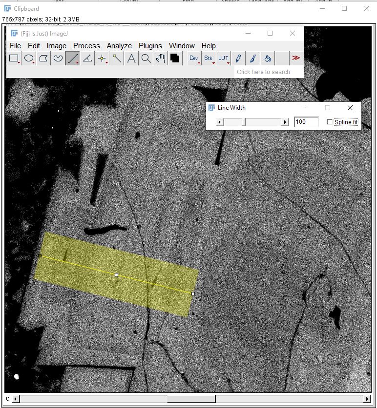

Rather than rotating the image and drawing a box, could you use the straight line tool to draw a profile line, then double click on the straight line tool icon and specify the line width?
I don't know if drawing the box was a specific requirement of the macro, but could save you some time being able to arbitrarily draw lines rather than rotating the image stack.
