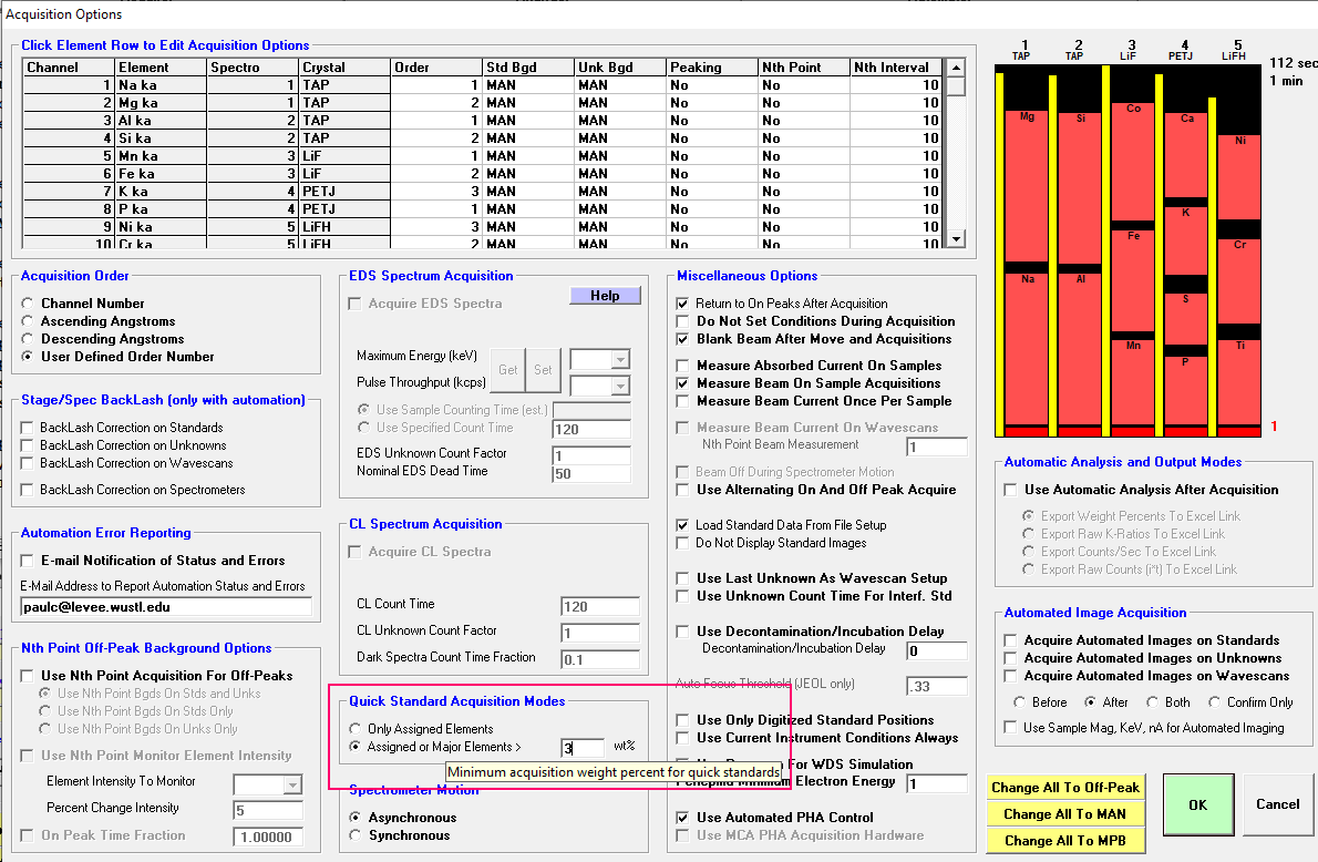

The only options for quick standards:
1. It acquires only the elements that are assigned as primary, interference or MAN standards to that standard and if no elements are assigned to that standard, all the elements are acquired.
or
2. It acquires the above option, *and* any elements above N wt% as shown here:

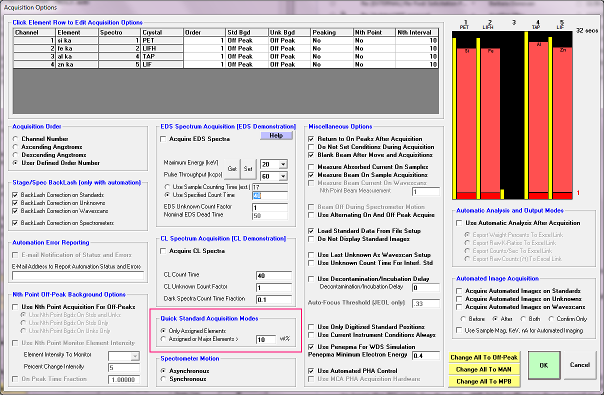

The quick standard concentration limit is based on the elemental weight % in the standard, not the oxide weight %.
Just decrease it to 3 as shown in the image below and it will acquire the Ca also.
