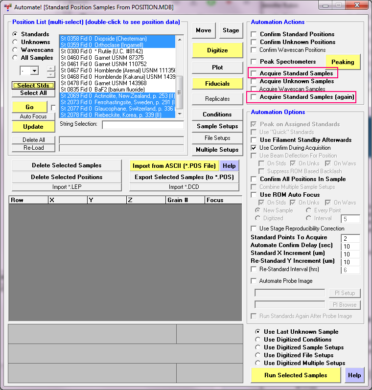

In that case, just set up repeated standardizations from the Automate! window using the "Automation Actions". For example one can select the first Acquire Standard Samples and also a subsequent Acquire Standard Samples (again) as shown here:
Once you have more than one standardization you can list them easily using the List Standard Intensities button from the Analyze! window as seen here:

One can also utilize the "Re-Standard Interval (hrs)" feature (also from the Automate! window), to re-run standards every N hours during a long unknown acquisition.
