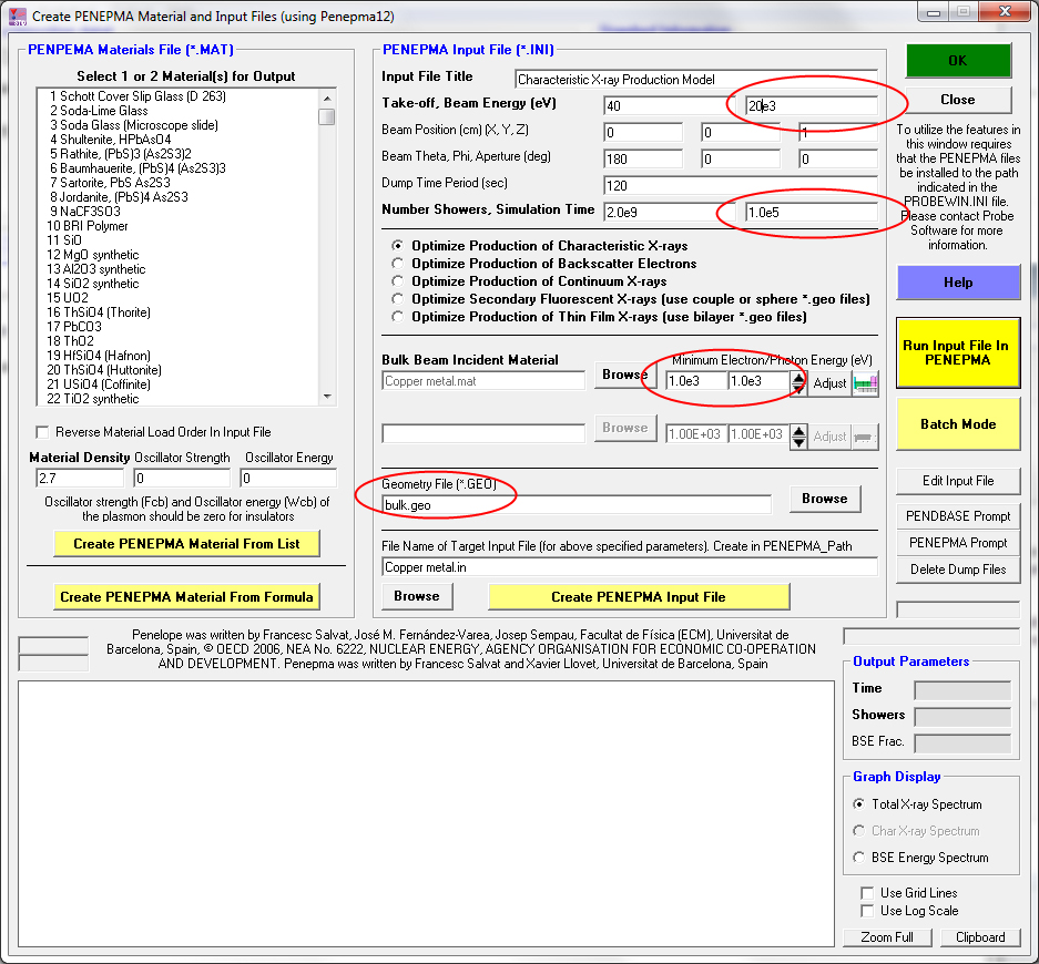

Start by running Standard.exe and clicking on the Analytical | Penepma (Monte-Carlo) Calculations menu. First confirm the electron energy, minimum photon/electron energies, geometric model (for matrix corrections always choose the "bulk.geo" file)  and the calculation time per material as seen here:

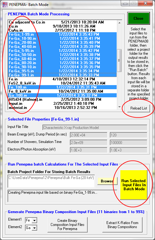

Now click on the Batch Mode button and note the controls and buttons circled in red here:

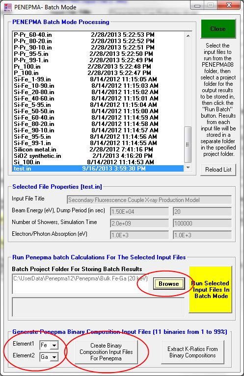

Select your binary elements, Fe and Ga in this case, and a folder so the results will be automatically stored for you. When you are ready click the Create Binary Composition Input Files For Penepma and the program will create the 11 binary compositions and pure element end-members as seen here:
Then click the Run Selected Input Files In batch Mode button (you have to select the input files to run, but they will all have today's date!
After 10 or 15 days or so, your data will all be calculated for the 11 binaries and 2 end-members.

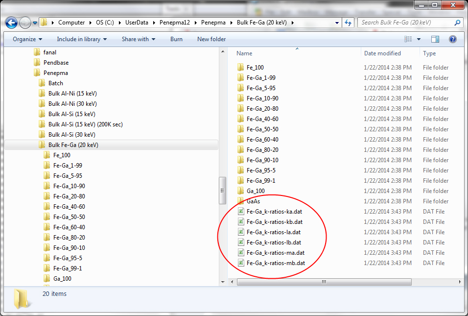

Now you simply click the Extract K-Ratios From Binary Compositions button and the application will automatically extract the intensities for calculating k-ratios for the Ka, Kb, La, Lb, Ma and Mb emission lines. If you need calculations for other emission lines you'll need to open the pe-intens-01.dat file in each folder and find the appropriate intensities manually.

All 11 k-ratio extractions are complete
and the results will be in the root batch folder you specified previously as seen here for example:
The Fe-Ga Ka line results are attached below.
