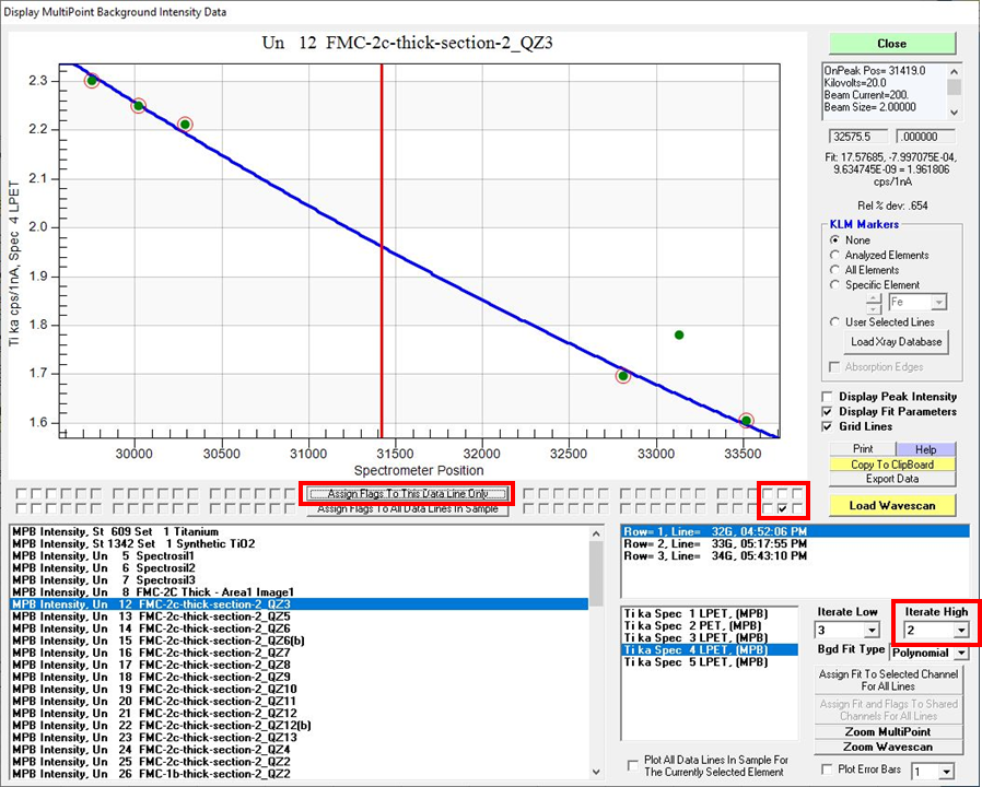

Below is a sample with three lines of data (Lines 32,33,34). I go to Line 32 and for whatever reason one of the Hi background points needs to be kicked out on Sp4, that's fine, so I select Iterate High 2, tick the flag box for that data point, and hit the "Assign Flags To this Data Line Only".

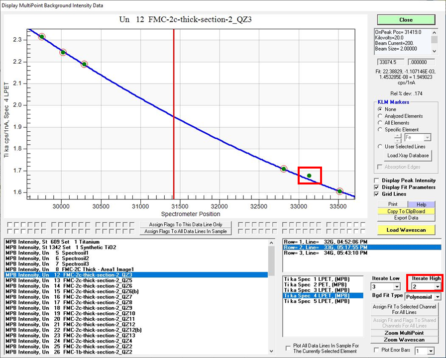

So then I go to the next data line (line 33) and find that strangely for this data line it has changed Iterate High to 2 for SP4 as well without me doing anything

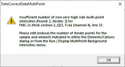

And its the same if I got to line 34 in that sample, it has also changed Iterate High to 2. The problem becomes that if I then try to change Iterate High back to 3 for either lines 33 or 34 I get the following error message:
It's like the "Assign Flags to This Data Line Only" isn't working? Unless I am doing something stupid which is also very possible.
I note that I don't see check boxes for the 2nd point in the screen snap, not sure why you think the flag is set. The warning message is related to how many iterate points you can have.

The MPB dialog currently only allows to set the same number of bkg to iterate for all lines within an unknown and (I think) it has operated like this for a long time. You can set the flags individually for each line within an unknown ("Assign flags to this data line only") but iterate high/low and bkg fit can only be assigned to all lines ("assign fit to selected channel for all lines").
If what you are looking for is to assign different values for the number of iterated bkgs between the different lines of an unknown, I would suggest to use the new function to separate lines in a sample (https://smf.probesoftware.com/index.php?topic=1530.0), at least for now.
