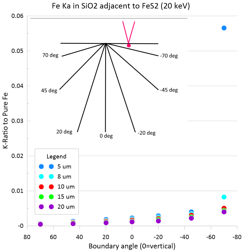

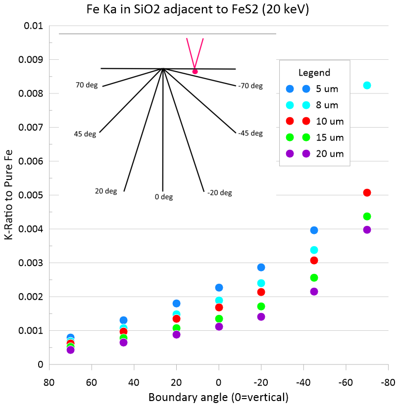

We've recently added a Bragg defocus correction to the secondary boundary fluorescence correction in v. 14.0.2 of Probe for EPMA.
This correction is first of several additional corrections needed to improve the accuracy of the boundary fluorescence correction on actual measurements. That is when measuring an element in a material adjacent to a material containing that element:
https://smf.probesoftware.com/index.php?topic=58.0
For example, measuring Ti Ka in quartz, adjacent to rutile.  Or Ca Ka in olivine adjacent to anorthite..., etc.  That is, don't attempt to derive your thermodynamics from a fluorescence artifact!
The additional corrections mentioned above are necessary, because the degree of secondary fluorescence from a boundary phases depends on several factors in addition to the distance to the boundary. For example:
1. Is the actual phase boundary geometrically similar to the boundary geometry that was utilized in the Monte Carlo modeling?  For example, the PENFLUOR/FANAL modeling is very easy and convenient to use, but it assumes a vertical boundary that is infinitely wide.
2. The PENFLUOR/FANAL modeling also assumes that the boundary is infinitely thick, which may not a good assumption when the sample is a 30 um thick thin section.  In case one is wondering, almost 60% of Fe Ka x-rays are transmitted in SiO2 at a thickness of 30 um:
3. In addition, and the point of this post, in WDS, depending on the orientation of the boundary relative to the spectrometer orientation, one may require a Bragg defocus correction for points further from the boundary. Although, if the boundary fluorescence is very small to begin with, this defocus correction may not be significant.
Ideally we would make our measurements along a line perpendicular to the boundary orientation. In this way, no Bragg defocus will occur, for many millimeters away from the boundary.  This is discussed here:

Here we see a measurement of Fe in quartz adjacent to pyrite. Without a secondary fluorescence correction we get a completely spurious result. With the SF boundary correction we get a better result but slightly over corrected. By including a Bragg defocus correction we see the accuracy improves especially for points further away from the boundary.

On another note, the more serious accuracy issue for the secondary boundary fluorescence correction that we are currently working on is how to deal with non-vertical boundary geometries.  Yes, one could model a non-vertical boundary in PENEPMA for each distance from the phase boundary, but that would be quite time consuming!
We're currently modeling some non-vertical boundary geometries in PENEPMA (thanks to Xavier Llovet for the .geo files), and hope to find a method to apply this to real samples. Here's the issue:
That is, when the phase boundary slopes away from the analysis point, the contribution from secondary boundary fluorescence is less than predicted by the PENFLUOR/FANAL mode, and of course if the boundary slopes towards the analysis point it would underestimate the boundary effect.
Anyway, just something we're working on...

Quote from: John Donovan on February 24, 2025, 11:00:29 AMOn another note, the more serious accuracy issue for the secondary boundary fluorescence correction that we are currently working on is how to deal with non-vertical boundary geometries.  Yes, one could model a non-vertical boundary in PENEPMA for each distance from the phase boundary, but that would be quite time consuming!
The PENEPMA calculations for various sloped boundaries are complete and the data for 5, 8, 10, 15 and 20 microns from the boundary are plotted here for Fe Ka measured in SiO2 adjacent to FeS2 at 20 keV:
Note that the boundary fluorescence goes exponential beginning around 5 microns from the boundary as the boundary angle approaches -70 degrees!  Here is the same graph zoomed in a bit (where the 5 micron k-ratio for a -70 degrees boundary slope is off-scale):
