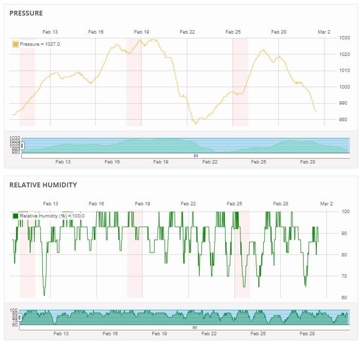

All other things being equal, what you're probably seeing is variation caused by barometric pressure and relative humidity in your (probably air conditioned) laboratory. I'd bet that the air pressure in your area has increased between the first and second standard runs, causing the intensities to drop (or rather, the response of the GFPC detectors). Sealed Xe detectors (for the JEOL folk) aren't impacted by this*.
We can get pretty big swings of 50mbar or more over a few days (see below) and this can cause havoc on our standard intensities, meaning we have to re-standardise frequently.
Fortunately, PfE has a standard drift correction to deal with this but be cautious, I believe it will apply a linear correction between one set of standards to the next when the weather is anything but linear! It can be caught out by sudden drops in pressure (e.g. thunder storms)**.
For example, imagine we ran the standards on the 19th Feb and the 28th Feb, PfE will correct for the drift between these two dates (not that it would be much), but would be oblivious to the large drop in air pressure in between, causing the standards intensities (and the unknowns!) to increase. The answer is obviously to standardise much more frequently, but at some point you actually have to measure the unknown samples and stop using your probe as a rather expensive weather station!

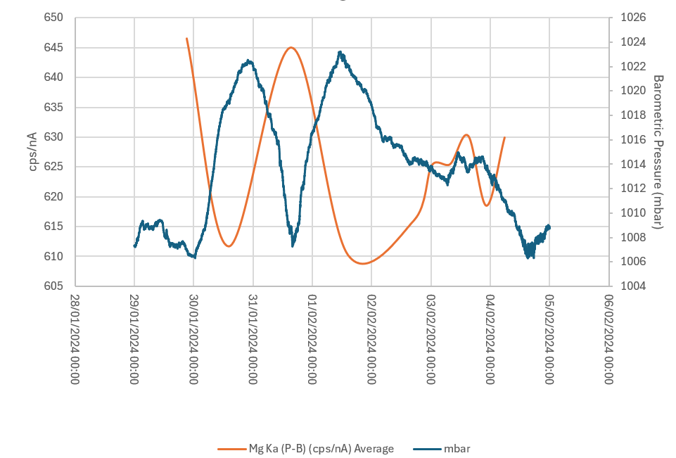

This is from our Cameca last month, low pressure P10 detector looking at Mg in periclase (repeated standardisations). Our JEOL GFPC show similar trends (the Xe detectors don't). This data isn't particularly unusual for here, and the lab air temperature is controlled (not brilliantly in the Cameca lab, but there's no obvious correlation).

Yes, that's right, as the barometric pressure increases, the count rate from the GFPC (not sealed Xe!) detectors decreases.
I suppose this data is the counterpart to the excellent dataset acquired by Brian Joy (here: https://smf.probesoftware.com/index.php?topic=1109.msg10889#msg10889), only instead of varying the bias voltage to maintain a constant count rate and PHA peak position, I held the bias constant and monitored the resulting change in count intensity.
As per the suggestion in that thread, I suspect atmospheric gases (H2O? O2? N2?) are backflowing up the open vent side of the GFPC, hence why you see a higher bias voltage is required on the vent GFPC as opposed to the gas inlet GFPC (JEOL EPMAs tend to be - but don't have to be - daisy chained with the P10 flowing through one spectrometer to the next, as opposed to Cameca EPMAs that have them all fed independently from a single point).
There's a couple of possible mechanisms that I can think of as to why this would reduce count rate: whether via a simple dilution of P10; whether the atmospheric gas is absorbing the X-rays and dissociating, preventing a cascade forming; whether the gas molecules are capturing the e- emitted from the Ar... lots of possible mechanisms!
One other point to note is that I haven't seen this effect on the sealed Xe detectors, leading me to think that it is a physical factor in the detectors rather than an electronic issue (assuming the counting chain for the JEOL GFPC and Xe detectors are the same!).
