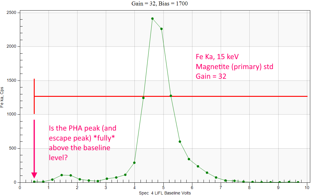

I obtained some JEOL PHA scans from a JEOL colleague trying out the new integral-baseline PHA tuning method. It appears to work well using JEOL gain steps to adjust the PHA peak. Here are the steps one should follow.
1. On the primary (highest concentration) standard (highest expected count rate), start with a bias scan and adjust the bias to be slightly (10 to 20v) above the bias peak:
2. Do a PHA scan:
3. If the PHA (and escape) peaks are not fully above the baseline, do not change the bias! Instead just bump the gain up to the next level (16 to 32)
4. Do another PHA scan:
5. If the PHA peak is fully above the baseline level, you are golden. If not, bump the gain another step and re-run the PHA scan.

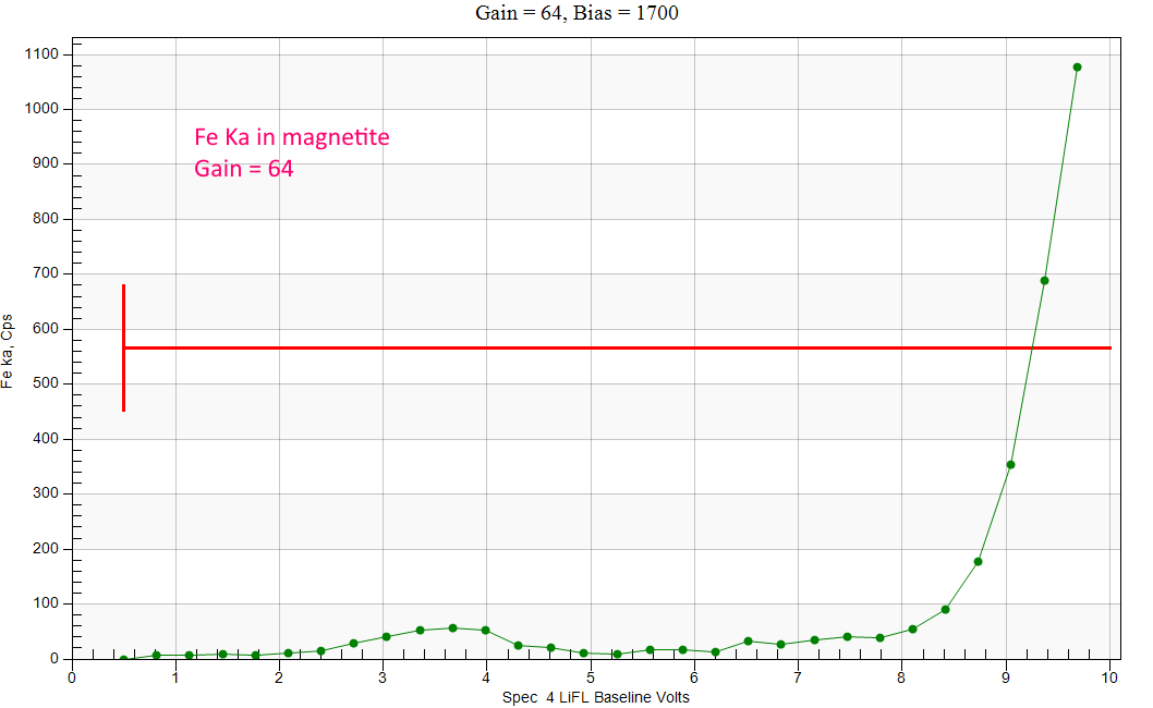

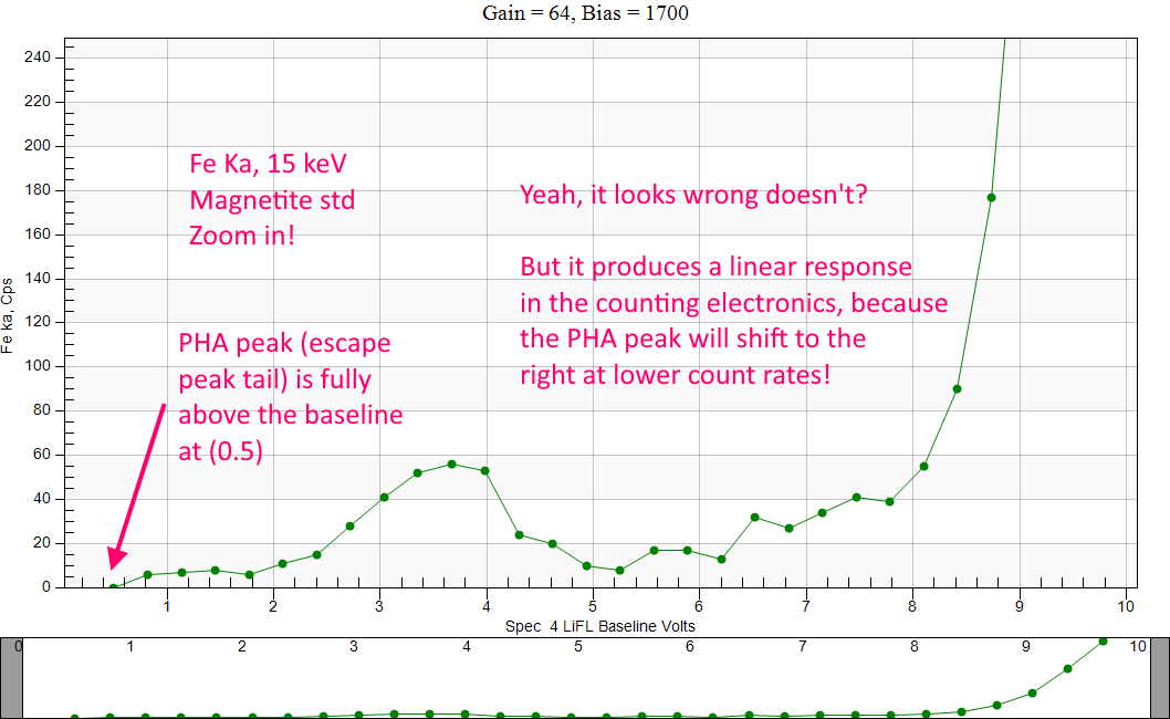

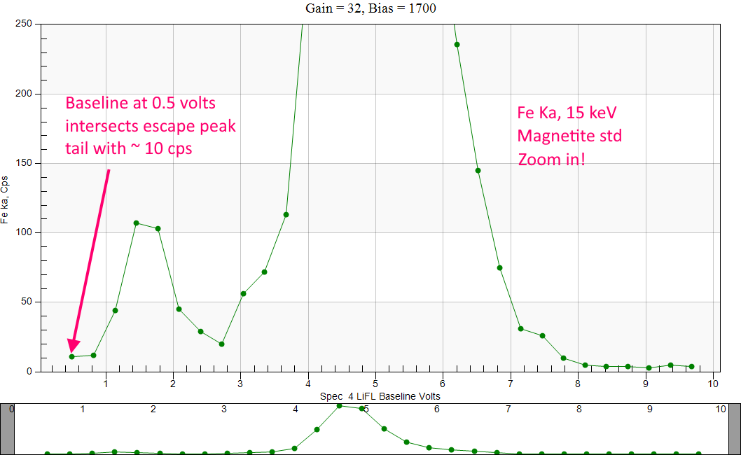

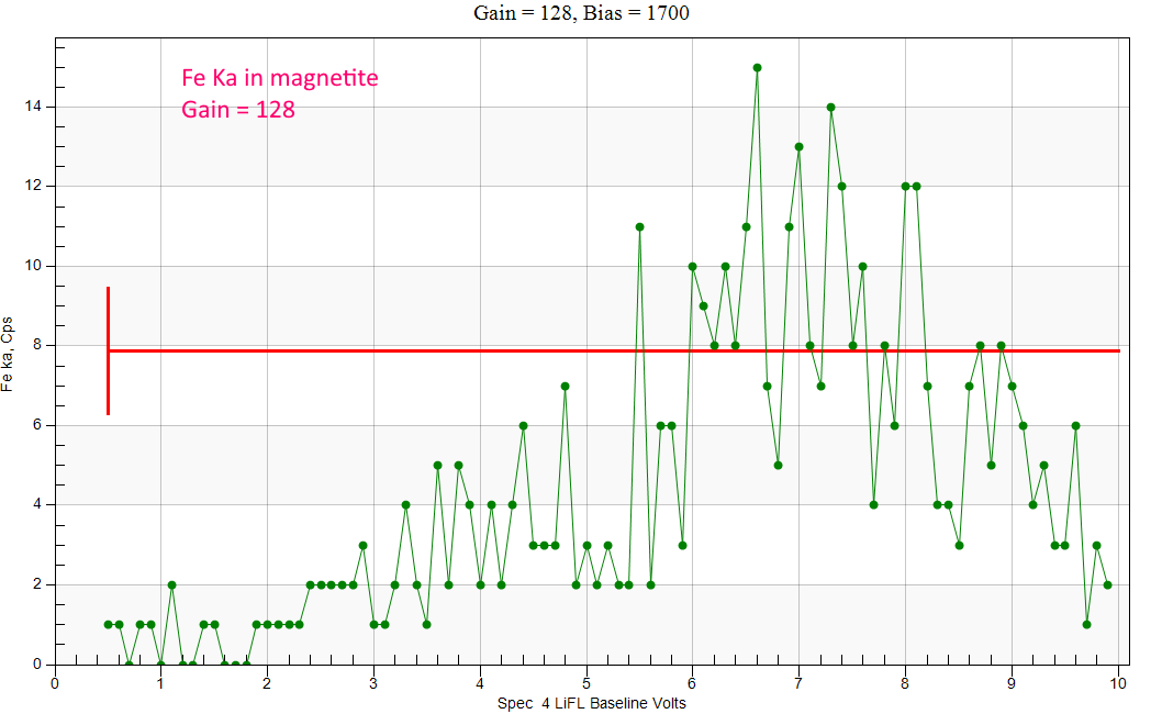

Here are some more JEOL PHA scans from our colleague. First at 32 gain on Fe3O4 starting at a very low 0.1 volts:
One can just see the noise peak starting to show, but the Fe escape peak tail is too close to the baseline.  Next we increase the gain to 64 (and raise the baseline to 0.2 volts):
Now we can see that things looks pretty clean close to the baseline, though we should probably set the baseline to 0.3 volts or so for best results.
Now the same settings as for Fe3O4 but on our K_412 glass (with a much lower count rate on Fe:
The Fe Ka peak has shifted slightly to the right as expected and now the noise peak is starting to show. Next if we simply set our baseline to 0.5 volts or so, we should be good to go for high accuracy quant for both of these materials.

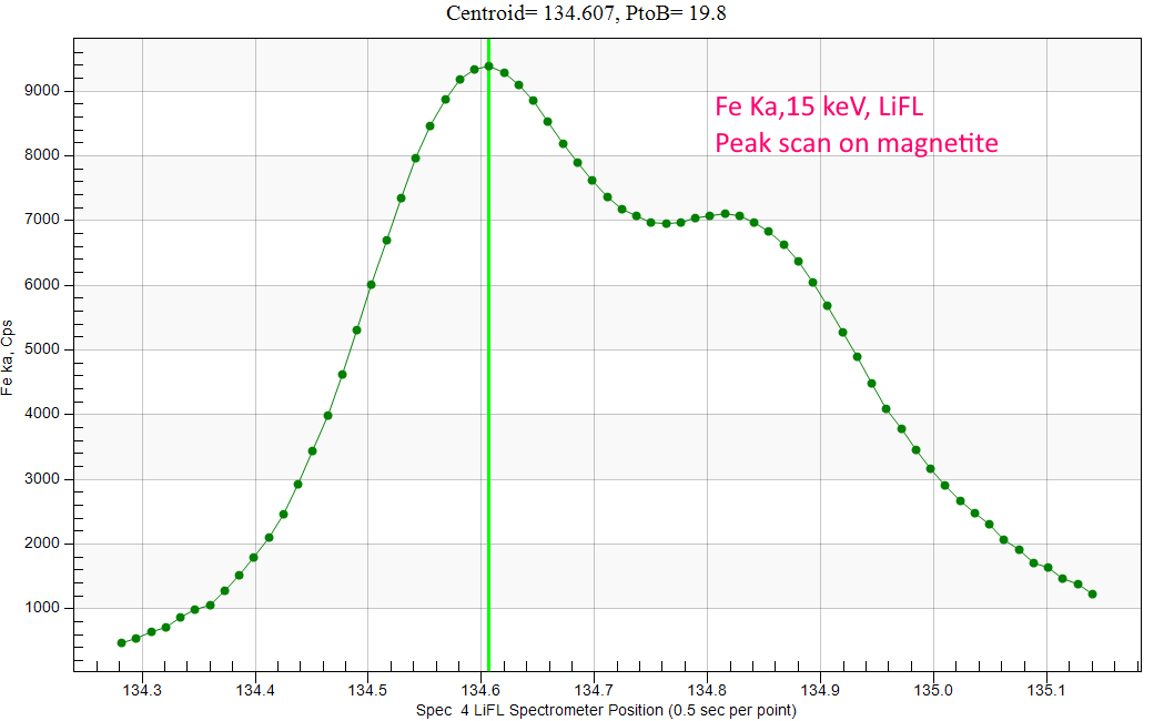

For my tests on the Cameca I choose a natural magnetite that has had wet chemistry performed on it (along with trace element chemistry using AA) as the primary standard, and the NIST K-411 and K-412 mineral glass standards.
I suggest a synthetic magnetite (Fe3O4) or synthetic hematite (Fe2O3) as a primary standard, though a natural magnetite should work if it is accurately characterized, and the NIST mineral glasses as secondary standards, but other materials can be used. If you must use an Fe metal primary standard you will need to use different peak positions for the Fe metal and the secondary glass standards, as the Fe Ka shifts (very) slightly between the oxidized and reduced states.
Here's a step by step procedure from a JEOL instrument starting first with peaking the spectrometer on the magnetite standard:
Next we perform an optional bias scan on the JEOL instrument:
The bias voltage is 10 to 20 volts above the bias peak so we are good.  Next we perform our first PHA scan:

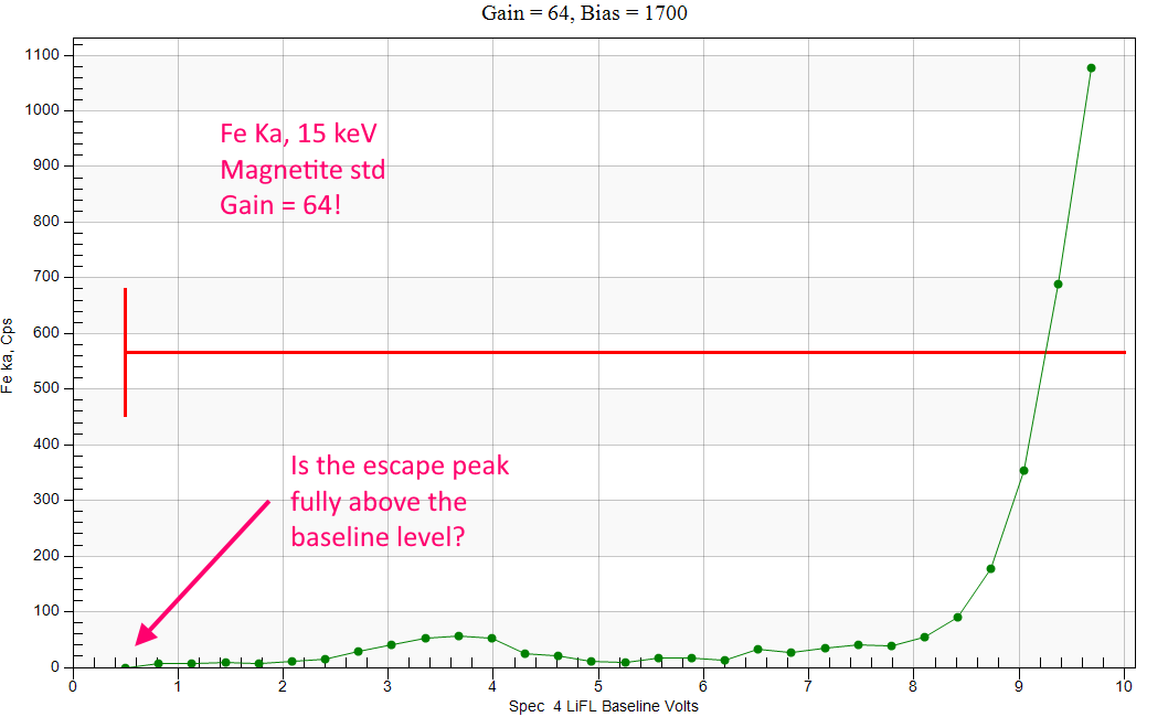

Normally most of us would say this looks like a good PHA tuning, but is the PHA peak (and escape peak if present) *fully* above the baseline?  Let's zoom in a bit:
Huh, it appears the baseline slightly intersects the tail of the escape peak. Remember, we are shooting for 1% accuracy, so this small effect will lead to a non-linear response as we go to a lower count rate and our PHA peak shifts to the right, exposing more of the escape peak tail! Therefore we need to increase our *gain*!
That's right, not our bias voltage, as one usually would on a JEOL instrument, but instead we increase the gain 2x (from 32 to 64) and we see this (just as we did on the Cameca):
It looks OK, but let's zoom in a bit:
OK, that looks good! Remember, all photons to the right will still be counted in integral mode.  But we also need to do a PHA scan on our glass standard, because at lower count rates the PHA peak will shift slightly to the right  and we want to be sure the zero volt noise peak doesn't rise above our 0.5 volt baseline. So here is a PHA scan on the K-412 glass using the same gain = 64:
We don't see the noise peak so we are good to go!  Please try this PHA tuning method yourself by running a high concentration Fe primary standard and a low concentration Fe secondary standard.

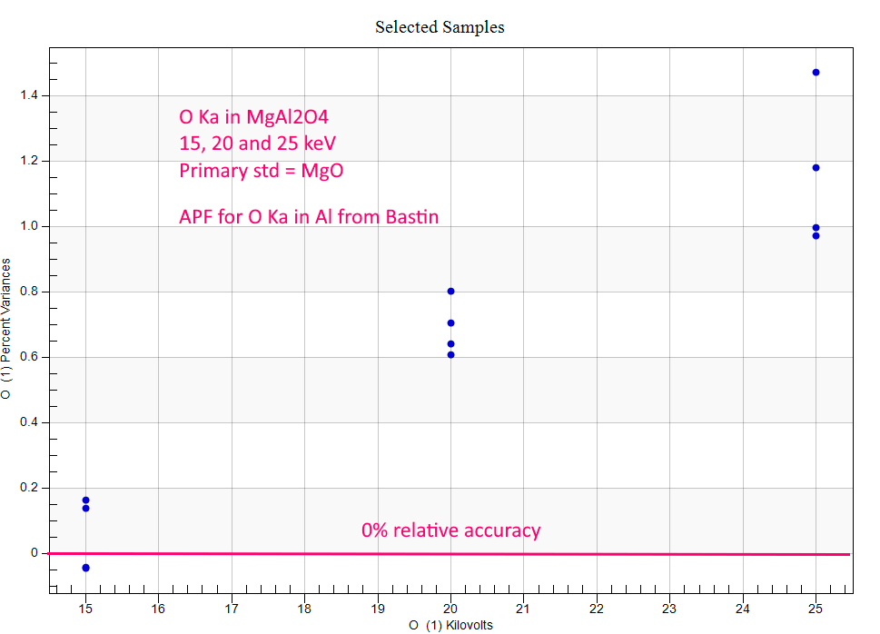

This shows the PHA tuning I and Andrew Ducharme ended up with for O Ka in the FIGMAS MgO, Al2O3, MgAl2O4 mount that was distributed for the K-ratio consensus round robin by Will Nachlas about a year ago:
https://smf.probesoftware.com/index.php?topic=1569.msg13915#msg13915
As you all know, the PHA peak for O Ka is quite wide, and when we attempted to push the PHA peak completely above the baseline level, well, it appeared to be cut-off by the right side of the plot.  I had suspected from discussions with SEM Geologist that the Cameca PHA might still accept pulses from beyond the right side of the displayed PHA peak, but I wasn't sure how far and whether those pulses would still be counted, but worth a try right?

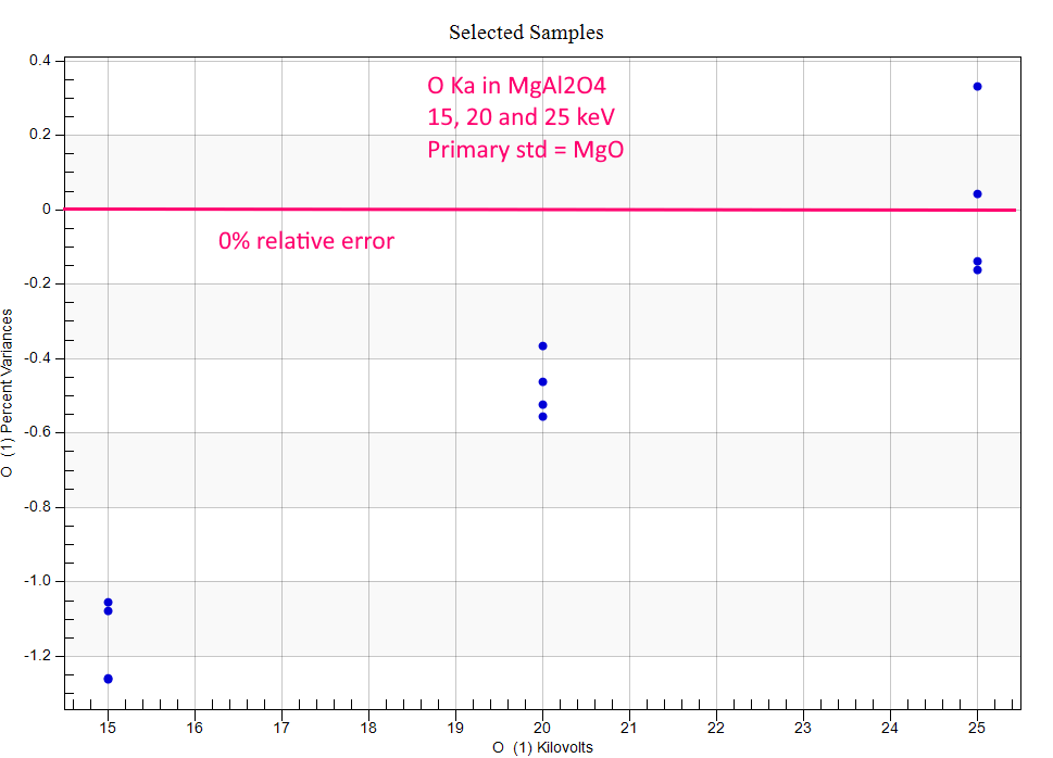

So using the above PHA tuning we get this plot for percent relative accuracy for O Ka in MgAl2O4 at 15, 20 and 25 keV:
This is using FAST MACs and Armstrong/Brown/Donovan and Moy matrix corrections. Slightly low accuracy but still mostly within ~1% relative accuracy from the assumed stoichiometry.
But of course we know that for low Z elements such as oxygen there are some peak shape changes, so let's apply the Area Peak factor (APF) for O Ka in Al from Bastin (the APF for O ka in MgO is 1.000):
OK, now we're slightly high but still within 1.5% relative accuracy for *oxygen* at 25 keV which has an enormous matrix correction of over 200%:

Here's another PHA scan from another run at gain = 64 where we pushed the gain until the Fe escape peak was fully above the baseline level on magnetite:
And here is the count rate on this magnetite for the PHA gain = 64 tuning:
On-Peak (off-peak corrected) or EDS (bgd corrected) or MAN On-Peak X-ray Counts (cps/1nA) (and Faraday/Absorbed Currents):
ELEM:    Fe ka   BEAM1   BEAM2
BGD:       OFF
SPEC:        4
CRYST:    LiFL
BRAGG:       1
ORDER:       1
  109G  482.49  19.970  19.980
  110G  483.66  19.980  19.970
  111G  484.53  19.970  19.980
  112G  482.99  19.970  19.980
  113G  481.42  19.960  19.970
AVER:   483.02  19.970  19.976
SDEV:     1.17    .007    .005
1SIG:      .89
SIGR:     1.31
SERR:      .52
%RSD:      .24
DEAD:    1.260
DTC%:      1.2
And then, just for fun, we increased the gain from 64 to 128!     :o
What do you think happens to the count rate where we now only see the escape peak, because the main Fe Ka PHA peak is completely pushed to the right, where it is no longer even visible?
BGD:       OFF
SPEC:        4
CRYST:    LiFL
BRAGG:       1
ORDER:       1
  114G  483.21  19.980  19.970
  115G  482.98  19.980  19.980
  116G  482.00  19.970  19.970
  117G  482.94  19.980  19.960
  118G  482.34  19.960  19.970
AVER:   482.69  19.974  19.970
SDEV:      .50    .009    .007
1SIG:      .89
SIGR:      .56
SERR:      .23
%RSD:      .10
DEAD:    1.260
DTC%:      1.2
Yeah, that's right.  Using the PHA gain = 128 tuning, we're still within a standard deviation of the count rate of the PHA gain = 64 tuning.
Let that sink in a minute.
