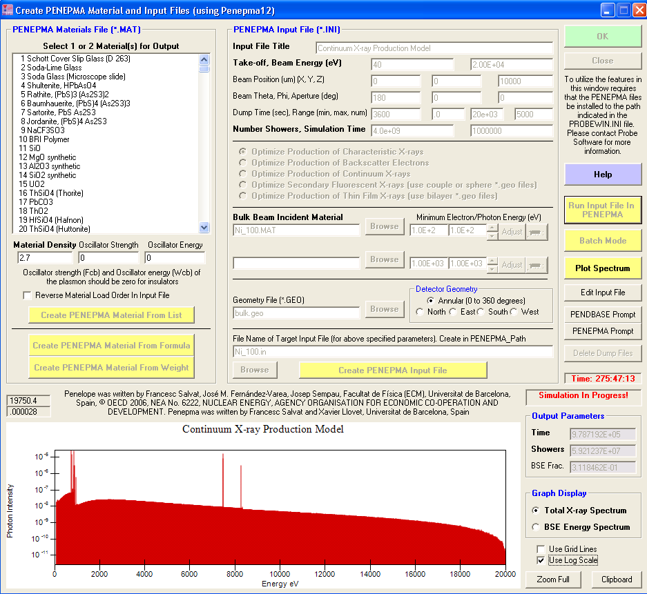

We've been modeling continuum intensities in Penepma for a number of pure elements and compounds.
Ever wonder what the spectrum looks like for a 1000K seconds long simulation looks like after 275 hours?
Now that's one smooth continuum...    8)
