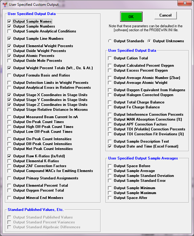

But if you want to get all the samples into Excel, the easiest way is to simply click the Output | Save User Specified Format menu.

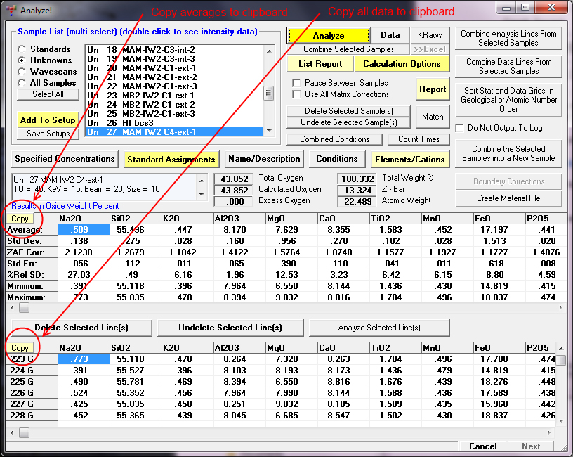

1. In the Analyze! window you can select specific samples and have them directly output to ASCII files and optionally an Excel spreadsheet:
http://smf.probesoftware.com/index.php?topic=8.msg427#msg427
2. You can use the "Copy" buttons in the Analyze! window to paste the data into Excel. Since the text is tab delimited, it automatically formats for Excel as seen here:
3. Or just dump it all out using the Output | Save User Specified Output Format menu as seen here:
If there is an output you need, just let me know.
