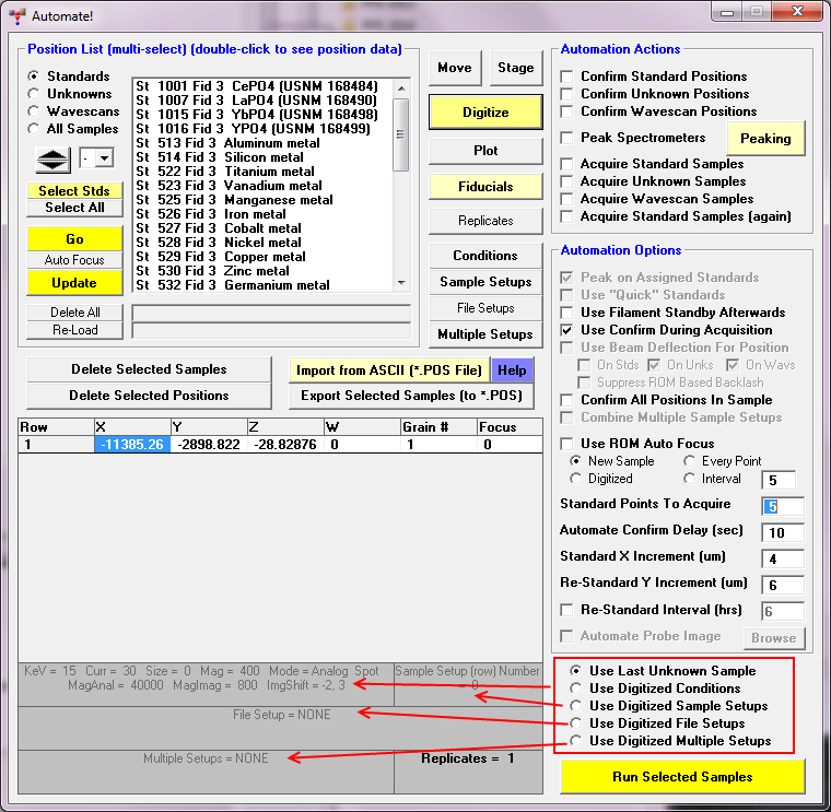

Please also check the attached screenshot . The beam conditions displayed via the Analyze! window on the left show a 2um defocus. The conditions displayed in the Automate! Window on the right show the same conditions without a defocus.
What are the two fields actually displaying here and which set of conditions actually apply to the analysed sample?

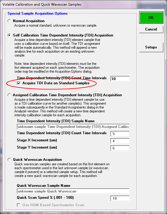

Also please remember that, although not always necessary, one can also "turn on" TDI acquisitions for standards also as seen here:
Therefore if your standards are also beam sensitive you can correct for this- especially important for materials such as apatite where the crystal orientation in the standard mount affects the standard intensities.

Can you tell me why the two sets of beam conditions for the same sample in the attached image do not agree?

Quote from: Richard Walshaw on April 04, 2014, 01:36:36 AM
I have looked into TDI but will double check everything. Can you tell me why the two sets of beam conditions for the same sample in the attached image do not agree?

I guess Richard is talking about the kyanite conditions2.jpg attached to post #1.

Yes, the conditions from the Acquire! window are the last column condition sent to the instrument, so they are usually "current".
The conditions you have circled in the Automate! window are the "digitized conditions" parameters which are then assigned to the various positions samples for automatic acquisition with different conditions for different samples.  The display are actually "disabled" (more gray) to indicate that you haven't selected the "Use Digitized Conditions" option in the Automate! window.
Here is a discussion using "digitized multiple sample setups":
http://smf.probesoftware.com/index.php?topic=111.msg405#msg405
To see the enable/disable on these different automation options try selecting these different "automation basis" options and see the enable/disable selection change:
