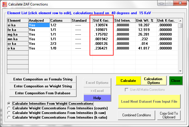

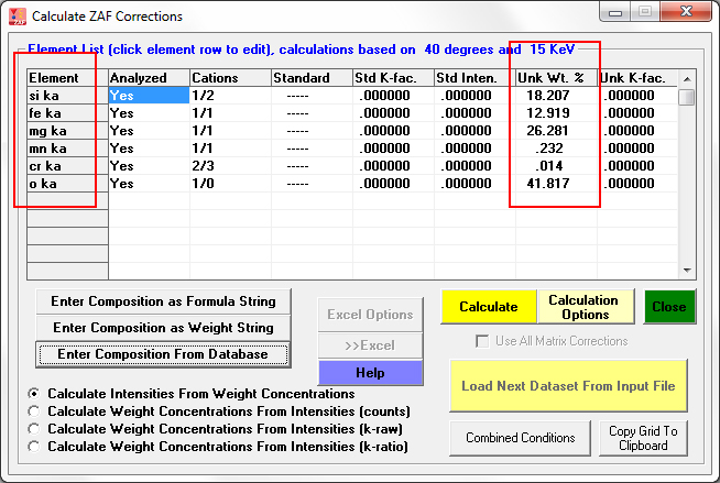

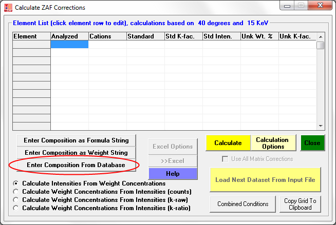

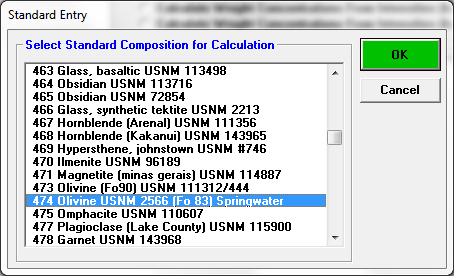

We can select any material containing both Mg and Fe, say this USNM olivine as seen here:
The application loads the composition as seen here:
and by clicking the Calculate button we obtain these results as seen here:
Now let's examine the results output to the log window  as seen here:

The column labeled "K-VALUE" is the calculated elemental k-ratio for the elements in question. That is, the intensity relative to a theoretical pure element. This can be compared to the element concentration (1.0 = 100%) to calculate the matrix correction factor. So for Mg Ka at 15 keV we have 0.1757 for the k-ratio intensity and 0.26281 for the concentration (26.281 wt.%). So 0.26282 / 0.1757 yields a correction factor of 1.49 or approximately 150%. A large absorption correction clearly which can be checked by looking at the ZAFCOR value for Mg.
Now of course this is only the case for the default physics model and that can be changed from the Analytical | ZAF, Phi-Rho-Z, Alpha factor and Calibration Curve Selections menu as seen here:

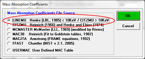

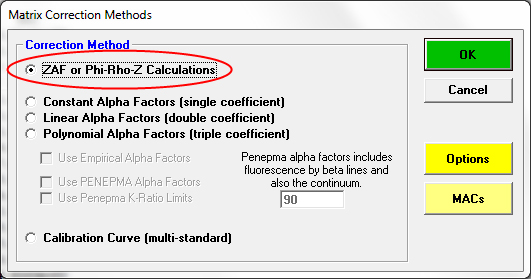

We can change the physics model by clicking the Options button and change the default mass absorption coefficient table by clicking the MACs button as seen here:
Let's select the traditional Heinrich MACs which are normally used by many programs and recalculate our k-ratios as seen here:

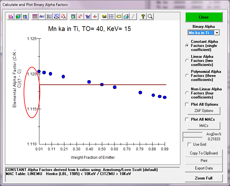

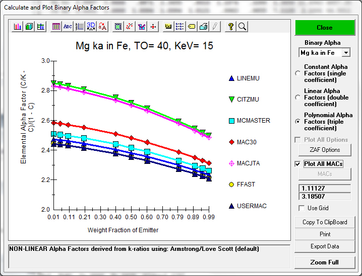

As a final (for now!) example, we can use the Analytical | Calculate and Plot Binary Alpha Factors menu as seen here where we have selected the Mg Ka in Fe matrix display:
Now you might ask: why is the displayed Y axis alpha factors showing around 2.5 instead of around 1.5?  It is the nature of alpha factors. Around 2.5 is the correction for Mg in Fe, but there is also the correction of Mg in Mg, which by definition is 1.0. So when we weight the contribution from each binary (Mg in Fe and Mg in Mg) we obtain a "beta-factor" of around 1.5 as seen here:
[tt]St  474 St  474 Olivine USNM 2566 (Fo 83) Springwater
TakeOff = 40.0  KiloVolt = 15.0  Density =  3.300
Analysis (wet chemistry) by Gene Jarosewich
Standard Z-bar:  12.53479
ELEM:      Si      Fe      Mg      Mn      Cr      O
ELWT:  18.207  12.919  26.281    .232    .014  41.817
NRWT:  18.207  12.919  26.281    .232    .014  41.817
BETA:  1.3679  1.1748  1.4819  1.1942  1.1403  1.7009
[/tt]

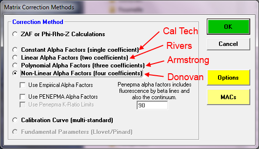

I recently implemented a new regression method for alpha factor matrix corrections as described here:
http://smf.probesoftware.com/index.php?topic=40.msg2762#msg2762
This new regression method improves the accuracy for situations in which very large fluorescence or absorption effects are present. This method can also be abused in situations in which some noise is present, for example low precision (low overvoltage or low concentration) Monte-Carlo derived k-ratios.
But first a short history of these regression efforts to model electron-solid interactions for binary pairs of elements over time as seen in this graphic:
The original method was proposed by Bob Ogilvie and others at MIT and applied to geological samples at Cal Tech (Bence and Albee) in the early 70's was to allow empirically measured k-ratios in binary compositions of known standards to be utilized for matrix corrections for complex materials. The Cal Tech implementation was originally based on assuming that the matrix correction did not vary as a function of the binary compositional range to facilitate the use of slide rules for calculations and therefore assumed the matrix correction at a 50:50 constant composition applied to all compositions for that binary.
This is not as crazy an assumption as one might think, for there are some binaries in which the matrix corrections are relatively constant over the binary range, for example as seen here:
Furthermore, for silicate matrices, which was the target main effort to improve matrix correct accuracy at Cal Tech, the matrix is mostly oxygen and therefore the matrix corrections were relatively more constant than in other systems.
However, it was soon realized by Mark Rivers (in the late 70's), then at UC Berkeley, that by rearranging the traditional alpha expression to solve for alpha, one could perform almost any regression equation to the alpha factor calculations. He applied a linear assumption which is far better than the constant assumption as seen here for the same dataset:
This was an enormous improvement in accuracy especially in non-geological matrices such as sulfides and other minerals and alloys.

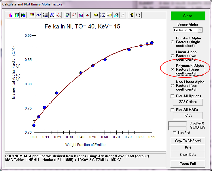

But for instances where significant absorption or fluorescence effects are present John Armstrong in the late 80's (then at Cal Tech), noted that a polynomial fit would handle even these situations quite well as seen here for the famous Fe Ni binary:
Further details on the Rivers linear and Armstrong polynomial alpha factor methods can be found here:
http://epmalab.uoregon.edu/bence.htm

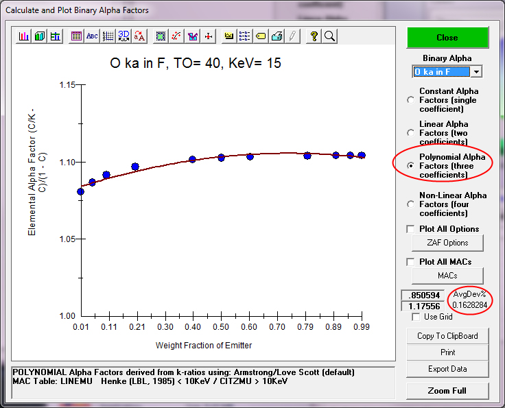

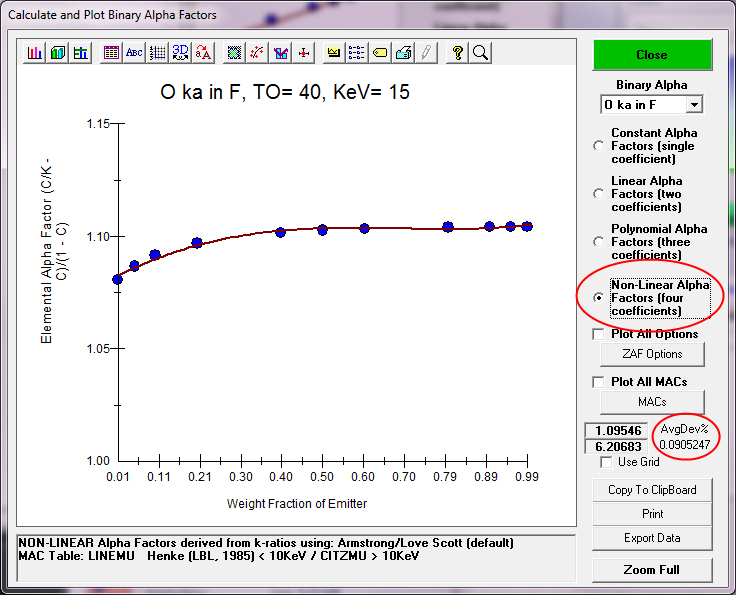

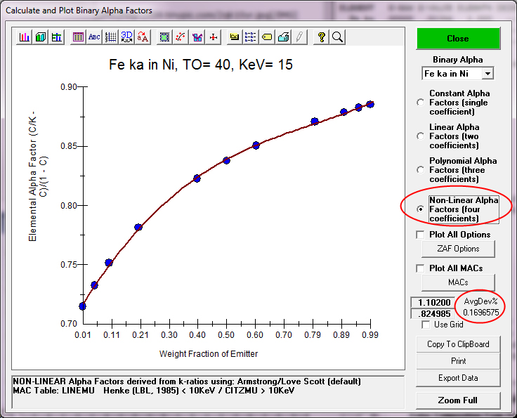

However, the keen eye will will notice that the polynomial fit isn't perfect and with the addition of a four coefficient non-linear regression even these extreme situations are dealt with properly as seen here for the same system:
Note that the average deviation for this non-linear expression is significantly improved, compared to the polynomial basis. For the record, the polynomial regression basis for the Mark Rivers alpha expression, (C/K - C)/(1 - C), is seen here:
alpha = coeff1 + conc * coeff2 + conc ^ 2 * coeff3
The corresponding beta expression (for summing binary alpha factors for complex matrices) for the polynomial fit is seen here:
beta = (coeff1 + conc * coeff2 + conc ^ 2 * coeff3) * conc
The regression basis for this new non-linear four coefficient fit is seen in the alpha expression here:
alpha = coeff1 + conc * coeff2 + conc ^ 2 * coeff3 + Exp(conc) * coeff4
and the corresponding beta expression for the non-linear fit is seen here:
beta = (coeff1 + conc * coeff2 + conc ^ 2 * coeff3 + Exp(conc) * coeff4) * conc
Remember: all this fitting takes place in hyperbolic space due to the nature of the alpha concentration - kratio relationship as first described by Ogilvie!
And even for extreme absorption situations, this non-linear alpha expression shows improved accuracy as seen for the fluorine - oxygen system, first here as a polynomial fit:
and here the same system with a non-linear regression:

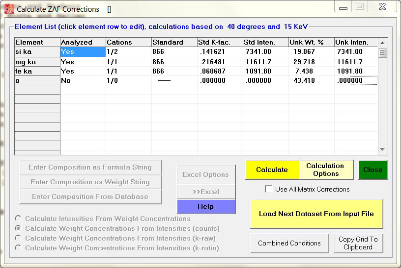

First of all let me thank you for making  such excellent invaluable tool as CalcZAF available for everyone to use for teaching and modelling.
Regarding example of olivine calculation given above, it interestingly resonates with one of the recent cases in our laboratory. Our laboratory is equipped with JEOL 8530F. We have ambitious customer requesting high quality olivine analysis for both major and trace elements. In the first part of the procedure we measure 3 elements Fe, Mg and Si at regular conditions 15kV and 20 nA. All elements are calibrated using San Carlos olivine USNM 111312-44. Later the same grain is used as secondary standard. However analytical  results were not accepted as Mg concentrations were systematically lower than tabulated value even though k-raw values were all close to or slightly higher than 1. We used CalcZAF to test different corrections and found that Bastin PROZA and XPP with FFAST MACs  produce better result. However we failed to fully reproduce the standard even assuming k-raw values unity. No matter how hard we tried, Mg values were pushed down by correction procedures.
The SCOlivine setup was as follows:
Elemental Weight Percents:
ELEM:       Si      Mg      Fe       O   TOTAL
     1  19.062  29.698   7.437  43.400  99.597   Armstrong/Love Scott (default)
     2  19.067  29.703   7.437  43.409  99.616   Conventional Philibert/Duncumb-Reed
     3  19.064  29.696   7.436  43.400  99.595   Heinrich/Duncumb-Reed
     4  19.064  29.700   7.437  43.403  99.605   Love-Scott I
     5  19.063  29.699   7.437  43.402  99.601   Love-Scott II
     6  19.074  29.719   7.437  43.427  99.657   Packwood Phi(pz) (EPQ-91)
     7  19.066  29.700   7.437  43.406  99.609   Bastin (original) Phi(pz)
     8  19.067  29.718   7.438  43.418  99.640   Bastin PROZA Phi(pz) (EPQ-91)
     9  19.067  29.701   7.437  43.407  99.612   Pouchou and Pichoir-Full (Original)
    10  19.067  29.704   7.437  43.410  99.618   Pouchou and Pichoir-Simplified (XPP)
As seen from the calculation results Mg values are systematically below the standard value 29.80wt%. When recalculated to oxides the difference becomes more depressing to the customer. We explain how corrections have to be applied and that is how we can use standards different from unknown. At this point customer gets out a bunch of publications, where stated mean measured value is practically identical to the standard value. The question is: is there a way other than MS Excel "correction" to obtain accurate Mg values in forsteritic olivine using currently available matrix corrections?
Best regards,
Sergei Matveev

Note that extrapolating from MgO to Mg2SiO4 is within 0.5% relative accuracy! And this is a factor of two difference in intensity and a matrix correction of around 30%.
4. If you can't get the secondary standard and primary standard to agree you have a real problem. Especially if they are the same standard! You mentioned a FEG EPMA.  These instruments can focus a lot of beam into a very small volume and damage specimens that we used to consider "beam stable".  Did you run *exactly* the same analytical conditions and acquisition times on both the primary and secondary standard and the same grain?  This would be a good sanity check so I would start with that.
5. Aside from all that there is a very large absorption correction for Mg Ka by Fe. Here are some MACs from a number of tabulations (you can do this yourself in CalcZAF from the X-Ray menu):
MAC value for Mg ka in Fe =    5239.40  (LINEMU   Henke (LBL, 1985) < 10KeV / CITZMU > 10KeV)
MAC value for Mg ka in Fe =    6120.70  (CITZMU   Heinrich (1966) and Henke and Ebisu (1974))
MAC value for Mg ka in Fe =    5395.10  (MCMASTER McMaster (LLL, 1969) (modified by Rivers))
MAC value for Mg ka in Fe =    5518.65  (MAC30    Heinrich (Fit to Goldstein tables, 1987))
MAC value for Mg ka in Fe =    6089.53  (MACJTA   Armstrong (FRAME equations, 1992))
MAC value for Mg ka in Fe =    5089.56  (FFAST    Chantler (NIST v 2.1, 2005))
MAC value for Mg ka in Fe =    5089.56  (USERMAC  User Defined MAC Table)
So there is some significant disagreement in the fundamental physics.  I will only note that the Heinrich value which was and is still being used by many software packages, is anomalously high.  In fact, this is usually the problem when people report high totals in garnets, etc.  See here:
http://epmalab.uoregon.edu/UCB_EPMA/problems.htm
However, since you are using the same standard for both the primary and secondary standard, the MAC is irrelevant. Instead you have a fundamental measurement problem.  The k-ratio in this particular case *must* be 1.000.
This is what I say say for starters.
By the way, I also calculated the MgO (primary) to Mg2SiO4 (secondary) extrapolation here using all 10 different matrix corrections:

Interesting question ... and opportunity to look at the 'black box' of the matrix correction.
-- you were using raw K-ratios of 1 or slightly greater than one for your CalcZAF calculations.
So I went and ran calczaf myself, for the published San Carlos composition which shows Mg as 29.80 wt %, using ONLY Si, Fe and Mg (and stoic oxygen) and I got the same low value for Mg (0.10 wt% low). Hmmm.
Note that I had loaded the proper composition using the Enter Composition from Database button, and then
chose the option Calculate Weight Concentrations from Intensities (K-raw), then selected each element, assigned the standard to be the SC olivine from my PfE database, and also entered Intensity (k-raw) as 1.000. Then calculated.
When ALL the elements including Ca, Mn and Ni are entered, calczaf does spit out 29.80 as the Mg wt%.
So I then went thru and deleted elements one by one.
Deleted Ca and Mg is now 29.797, not much change
Deleted Mn and Mg is now 29.781, decrease a bit
Deleted Ni and guess what, Mg is now 29.704...exactly the number you saw.
Thus, those small amounts of Ni cause a change in the matrix correction, enough to have Mg low by 1000 ppm or 0.1 wt%.

Excellent detective work!  I never would have guessed that a trace amount of Ni could have that much effect on the Mg ka matrix correction!
By the way, here are the MACs for Mg Ka by Ni
MAC value for Mg ka in Ni =    6506.00  (LINEMU   Henke (LBL, 1985) < 10KeV / CITZMU > 10KeV)
MAC value for Mg ka in Ni =    7709.50  (CITZMU   Heinrich (1966) and Henke and Ebisu (1974))
MAC value for Mg ka in Ni =    6911.97  (MCMASTER McMaster (LLL, 1969) (modified by Rivers))
MAC value for Mg ka in Ni =    6856.25  (MAC30    Heinrich (Fit to Goldstein tables, 1987))
MAC value for Mg ka in Ni =    7657.83  (MACJTA   Armstrong (FRAME equations, 1992))
MAC value for Mg ka in Ni =    6327.90  (FFAST    Chantler (NIST v 2.1, 2005))
MAC value for Mg ka in Ni =    6327.90  (USERMAC  User Defined MAC Table)
Even worse than for Fe.

Quote from: smatveev on July 15, 2015, 06:53:00 AM
We performed analysis of SC olivine immediately after calibration and were planning to set up different protocol for trace element analysis (including Ni) at much harsher conditions (400nA). K-raw values were close to ideal, precision was excellent, but Mg was below the tabulated value.
Hi Sergei,
Remember, when performing trace analyses it is better to check if one can measure a zero (or very small non zero) concentration in a similar matrix material.
Checking accuracy on a secondary major element standard is useful for major element accuracy checks, but for trace elements you want to be sure you can measure zero accurately because the background measurement becomes the dominant source of error!  Ideally for trace analysis, you should check if you can measure zero Ni on a pure synthetic Mg2SiO4 or Fe2SiO4 standard.
See here for more details:
http://smf.probesoftware.com/index.php?topic=29.msg387#msg387
smatveev
John, thank you, very good point! I will test our "blanks".
On slightly different aspect of trace element analysis. Our software manual states that (at least in case of ZAF correction): the calculation is iterated until the calculation error is reduced to within 0.001 mass% or until the tenth iteration. My question is, how other packages treat iteration process and how does it affect detection limits of quantitative analysis?
Sergei
Quote from: smatveev on July 15, 2015, 08:17:34 AM
Huh, that's a good question. I never thought about that limitation but I think you are correct that if your iteration only iterates to 10 PPM that might be a problem for ultra trace elements.
Of course it would only be a problem if you are analyzing all trace elements, since if a major element is present in the iteration that will dominate the matrix correction loop...
I can only speak to my code which iterates until the changes are less than 1 PPM:  ZAF_Min_Toler! = 0.0001
smatveev
John, thank you very much for excellent guideline to the trace element EPMA analysis. I have downloaded attached materials, will look into details, and share it with customers and colleagues involved in the project. Much of it unfortunately would not be possible to perform at the moment, but it is great to know that there are possibilities to significantly improve using proper software.
Sergei
smatveev
Quote from: Probeman on July 15, 2015, 08:36:07 AM
John, does it mean that iteration routine does not wait until every element is converged, but the first one to reach the difference limit?
Sergei
