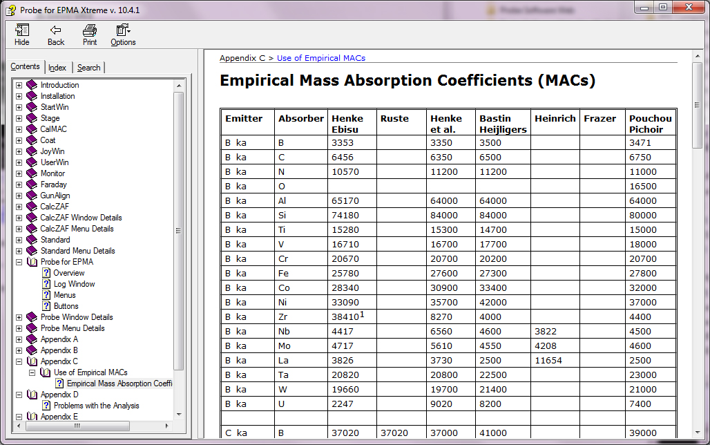

Quote from: Spratt NHM on July 11, 2014, 07:37:09 AM
Hopefully I have attached a bmp of the MAC table from the first edition, which differs from the second.
This is what I have in my Help file for boron, however, the empirical MACs table included with our CalcZAF distribution is attached below.

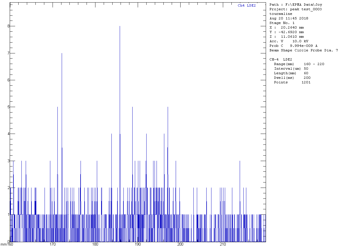

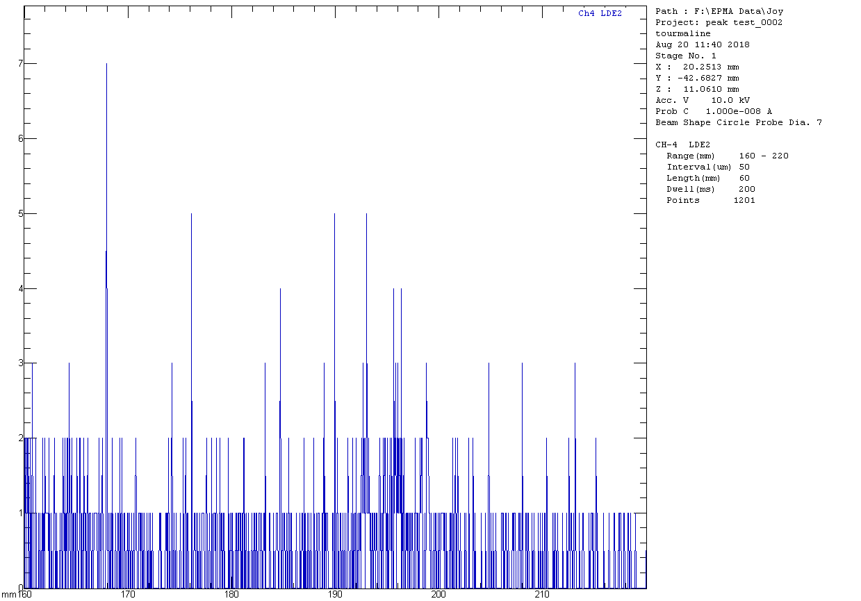

Another problem is that a typical tourmaline only contains about 3.2 wt% B, while stoichiometric BN contains 43.56 wt% B.  I'm about to collect a wavelength scan using LDE2 under the stated conditions on a tourmaline that I analyzed last Thursday.  By stoichiometry it contains about 10.3 wt% B2O3.
Here are two scans collected using LDE2 under the stated conditions on the same tourmaline grain.  A further complication is that B Kα occurs at high Bragg angle on LDE2.  L ≈ 190 mm corresponds to sine(θ) around 0.68.

I attach my presumably-tourmaline raw and smoothed scans. The KLM database puts the peak at about 191 as you can see, while the BN (not attached) is peaking at about 193.X .
So what do you guys think....is that small bump at 191 is the B peak in tourmaline? And what is the big peak at about 195...is that a shifted B? O-III?
