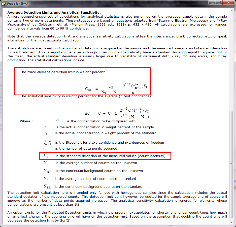

Image inserted by John:

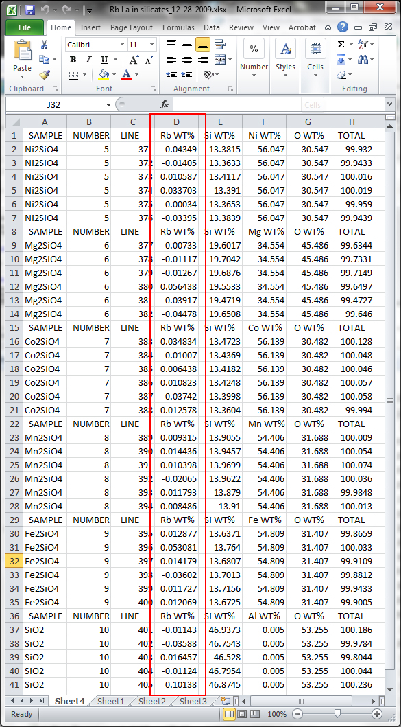

And also attached below, the PFE data from my Am. Min paper.
Gareth D Hatton
Nice of you to share your raw data with us.  Very interesting to see what xtremes ( ;) ) the probe can go to  8)
