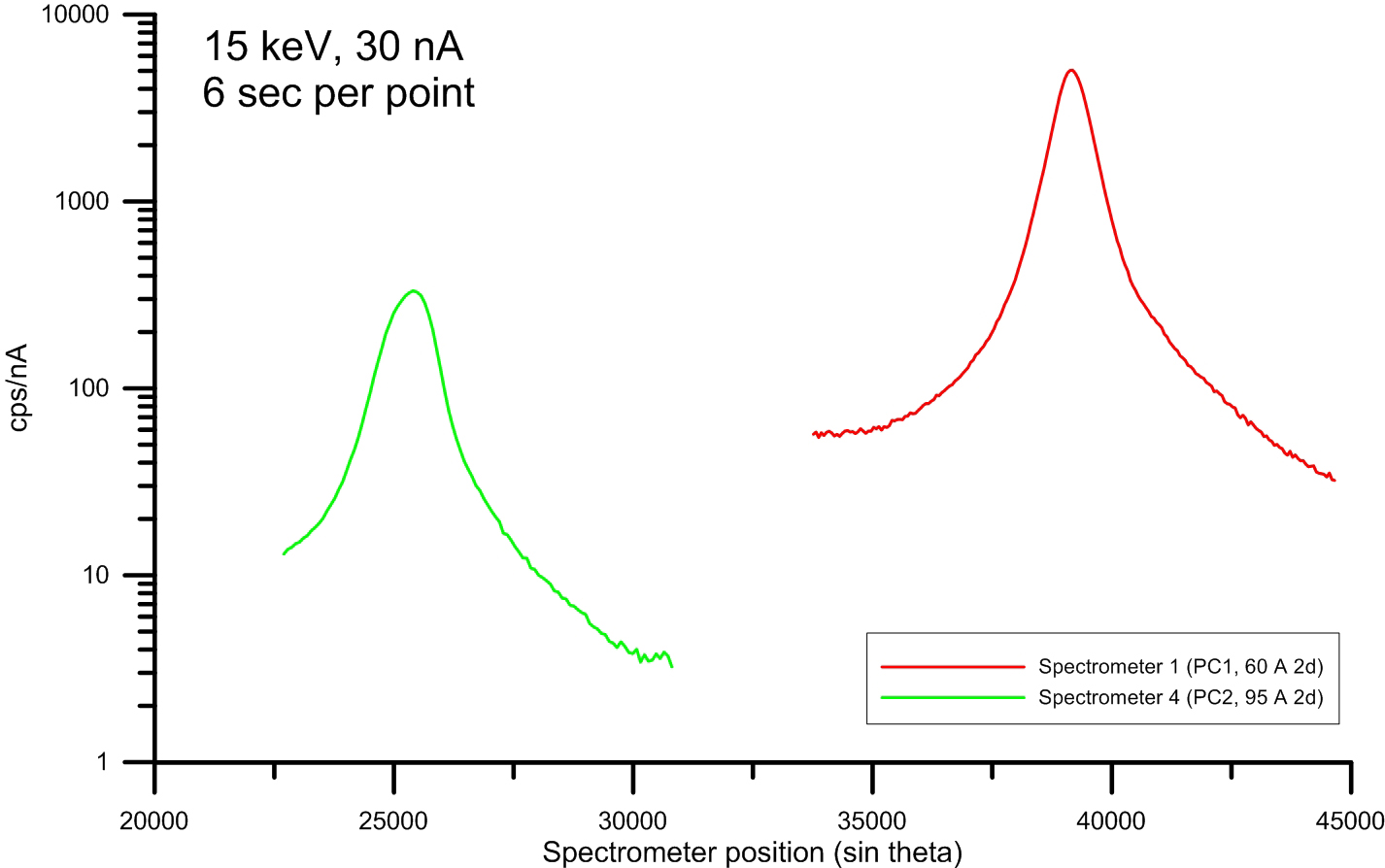

I don't have a PC0 (45 angstrom 2d), but the PC1 (W/Si 60 angstrom 2d) works fine for oxygen and we use it all the time even for trace oxygen. The PC2 (95 angstrom 2d) could be used, but the low side background is inaccessible and the count rate is much lower for oxygen. The PC2 is actually optimized for N ka.
Compare this plot on MgO:
