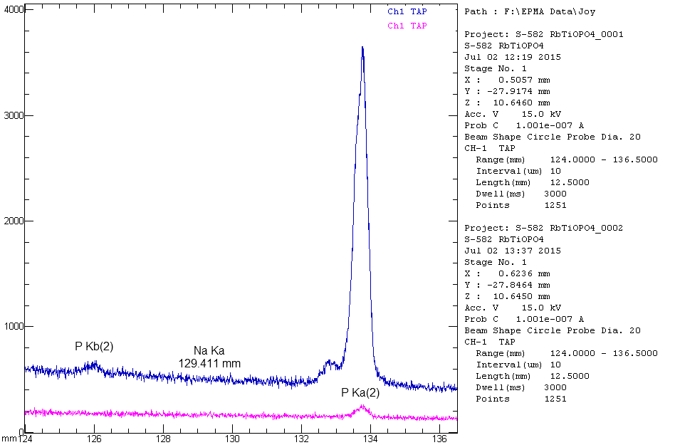

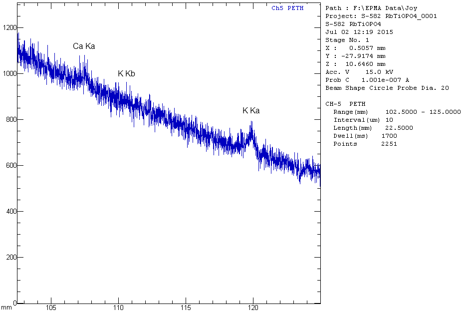

The RTP material I got from Marc consisted of a single chunk.  The portion of it that I've mounted appears to be very homogeneous; the arsenate does not appear to be present.  The only impurities I can find in easily detectable concentrations are K and Ca; the concentration of K2O is very consistently around 200 ppm, while CaO is around 100 ppm.  I see no evidence of Cs in wavelength scans or in quantitative analyses (using LiF to avoid interference from Ti Ka).
In measuring Na Ka, I operated in differential mode (lower purple curve) to suppress interference from P Ka(2) and P Kb(2) at the background offset positions (which I set to the low-L and high-L side, respectively, of the interfering line in order to avoid excessive background curvature).

I screwed up labeling of peaks on the PETH wavelength scan in my post about impurities in RbTiOPO4 from Calchemist.  I accidentally labeled Ca Ka as K Kb, and so I've corrected it in the original post.  The K Kb peak is barely visible.  I should have posted about my results when they were fresh in my mind last summer.
Quote from: Brian Joy on March 19, 2016, 02:16:32 PM
Hi Brian,
This is getting "interestinger and interestinger".
You ran 1.7 sec dwell time and saw a Ca peak, but my Ca wavescan with 6 sec dwell time did not see any Ca and my Ca quant gave 0 +/- 10 PPM precision.
Did you quant Ca (and Mg)?  If so, what did you get?
I'm going to hit this hard tomorrow and get to the bottom of it- multi-point backgrounds and all!  I'll also measure Ti and P so I can do an interference correction for Ti on Cs and P on K.
