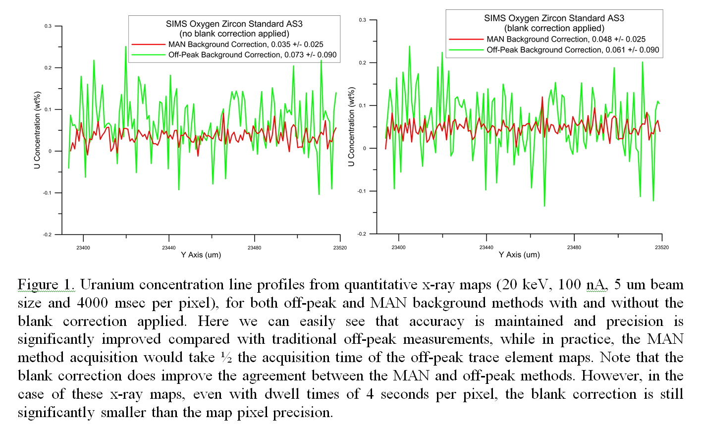

Attached below are maps of the off-peak and MAN determined background intensities and their statistics and also the regression fits for the MAN calibration curves.
In addition here's a post showing how to compare off-peak and MAN methods on the same dataset and also a pdf comparing the off-peak, Nth point and MAN background methods on both homogeneous and heterogeneous materials.
http://smf.probesoftware.com/index.php?topic=4.msg189#msg189
Note that the x-ray maps below show the calculated backgrounds for each pixel. On the off-peak map, the calculated background is the linear interpolation of the hi and lo off-peak positions.
On the MAN map the calculated background is the regressed on-peak intensity of standards *not* containing the element of interest, corrected for continuum absorption (to obtain the generated continuum intensity inside the sample) and then based on the calculated composition and hence average atomic number, finally decorrecting the continuum intensity obtained from the regression for the unknown specimen matrix effects.
This results in a much more constant background which results in better precision (and for a given composition, the background production physics should be always the same, no?).

On the other hand, for obtaining high accuracy we use the blank correction. Which by the way isn't even necessary for x-ray mapping in most cases, because the variance of the on-peak data will be larger than the blank correction itself. For point analyses, sufficient precision is obtainable in 10 or 20 seconds of on-peak counting, hence, the need for a blank correction when trying to determine trace element concentrations below 100 to 200 PPM in oxides and silicates.

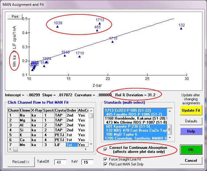

This is exactly why one should have a few pure oxides or even pure metals available for the MAN fit. We typically use MgO, Al2O3, SiO2, TiO2 and MnO and/or NiO.
Note that when an interference is present (and/or an unexpected contamination in the MAN std), the intensity for that standard will plot above the MAN regression line as seen here:
As for unexpected contamination in the std used for the MAN fit, it also looks similar as seen here where several of Paul Carpenter's in house standards contain some unexpected traces of Mn:
In these cases it is not actually necessary for the analyst to know whether the outlier is due to a contamination or an interference, but it really doesn't matter for most purposes (though if it really is a contamination that you found, at least you learned something about your standards you didn't know before!). Therefore simply unselect the offending std intensities using a <ctrl> click and PFE will update the fit.

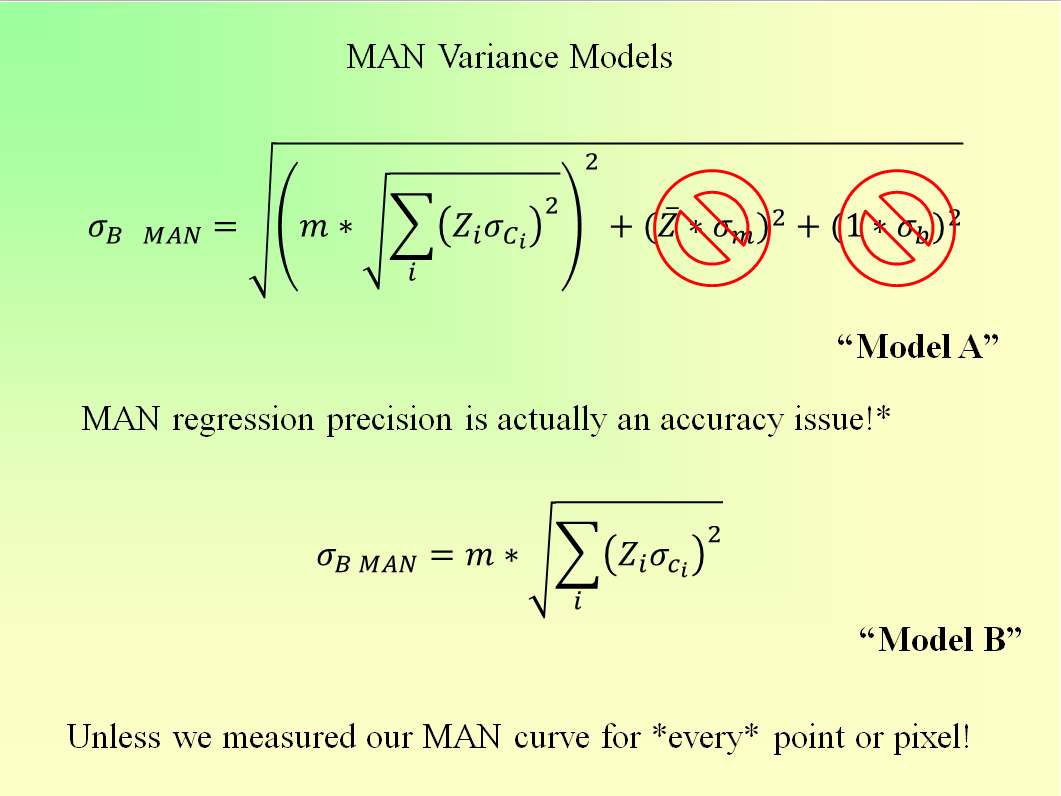

I've recently had some utterly illuminating discussions with Jared Singer (at RPI) regarding the above questions concerning accuracy and precision for MAN backgrounds and wanted to give a quick highlight of a few of the ideas we discussed. I'm at M&M at the moment so I will cover this in more detail after I get back to UofO.
One question of a few of my colleagues is "shouldn't you be including the precision of the MAN regression in the background calculation"?  And the answer that Jared and I have both come to is, yes and no...
Here is a short response: consider a normal off-peak measurement where the interpolated off-peak intensity is subtracted from the on-peak intensity.  When this net intensity is then converted to a concentration, do you include in the concentration calculation any consideration of the precision of the measurement?  Of course not!  You simply convert the net intensity to concentration through the matrix correction physics method(s).
Now, should you include the precision of the off-peak measurement in your estimation of the measurement precision or sensitivity?  Of course you should!
At a zero concentration, the variance of the off-peak measurement will be equal to the variance of the off-peak measurement. That is to say, just as important and therefore, you should (must) include the variance of both terms in the sensitivity calculation. See attachment below showing how they add in quadrature.
It is exactly the same for MAN background calculations!
When we calculate the net intensity, by subtracting the background intensity derived from the MAN regression curve from the on-peak measurement, we then simply convert that net intensity to a concentration using the matrix correction physics just as we did for the off-peak net intensity.
So let us be completely clear on this question: the concentrations calculated from the MAN background corrected net intensities include everything that should included. No different from off-peak intensity corrected net intensities.
Should we then include the statistics of the MAN regression curve in our calculation of the sensitivity of our measurement?  Yes, of course we should!  But here is where it gets a little complicated...
The off-peak variance is calculated simply from the off-peak intensity by taking the square root of the off-peak intensity (raw counts). However, we can't do that for the MAN sensitivity calculation because that calculation does *not* behave according to Poisson statistics!
Consider:
The MAN background intensity is based on the calculated average atomic number (Z-bar) of our material, which in turn is calculated from the complete composition of the material which is of course, dominated by the concentrations of the major elements in our material. And these major element concentrations have much, much better statistics than the off-peak photons we are measuring for our traditional off-peak measurement!
And this is part of the reason why we get so much better sensitivity for trace elements using the MAN method.  There is more to discuss but I will leave it here for the moment.
Edit by John: here is a good thought experiment for these questions: ask yourself how precisely we would be able to calculate the average Z of a material, if we could only base that calculation on a measurement of the off-peak continuum intensity?

The following graphs are from a recent abstract and makes a clear point about the advantages of MAN background methods for trace elements for points, but especially for x-ray mapping.
Quote from: Probeman on February 26, 2016, 09:31:56 AM
Here is a link to the full paper as a pdf, published this month in American Mineralogist, describing the precision improvements in detail:
http://epmalab.uoregon.edu/publ/A%20new%20EPMA%20method%20for%20fast%20trace%20element%20analysis%20in%20simple%20matrices.pdf

I found this old slide that very simply describes the issue of calculating MAN sensitivity:
Where m is the slope...
