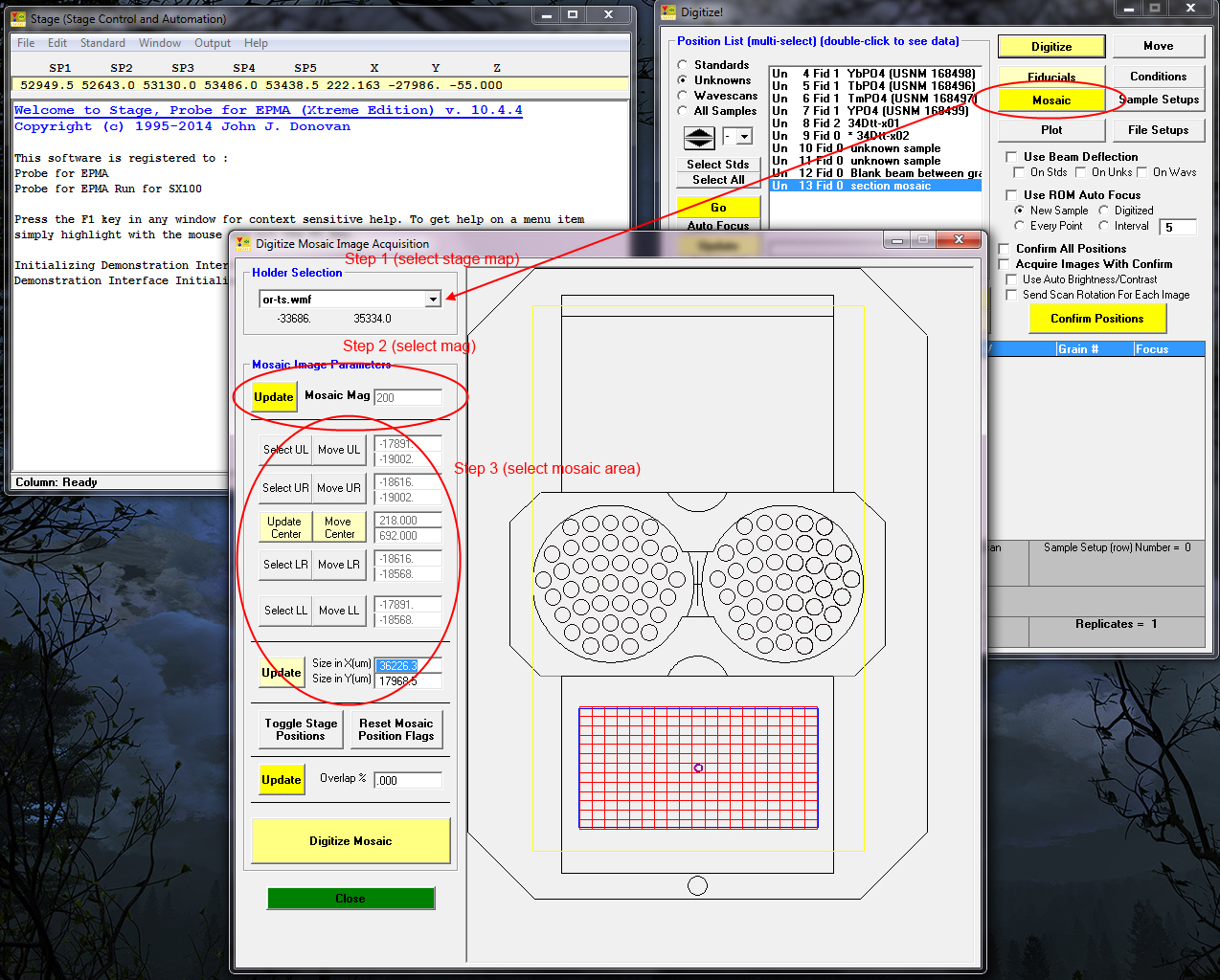

To begin, start the Stage.exe application by clicking the Stage menu in the Windows "Start" button Probe Software menu. JEOL 8230/8530 users please remember that only one application that connects to the instrument can be open at a time! Then once Stage.exe is up, click on the Mosaic button in the Digitize! window as seen here:

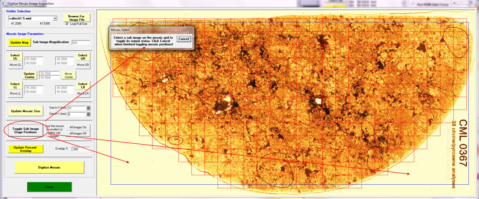

Then follow the steps to select the appropriate stage map, the mosaic magnification for the sub images and the extent of the total mosaic area as seen above. Next utilize the "toggle" tool to turn on or off specific sub images where you do not want to acquire a sub image as seen here:

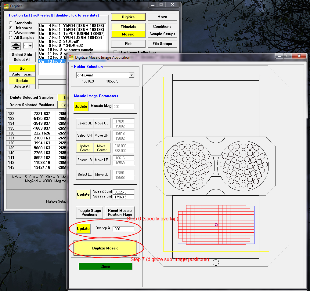

Finally specify the percent overlap and then click the Digitize Mosaic button to record the sub image positions to the position database as seen here:

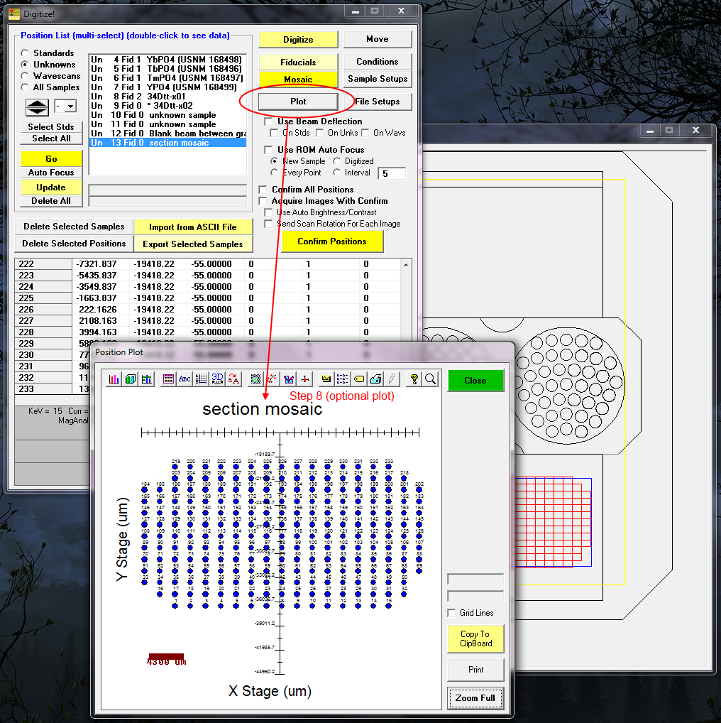

Optionally one may plot the sub image positions to confirm as seen here:
Lastly, check the Confirm All Positions In Sample and Acquire Images With Confirm checkboxes and click the Confirm Positions buttons to start the sub image acquisition. Note that auto-focus may be specified if necessary as seen here:

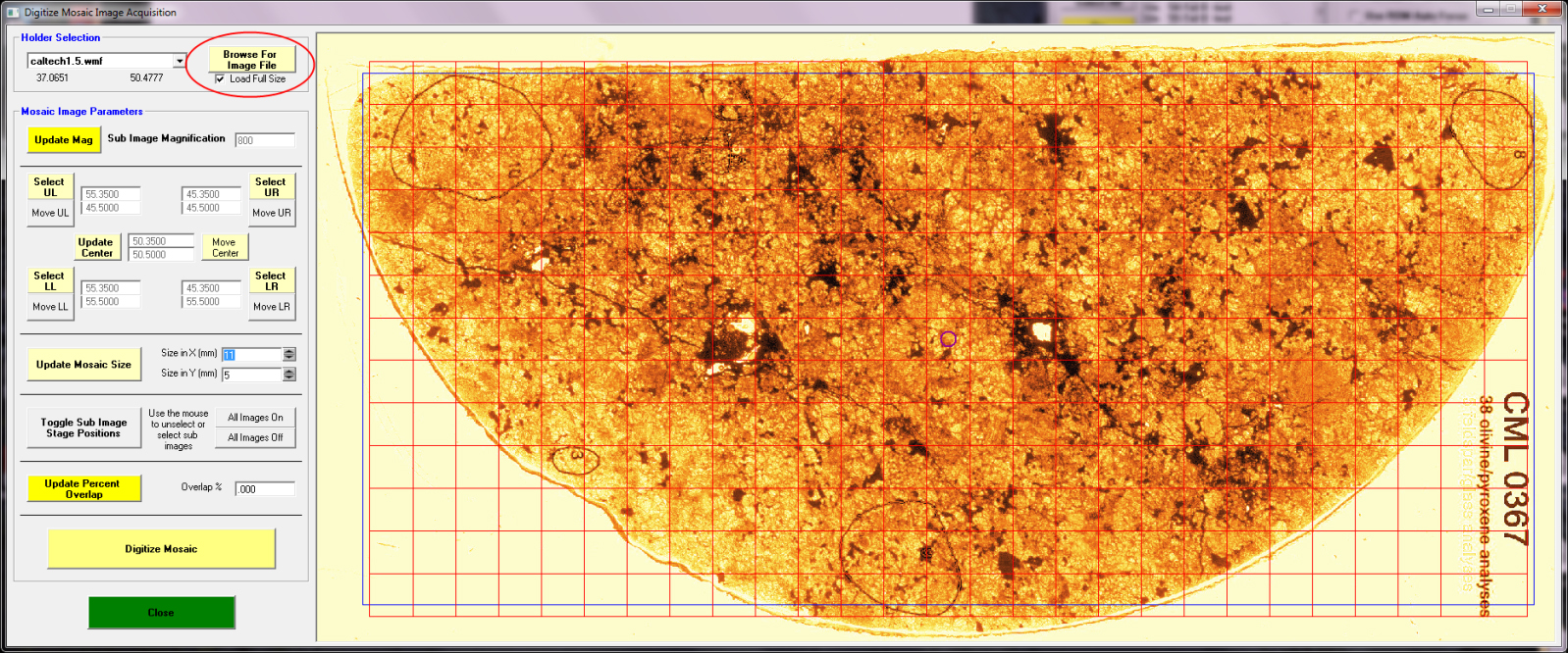

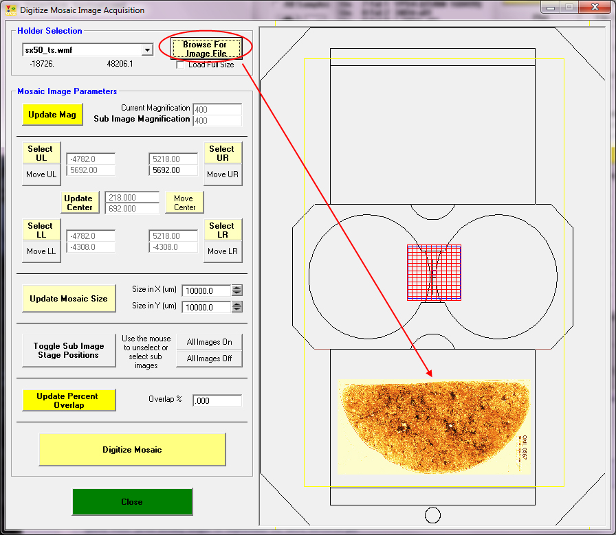

OK, I tweaked the interface some more as you will see, but the cool thing is that in addition to loading a stage map for mosaic imaging, one can now also load any calibrated image (currently just the two point calibration, soon both the 2 point and three point calibrations) from any source (e.g., a BSE image or thin section slide scanner),  for use as a "basemap" for selecting the mosaic area and the sub images using the new Browse button as seen here:
As you can see, it loads the image in the correct position and size, but now you might say, John: I can't easily see all the sub images for deselection...  ok, so now one can also load the the specified image full size using the Load Full Size checkbox as seen here:
Now it is easy to select or deselect specific sub images based on the actual sample as seen here:

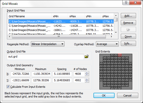

Here are the two steps (as attached images) for automatically mosaicing the GRD files acquired in Stage using the Grid | Grid Mosaic menu in Surfer...
It is nice that one can select all the files in the folder to mosaic...

When you load an image by default it is displayed on the stage map as seen here:
Then by loading the image with the Full Size checkbox checked, the mosaic area is automatically moved to the image center and the mosaic sub images are automatically resized for the areal extent of the loaded image as seen here:

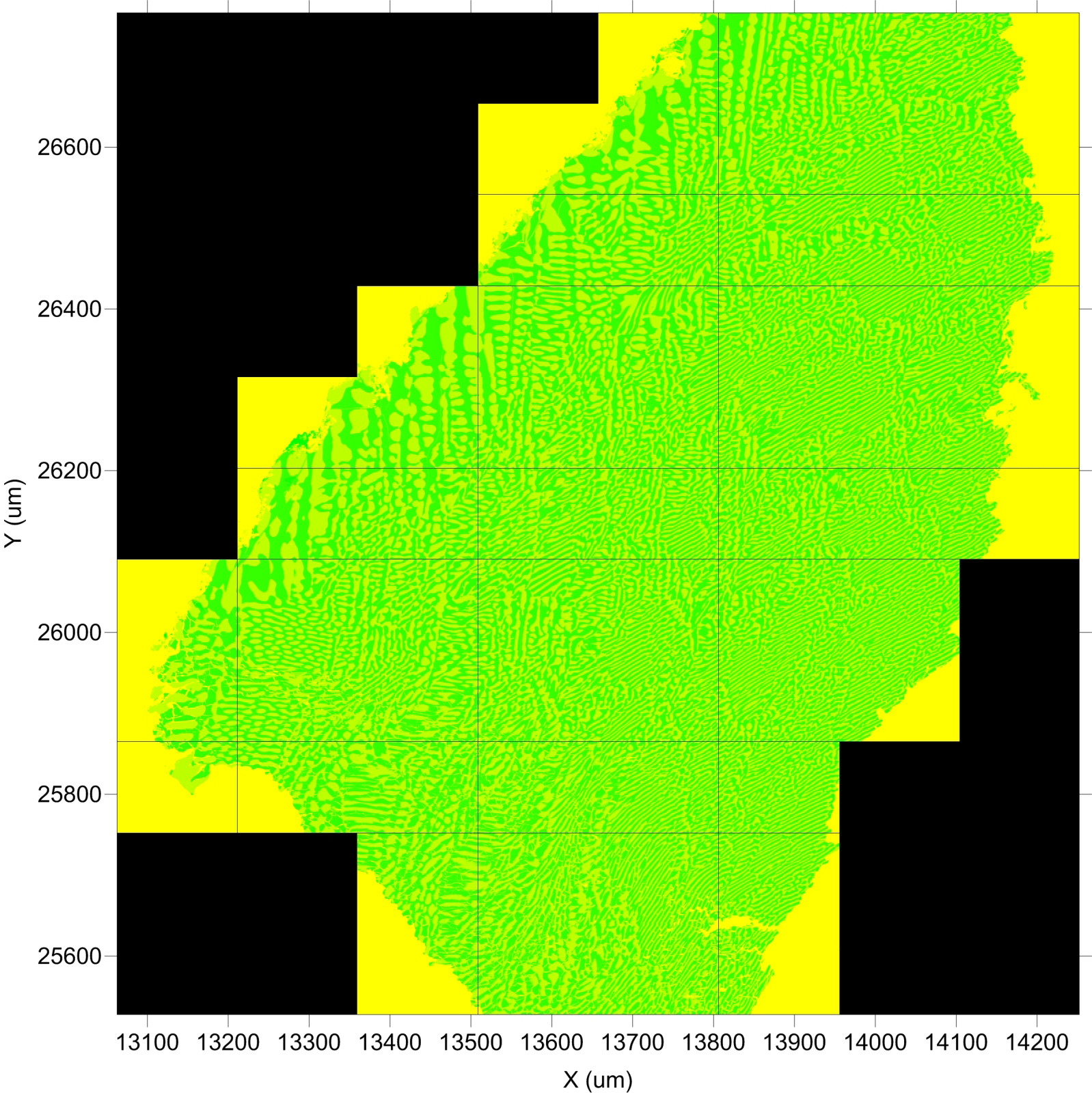

OK, here is the Surfer Grid | Mosaic menu for importing the GRD files to mosaic. I simply clicked <ctrl> a to select all GRD files (97 of them) and clicked OK. The screen shows the position of each sub image in your mosiac:
The complete mosaic performed in Surfer is attached below.

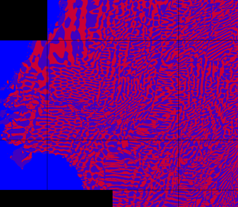

Another example I did to test the calibration with zero percent overlap at 2500x for each sub image (again extrapolated from a 400x calibration set), but this time in "school colors"!
Attached below is an example in more contrasting colors.
Remember to login to see attachments!
If one zooms in on the mosaic, it can be seen that with zero percent overlap, depending on the sub image, the pixel gaps are variously 0, 1 or 2 pixels wide:
I also can detect some "negative" pixel gaps (a kind of overlap) that might be a few pixels wide also.
However this is from a two year old beam scan calibration extrapolated from 400x to 2500x.  I will post more examples after I perform a recalibration of the magnification.
