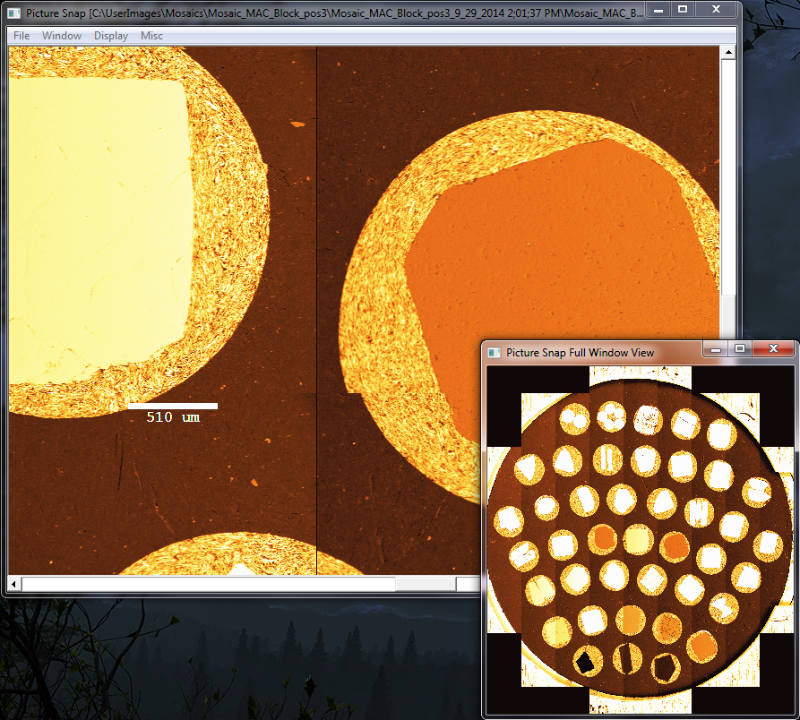

Easiest thing is to simply open the GRD file in PictureSnap.  Just use the File | Import GRD File menu and you should be good to go!
Here is an example of a Stage.exe mosaic of one of my standard blocks loaded into PictureSnap:
