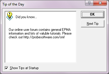

I'm starting a "Tip Of The Day" feature in PFE but would very much appreciate any one line tips that you all would care to share with everyone else.
So here is the current only (and very lonely) tip of the day:
When there are a sufficient number of tips to share I'll enable the feature!

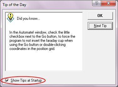

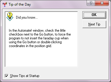

I still need more "Tip of the Day" suggestions from you all, but I've implemented this feature in PFE.
Please note that it can also be turned on or off from the Help menu.
I would very much appreciate any "one liner" factoids for the "Tip of the Day" feature as seen here:
Think of your favorite "hidden option" in PFE and email or post a suggestion for the Tip of the Day" "database" add I'll add it right away!
http://smf.probesoftware.com/index.php?topic=110.0
The latest version of Probe for EPMA (v. 13.1.2) contains a few additional "tips of the day" but we could certainly use a few more.
Please feel free to email me directly (or post them in this topic) if you have any ideas for an additional tip of the day suggestion.
This feature is enabled by default on startup, but if turned off, can be accessed from the Help menu at any time...
