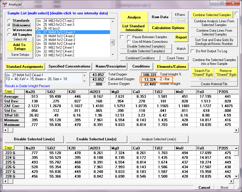

#50
Hi Ery,
I just realized that you can see the calculated Z-bar or average Z in two places in Probe for EPMA. First here in the log window output:
Un   27 MAM IW2 C4-ext-1
TakeOff = 40.0  KiloVolt = 15.0  Beam Current = 20.0  Beam Size =   10
(Magnification (analytical) =   8000),        Beam Mode = Analog  Spot
(Magnification (default) =     1267, Magnification (imaging) =   1267)
Number of Data Lines:   6             Number of 'Good' Data Lines:   6
First/Last Date-Time: 03/13/2007 06:29:57 PM to 03/13/2007 06:49:54 PM
WARNING- Using Exponential Off-Peak correction for p ka
WARNING- Using Time Dependent Intensity (TDI) Element Correction
Average Total Oxygen:       43.852     Average Total Weight%:  100.331
Average Calculated Oxygen:  43.852     Average Atomic Number:   13.324
Average Excess Oxygen:        .000     Average Atomic Weight:   22.489
Average ZAF Iteration:        3.00     Average Quant Iterate:     3.00
Oxygen Calculated by Cation Stoichiometry and Included in the Matrix Correction
And also here in the Analyze! window:
The average Z value will change visibly as the specified concentrations or elements by difference are modified.

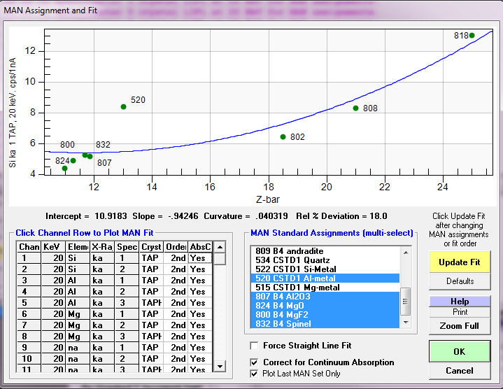

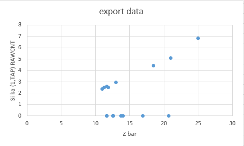

#52
I think I missing something obvious - but using the custom output #8 (MAN) - what's the difference in units for intensity - I can't get them to match.
The intensity scale is difference. But if I divide rawcnt by seconds and nA it does not help (e.g. 8/10sec/20nA).
Also 520 Al-metal looks different
The difference is that the raw MAN intensities output to a file are *not* corrected for continuum absorption, but the intensities in the MAN plot are corrected for continuum absorption.
Try comparing the raw intensities to the raw plot, by unchecking the Correct for Continuum Absorption checkbox.
That doesn't mean that I have gotten something mixed up somewhere!    :D

Quote from: John Donovan on April 10, 2017, 08:49:59 AM
Thanks  - that makes sense - and was it!

Is there an option to output the intercept, slope, curvature, Rel % Deviation for the MAN fits for all the elements in a run, and maybe even which standards are being used?  Playing around with different standards, off peak positions, forcing straight line versus not, etc.  Be nice to have these values easily tabulated.
#59
Quote from: Heather Lowers on August 01, 2017, 08:17:57 AM
Currently these parameters are output from the Output | Save Custom Analysis Output | Save Custom Analysis Format #8 (MAN):
