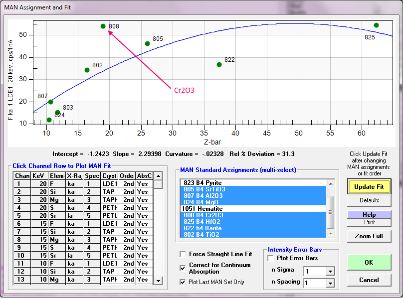

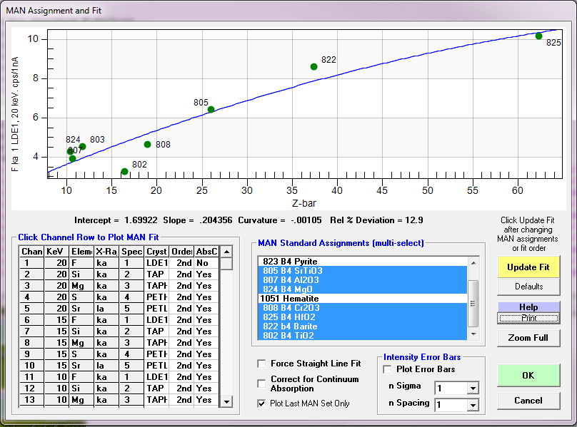

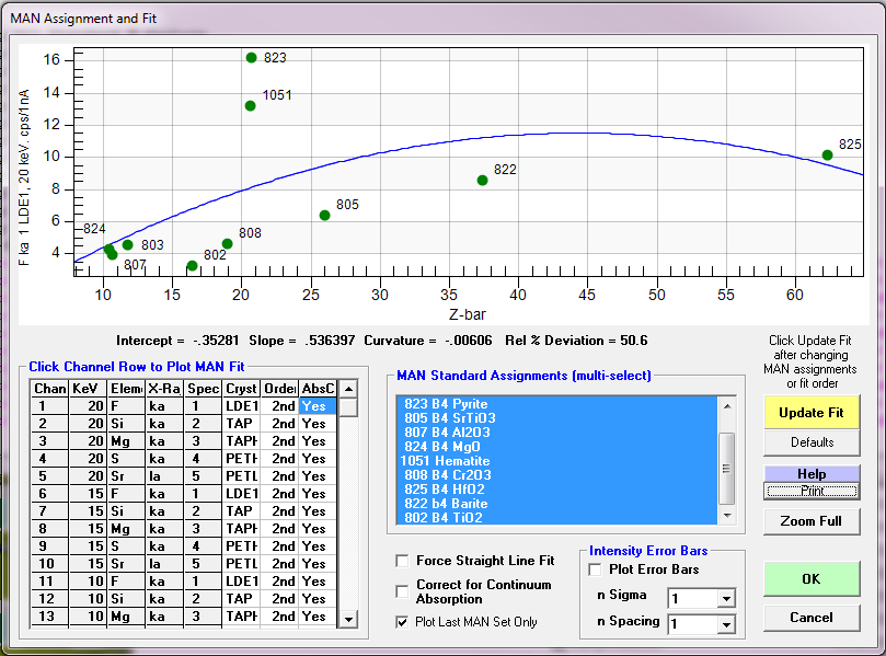

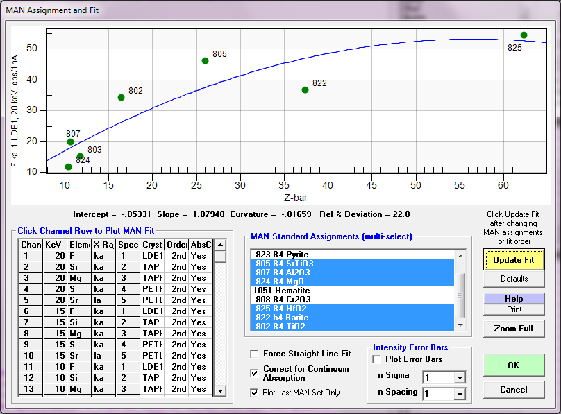

I was just doing MAN for fluorine, clearly a tricky element, it seems to work better without correction for continuum absorption
With absorption correction TiO2, SrTiO3, Cr2O3 plot much higher compared to Barite and HfO2

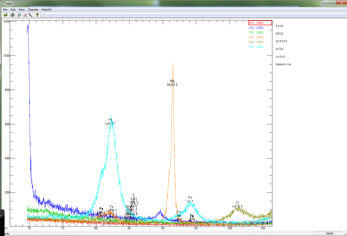

In the second image, only those standards containing Fe lie significantly above the curve - due to Fe La interference (see wavescan below). giving following.
Removed Fe standards - TiO2 disappointingly low
Yes, I've seen this too.
Because there are so many elements (e.g., L lines) that interfere with fluorine, it is difficult to find a decent set of MAN standards that will work. I generally use the off-peak method for minor/trace fluorine.
An unrelated issue for oxygen is that almost any standard one could utilize for the oxygen MAN curve is oxidized. I have tried MAN calibrations for oxygen using Ge and Au, but haven't found an MAN standard useful at low Z.
#64
Also, on the issue of the low intensity for F Ka in TiO2, note that the MAC for F ka in Ti is quite large, around 14500 (actually that is for F Ka in pure Ti. In TiO2 the MAC is more like 13700).
So by not utilizing the continuum correction in the MAN curve you are significantly undercorrecting the F Ka intensity in TiO2.
Here is your F Ka MAN calibration curve at 20 keV (F Ka at 20 keV?), with the continuum absorption correction and with  the Fe bearing standards removed. As you point out there are some on-peak interferences from Fe L lines on the F Ka peak position.  So removing those gives us this:
The high outlier is Cr2O3 and I would suspect a small interference from Cr L also (as I tell my students, if you have a high outlier in the MAN curve it is usually an interference or contamination- so just remove it from the fit- after all background is by definition the lowest thing we can measure).  So now we get this curve:
It's not a terrible fit, but it is worth noting (as you did) that without the absorption correction the fit is better, but the TiO2 is way low as one would expect from the MAC.  It might be worth looking at a wavescan of F ka on your barite standard and see if there is anything unusual in the background shape.

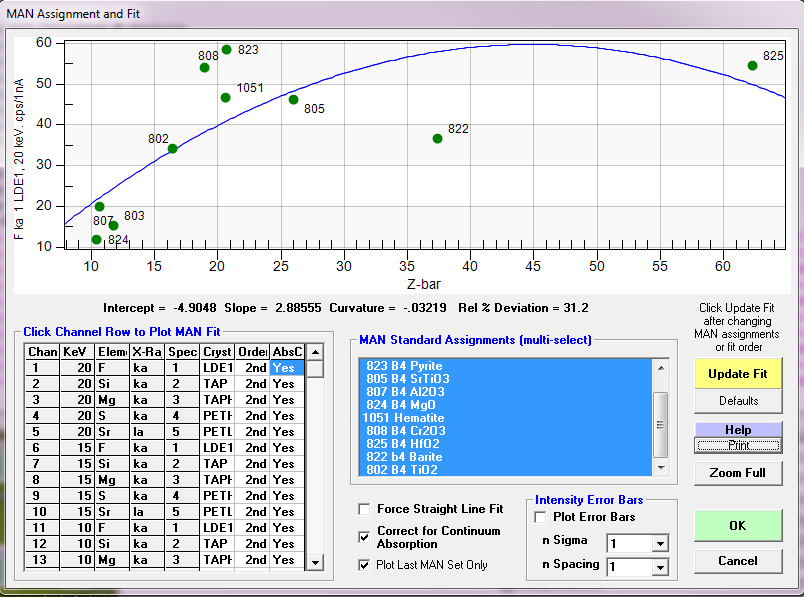

Hi all
Following on from Ben's data, I have collected a bit more data for F on PC0 and TAP xtals, and attached images of the MAN fits on PC0 and TAP with/without continuum correction. I think at least on my setup, I arguably get a better fit with absorption correction (esp. in the specific higher Z stds I am using).
Interestingly for both PC0 and LTAP, std 559 (TiO2) sits above the plot with continuum absorption correction ON, much like your data. As per the database there is a 6th/7th order overlap of Ti on F for PC0...buts its so miniscule and high order that it has to be inconsequential? There is no reported overlap for Ti on F for TAP?
On PC0, when the absorption correction is removed, the point sits far below the fitted line. Conversely on LTAP when absorption correction is removed the point sits in line with other data.
Any thoughts..?
It has to be an interference from Ti L or oxygen K. Anyone have a high precision scan of F Ka in TiO2 handy?
