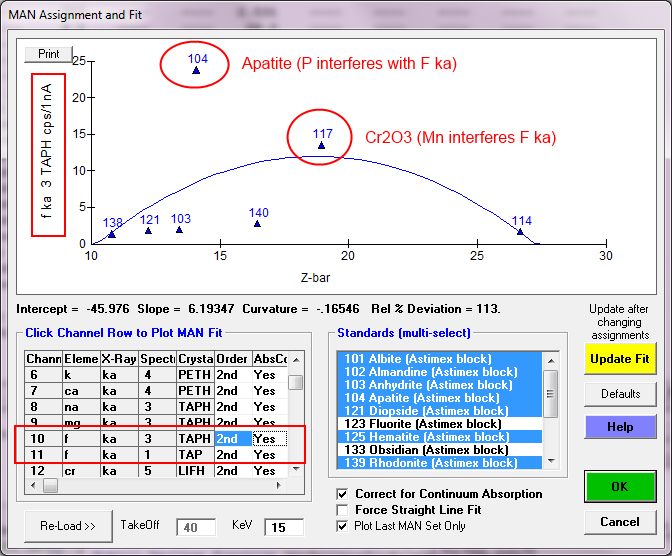

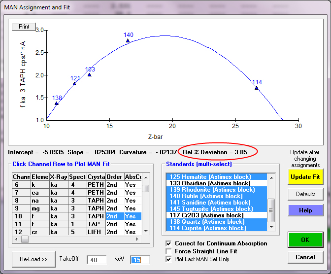

I cannot over emphasize the importance of properly fitting one's standards for the MAN background fits.
The basic "rule of thumb" (and it is merely a "rule of thumb" so there are exceptions!), is that since we are trying to characterize the continuum as a function of average atomic number, and background is, by definition, generally the lowest intensity we can measure, then any standard which plots "above" the fit as seen here, is a good candidate to <ctrl> click to unselect and update the MAN fit:
In the above case, two standards that both do not contain fluorine, are seen to give an elevated background, why? Because P and Cr both interfere quite well with F ka...
In other situations one might actually find that they have a trace element contamination in their standard that they were not aware of (Probe for EPMA automatically deselects all standards that contain any of the element of interest in the MAN fitting) and therefore that standard will also plot "above" the general trend. Therefore "contaminated" standards should also be deselected and the fit updated similarly as we did with the above apatite and Cr2O3 standards which interfere with F ka.
In practice you do not have to know exactly why a particular standard intensity plots above the general trend of continuum intensities, just unselect and re-fit. Though as is often the case, the physics details might be interesting!
For example, why does the copper standard intensity cause the intensity to "curve over" and decrease?  Because in higher average atomic number materials, the self absorption in the material, for low energy x-rays such as fluorine, is increasing faster than the increase in continuum production due to the slowing down of the primary electrons.

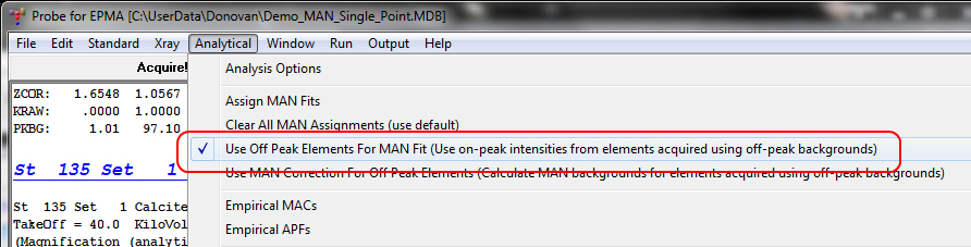

One possibility is that because of the standard intensity drift correction feature, the program will scan for all undeleted standards and try to load them for the drift interpolation.
So double check that all MAN standards are deleted and try again.  You can also clear the MAN assignments but that shouldn't be necessary.
I also assume the Analytical | Use Off-Peaks For MAN Fits menu is unchecked?

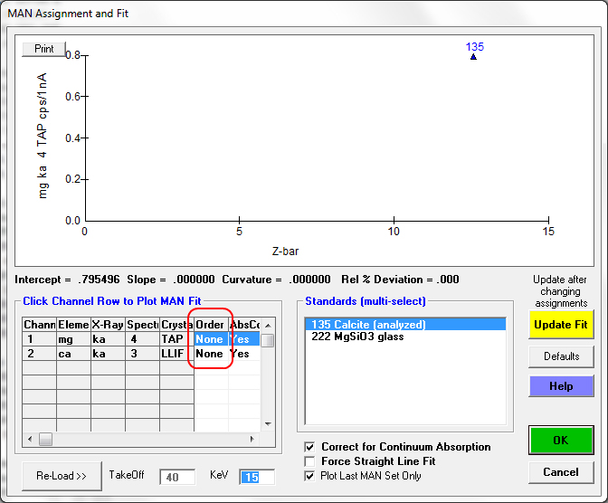

Basically you want to do an MAN background calibration curve using a single point... which assumes of course that you have a constant composition (or at least a constant average Z which is essentially the same). However, as you point out, for major elements the background (if it is smaller than the measurement precision) can be ignored, or at least roughly approximated.
So here's an example of what to do if you wanted to say x-ray map (or point analyze) Ca and Mg on say dolomites that are (roughly) constant in composition. By the way, to include CO3 in the matrix calculation by various methods, see this topic:
http://smf.probesoftware.com/index.php?topic=92.0

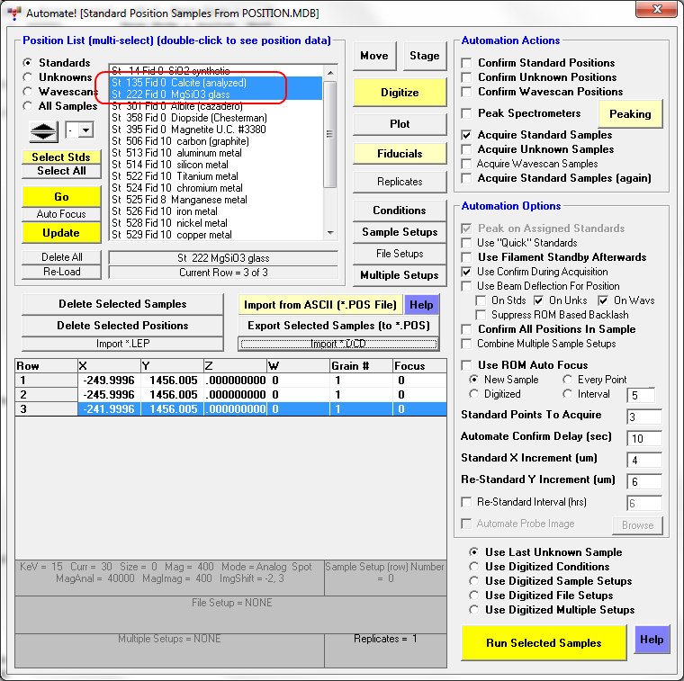

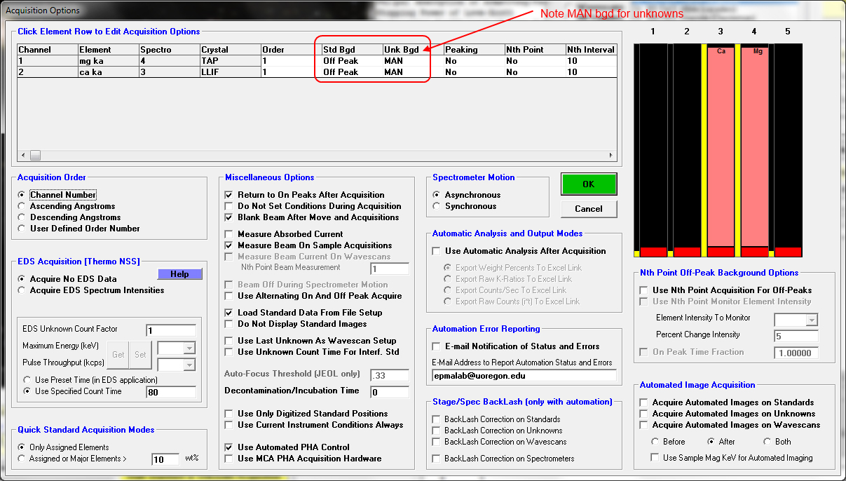

Let's start with adding Ca and Mg to a spectrometer and then go to the Acquisition Options dialog as seen here and specify that the standard acquisition use off-peak backgrounds but the unknowns (your dolomite point analyses or maps) use the MAN background. Here is the Acquisition Options dialog:
This gets more important as one starts to add additional elements to analyze for, but then one will have multiple standards that *do not* contain the element of interest and can therefore be utilized in the MAN calibration for variation in average Z!
Next we select our standard positions and run them:
Once the standards are acquired we can analyze them as unknowns because we utilized off-peak backgrounds as seen here:

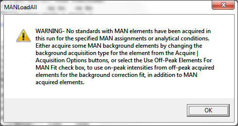

Now we go to assign the MAN background for our unknowns using the Analytical menu as seen here:
But whoa, we now get this error message:
Why? Because our standards were acquired using off-peak backgrounds and so the program ignores the off-peak standards by default for the MAN calibration. So we can change that default by clicking this menu in the same Analytical menu as seen here:

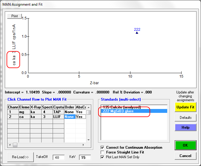

Now we click the Analytical | Assign MAN Fits menu again and now we see this for the first element Mg:
and this for Ca:
Yes, we're only using a single point for each MAN calibration curve so it is a constant background intensity for that element, but depending on what standard you pick you'll get a reasonable background estimate for major and maybe even minor elements.  Or you could just acquire one or two more darn standards and get a proper slope for your MAN calibration curves!

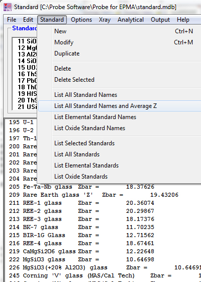

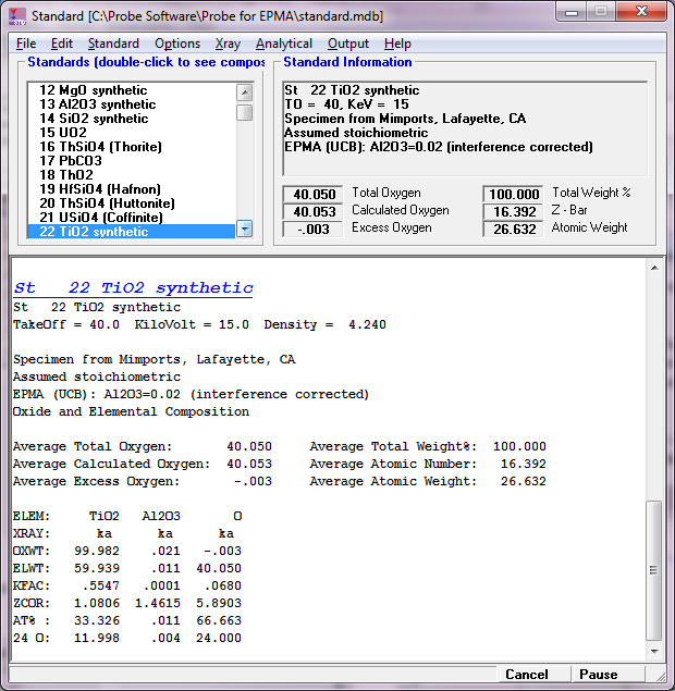

Helpful hint: if you aren't sure which of your standards might have similar average Z values compared to your unknowns, you can use this handy menu the the Standard.exe app as seen here:
Quote from: John Donovan on April 03, 2014, 11:41:34 AM
For example, why does the copper standard intensity [cuprite #114] cause the intensity to "curve over" and decrease?  Because in higher average atomic number materials, the self absorption in the material, for low energy x-rays such as fluorine, is increasing faster than the increase in continuum production due to the slowing down of the primary electrons.

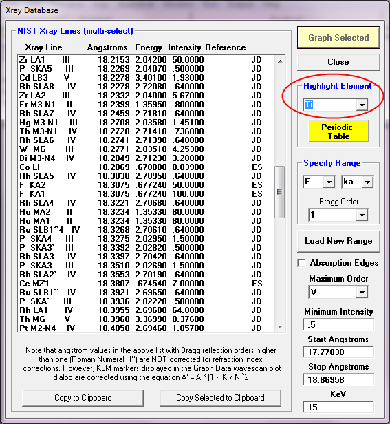

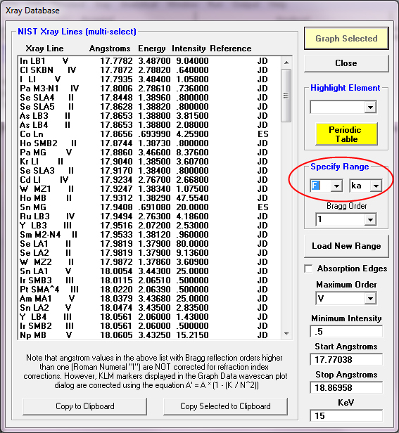

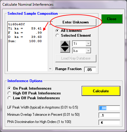

After seeing the plot above some might ask, why stop there?  Maybe the std 140 (Rutile) is also either contaminated with fluorine (unlikely I'm guessing) or perhaps the Ti La line slightly interferes with the F Ka line? After consideration of the fact that Ti L emission overlaps *strongly* with N ka, we might guess that perhaps the tail of a Ti L emission line could cause a slight interference for F Ka?

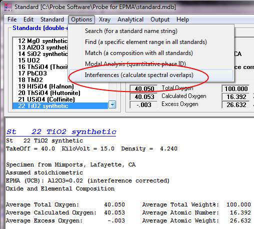

The easiest way to try and answer this question is by examining an x-ray database such as the NIST 2005 database in PFE available from the Xray | Xray Database menu as seen here:
Note that the wavelength range was specified by entering F Ka in the Specify Range controls as seen above. Now to see if any Ti emission lines could in principle, interfere with the F Ka line, we can select an element to highlight, in the case Ti, by using the Highlight Element control as seen here:

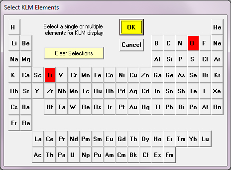

Or one can select multiple emitters by clicking the Periodic Table button and using the periodic table dialog as seen here:

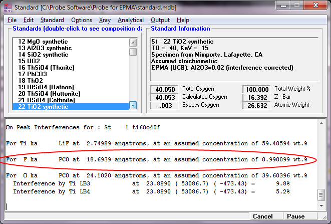

In either case no Ti lines are found near the analytical emission line for fluorine.  Another method which can provide a nominal estimate of the possible overlaps is by using the Options | Interferences menu in the Standard.exe app. Begin by selecting a the potentially problematic Ti standard or another similar standard such as synthetic TiO2 as seen here:
This will cause the following window to open with the TiO2 composition loaded automatically as seen here:
Now, using the Unknown button, add a small amount of fluorine to the material because the software only check for elements in the material as seen here:
Finally, click the Calculate button to checking for overlaps where as we can see here, nothing is reported for F Ka:
