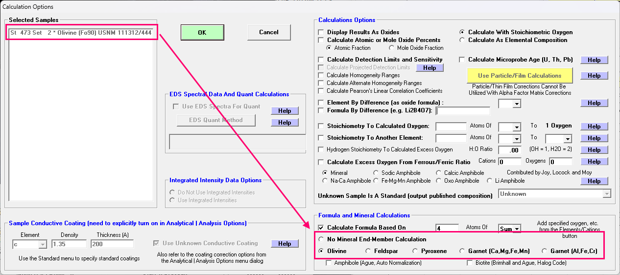

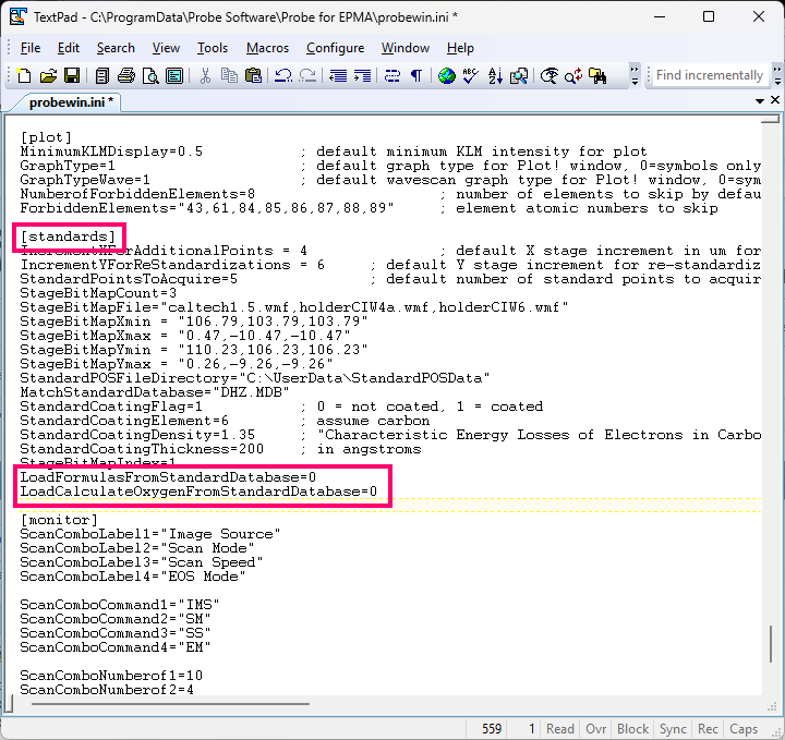

Last week Paul Carpenter had another great idea. He requested an extended version of an existing feature, where one can specify the oxygen by stoichiometry and formula basis for ones standard materials in the Standard compositional database. Then these optional parameters can be utilized in Probe for EPMA whenever a new standard sample is created.
This was accomplished using these keywords in the Probewin.ini file:
and first posted about to the forum back in 2018:
https://smf.probesoftware.com/index.php?topic=40.msg7004#msg7004

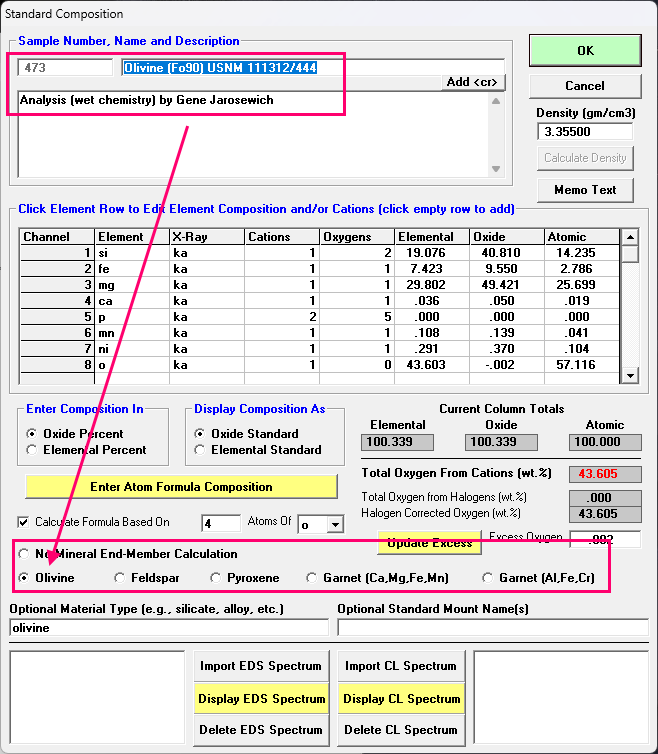

Now Paul requested that the same feature be implemented for mineral end member assignments. So here is the new standard database dialog for specify the mineral end member for standards in the standard database:
This is now available in v. 14.3.7 of Probe for EPMA. Update as usual from the Help menu or the Probe Software Resource web page.

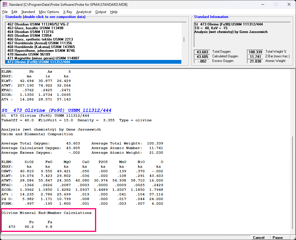

Note that you must first specify a formula basis for this feature, just as you do in Probe for EPMA. Once you've done that, select the mineral end member option and you will obtain an end member output:

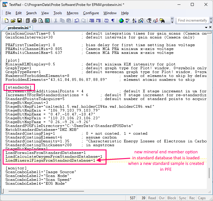

To utilize these end member options when creating new standard samples in Probe for EPMA, use this new keyword in the [standards] section of the probewin.ini file:
Once this keyword is set, every time you create a new sample (manually or automated), Probe for EPMA will automatically load the end member option for that standard:
