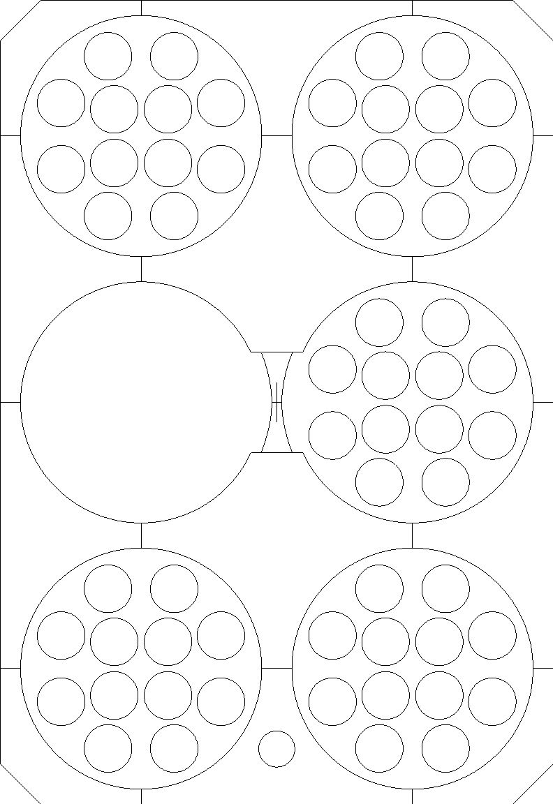

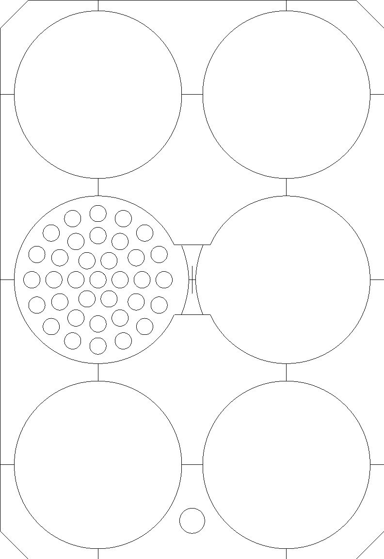

The StageMap window in PFE and other PS apps, can contain a large number of alternative stage map images for navigating your sample stage. Depending on your sample block you might want to use one image that shows your standard positions, such as this one in use in my lab:

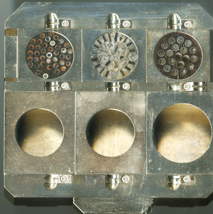

On the other hand, some labs prefer a high resolution scan such as this image from Cal Tech:
On the other hand some labs require some customized holders such as this one our machine shop made for us:

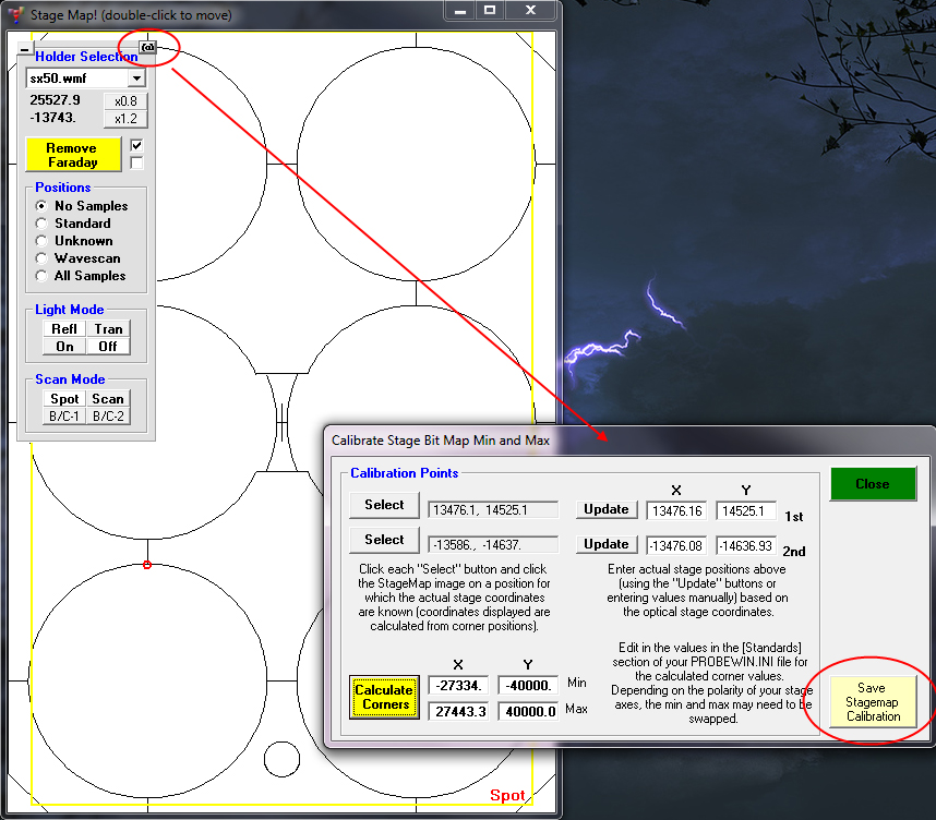

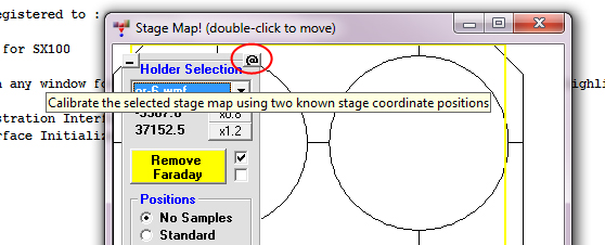

Currently one must edit the Probewin.ini file to add a new StageMap file and calibrate it. This editing and calibration process is roughly documented documented in the User Reference manual, but we will post a simple tutorial on this process soon... but the stage map calibration is easily performed using the "@" button in the StageMap window as seen here:

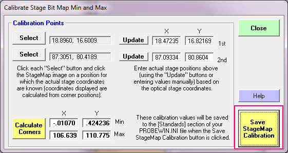

I've improved the StageMap calibration feature so the software can now automatically save your calibrations to the Probewin.ini file using the new "Save StageMap Calibration" button see here:
Works for both JEOL and Cameca stage maps images.

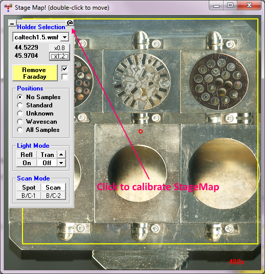

This is an old topic, but while I'm thinking about image calibrations, I should also point out that the StageMap calibration process is very similar to the image calibration process. Both require two points and are automatically saved by clicking the Save... buttons in their respective windows as seen here:
This window has been slightly modified recently:

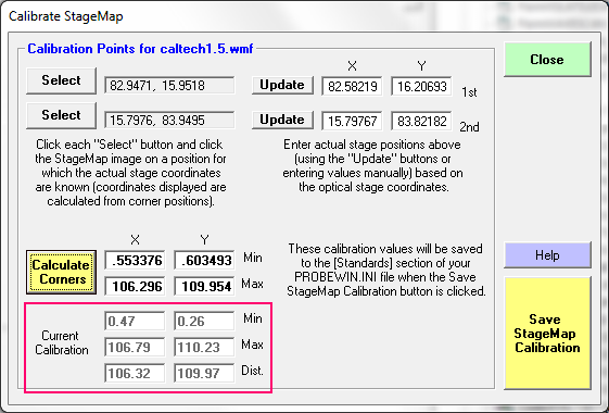

I also modified the StageMap calibration window to display the calibration for the currently selected StageMap as seen here:
Again, this is a comfort to me when tuning the calibration of the StageMap image...
