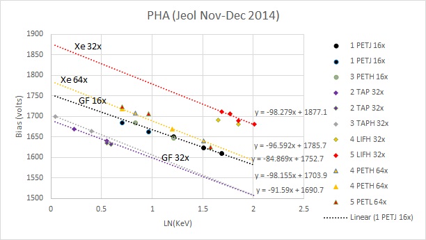

So I finally decided to do Paul Carpenter's suggestion of emprical curves (e.g. http://epmalab.uoregon.edu/Workshop2/Carpenter_Oregon_Workshop_2007.pdf) to determine the bias for any elements. As such I just plotted up PHA data collected in the last month or so
Figure attached
Giving me the empirical equations to calculate bias for any element and enter into PFE. The trick is energy is plotted as natural log to give striaght line.

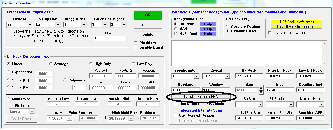

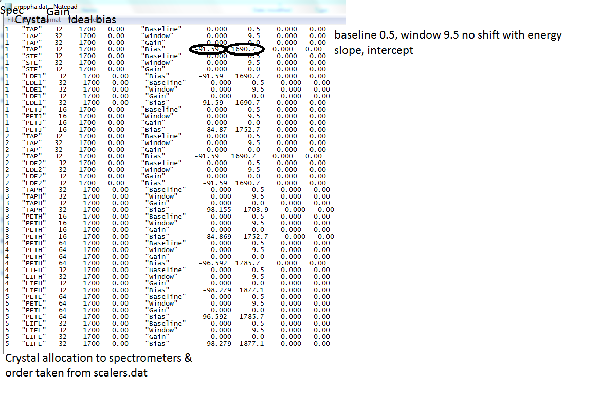

As covered in probewin manual you can then set up an empircal correction. Entering the intercept and slope for each spectrometer/bias/crystal into emppha.dat
Then when adding elments you can click calculate empirical pha - it will calculate it where intercepts and slopes have been added for that spectrometer, crystal & bias - check using desired bias before clicking
In probewin.ini can set UseEmpiricalPHADefaults=1
