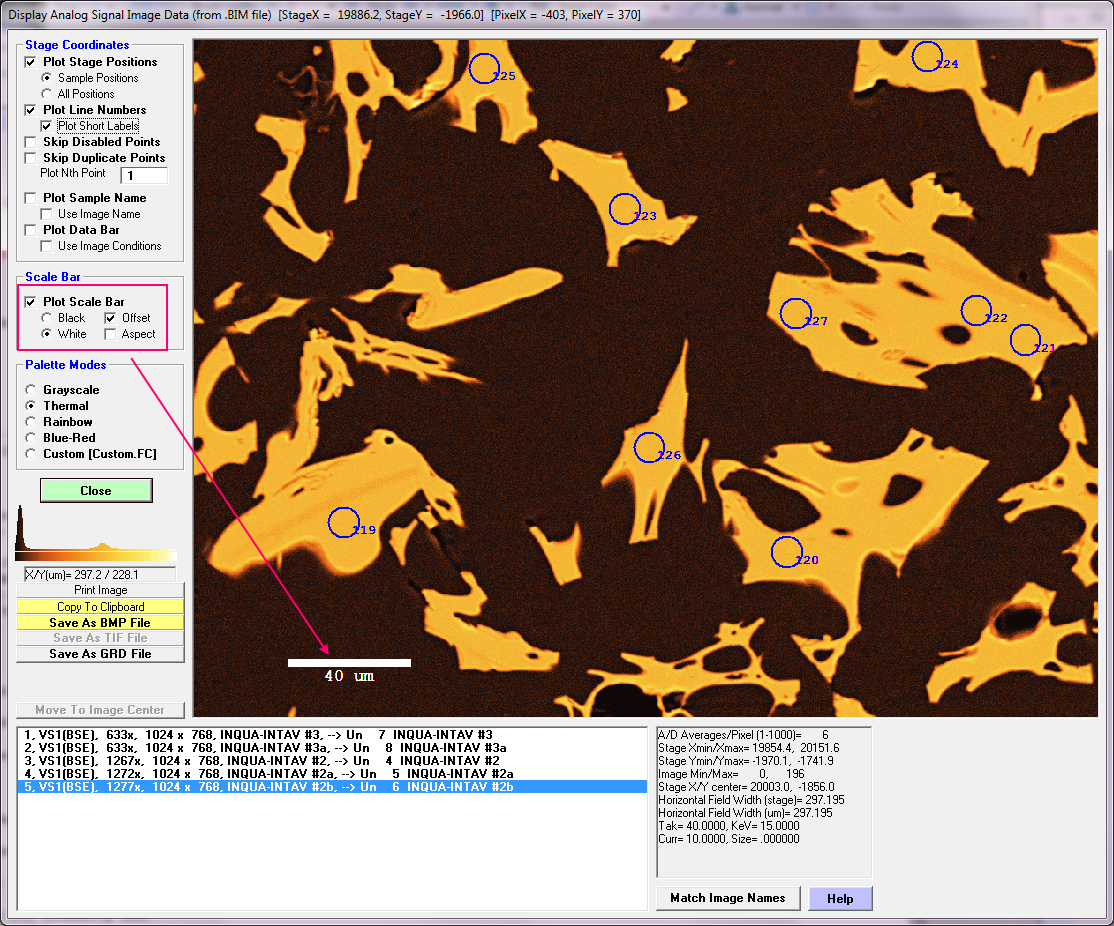

Someone recently asked about adding a scale bar to an already acquired image. Just use the Run | Display, Annotate and Export Analog Signal Image menu dialog as seen here:
#20

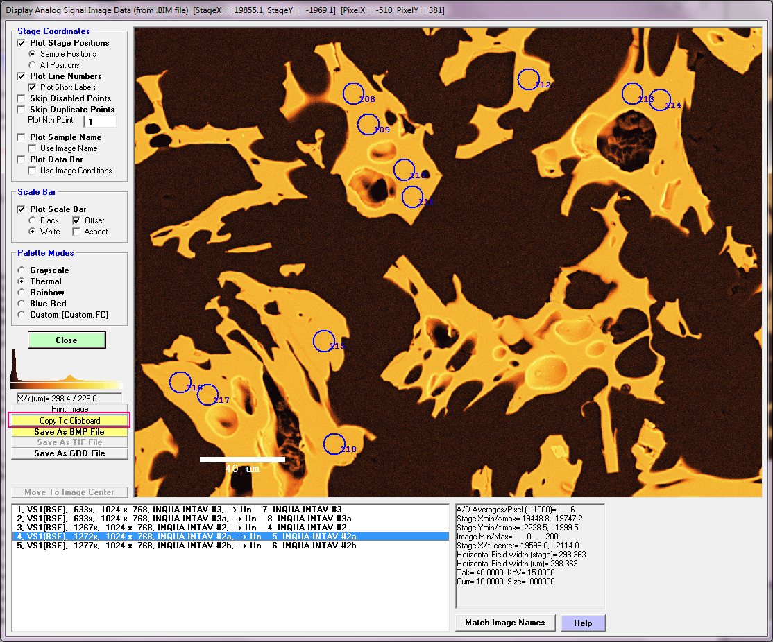

And if you want to save the displayed image with a scale bar, point labels, etc. just use the save To Clipboard button as seen here:
Then paste it into any imaging app and then save it to any image format you prefer.

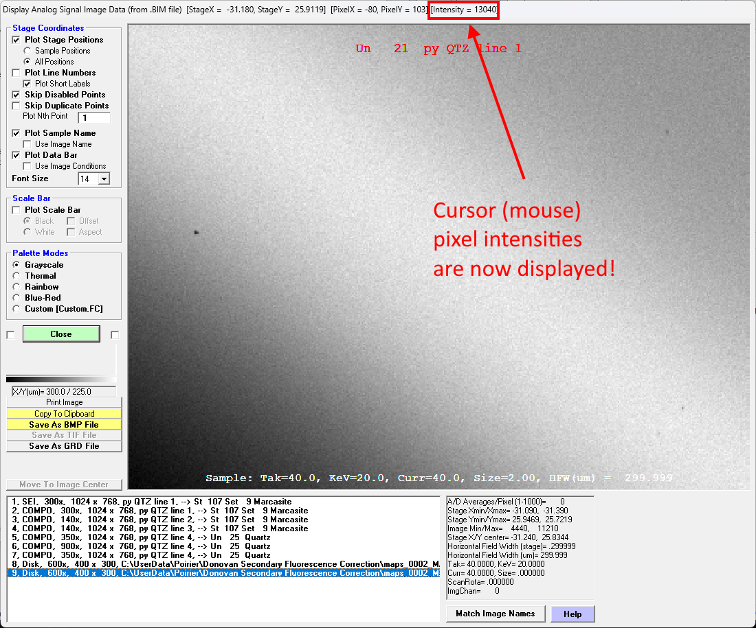

We recently add the pixel intensity value to the cursor:
This was done to help us calibrate the WDS Bragg defocus correction here:
https://smf.probesoftware.com/index.php?topic=1545.msg13246#msg13246
But maybe someone else will find another use for this new feature!
