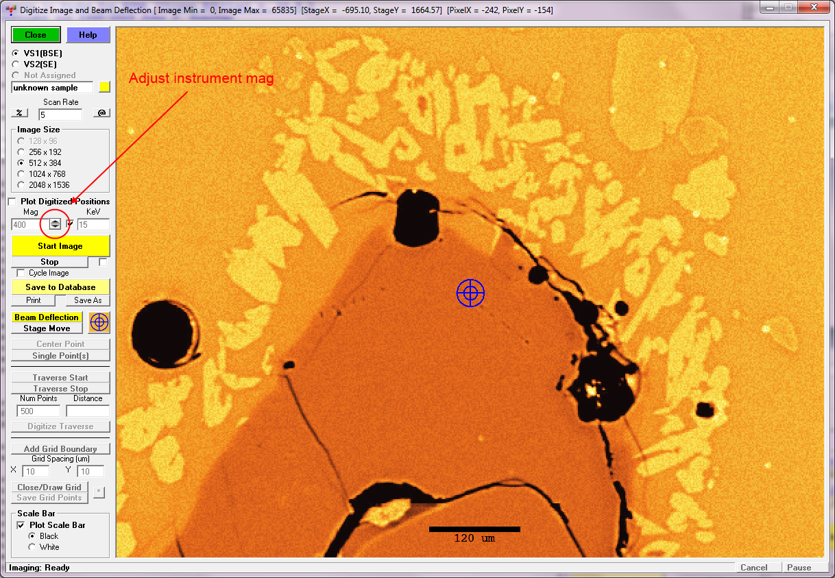

OK, so it appears everyone wants the scale bar to be fixed to the image acquisition mag, but in looking at the code, it appears that that is already the case.
I cleaned up a few things but basically the scale bar is based on the image stage extents so it is not affected by the current instrument mag, so I'm not sure what Ken Severin is concerned about.
Anyway, the latest version of PFE has a few nice improvements in the Imaging and Digitize Image windows. For example, the spin button next to the current instrument mag display is now clickable and adjusts the instrument mag up and down as seen here:
