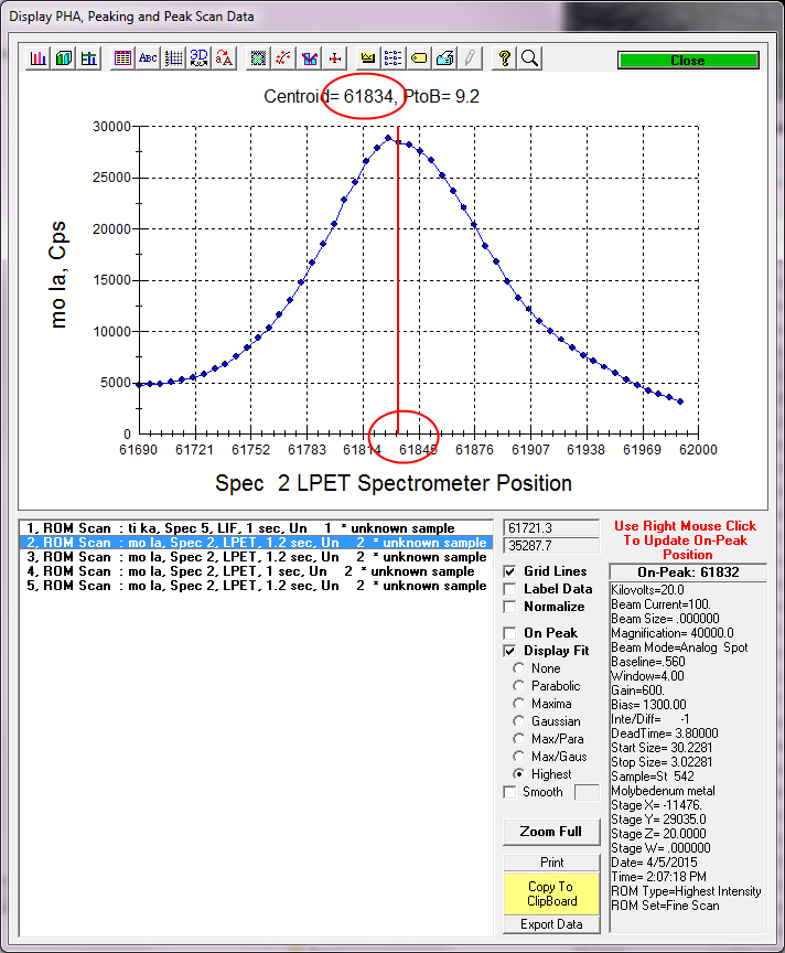

1. I acquired a peak scan for Mo La on Mo metal (20 keV, 100 nA) and get 68834 as the peak center as seen here:

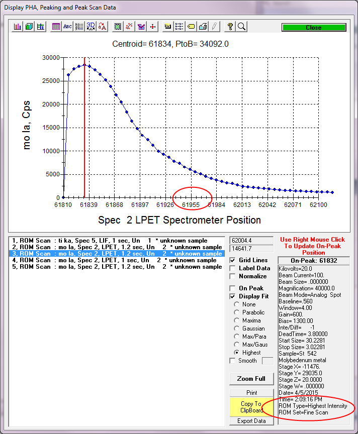

2. I then detuned the spectrometer by specifying a peak center of 61960 and ran a peak center. The fine scan ran like this:

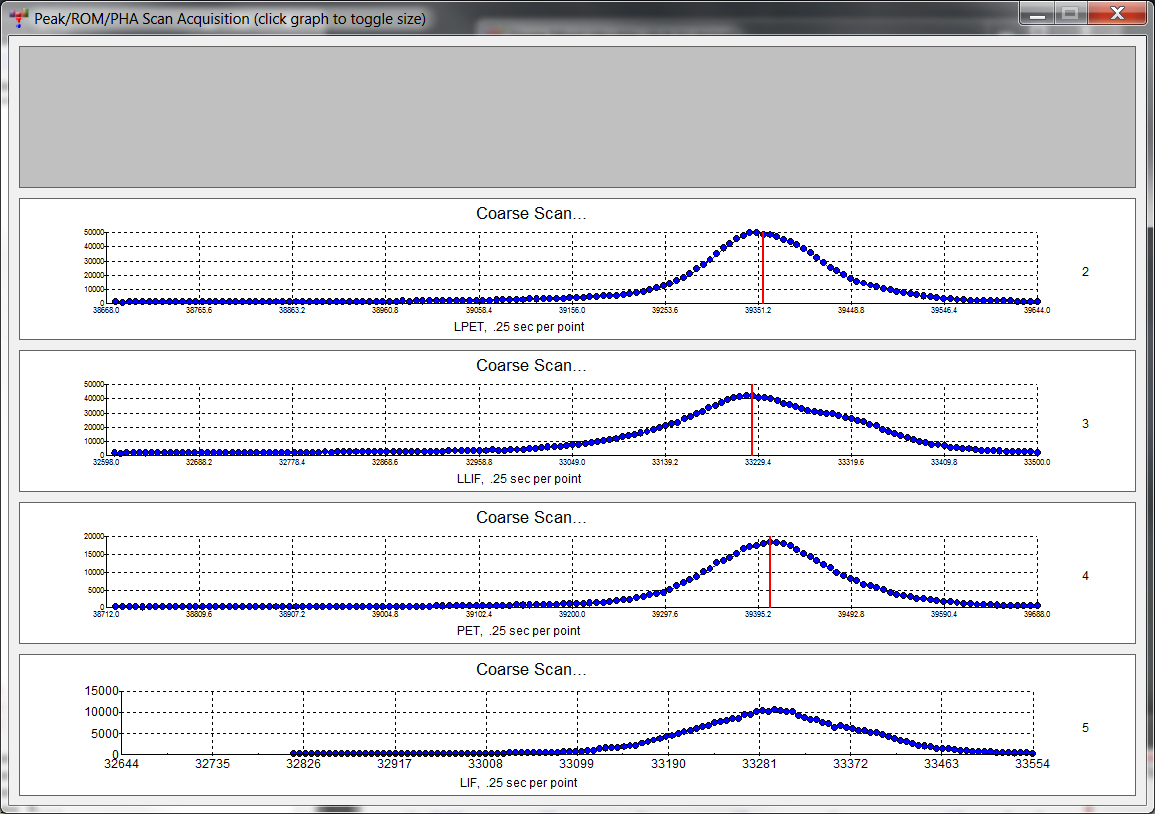

3. The fine scan failed (too close to edge of scan), so it automatically ran a coarse scan as seen here:

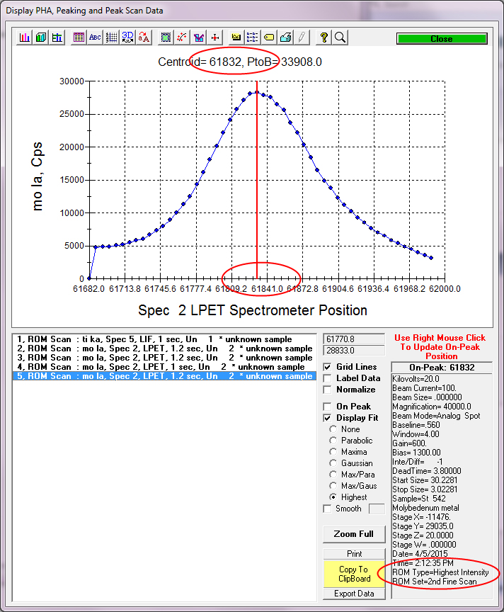

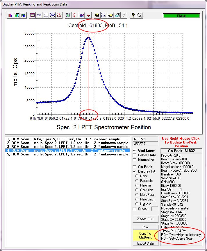

4. Note that it found the proper peak center of 61833. The 2nd fine scan then ran automatically as seen here:

Just to be sure I ran a test this time on 4 spectrometers and setting the on-peak positions to a large offset on the low side and here is the coarse scan:

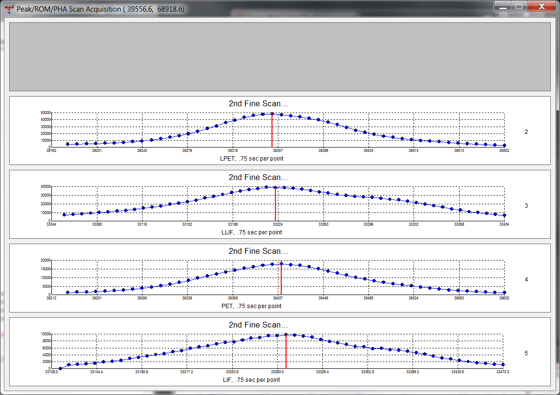

The 2nd fine scan then ran properly as seen here on our SX100:
