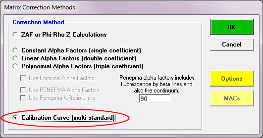

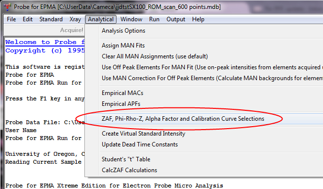

Once you've acquired your calibration standards (using off-peaks or not, just be self consistent), select the matrix correction methods dialog from the Analytical menu as seen here:
Then select this option here:

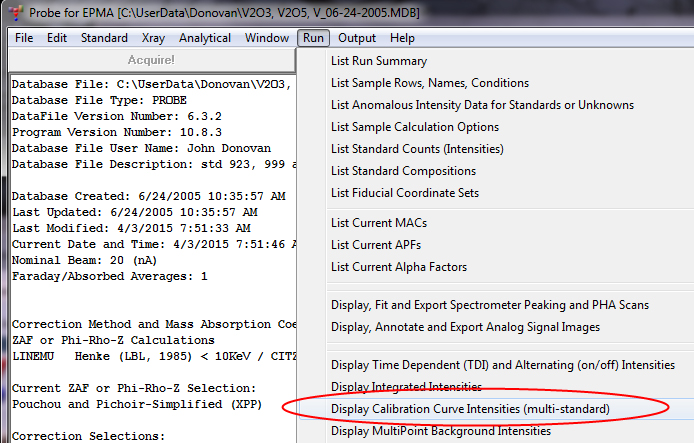

You can graphically plot your standard calibration along with the interpolated unknown calculated background from the Run | Display Calibration Curve Intensities menu as seen here:

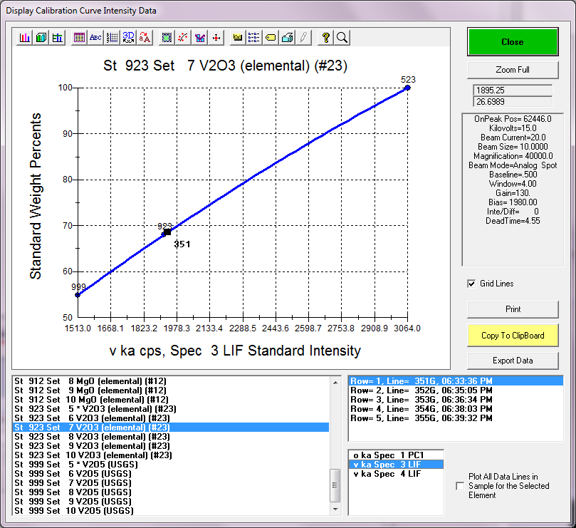

Here's an example (not really intended for a calibration curve but you get the idea):
