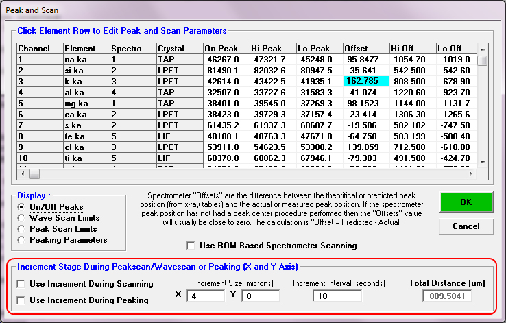

Yes, the stage stepping option for wavescans as seen here:
...was designed for sulfur peak shift measurements for determining chemical oxidation state.  The problem is that if one leaves the beam too long on an alkali glass, the trace sulfur will begin to oxidize, compromising the peak shift characterization...
But I do understand your point, so try the Alternating on/off Peak method.  This tracks the net intensity over time.
And if the sample really is homogeneous, why not just defocus the beam?

Quote from: John Donovan on April 03, 2015, 06:54:21 PM
Quote from: JohnF on April 03, 2015, 06:17:02 PMWorking with FE probe means a much more intense beam, so there is (or should be) a certain amount of experimentation. Certainly TDI is one useful tool. Another useful tool would be the ability to jog the stage (or continuously move it) while counting either as a standard or an unknown (clearly on a homogeneous material). In PfE there is a clear ability to do this with wavescans. However, I do not see it for unknown or standard acquisitions. Is it there somewhere, where I just don't see it? Or it not there, it would be a useful addition to the PfE toolkit.
Someone recently asked about moving the stage during a sample acquisition and we found that the above screen shot is slightly out of date.  Here is a more recent screen shot which allows the stage to be incremented during unknown acquisitions:
