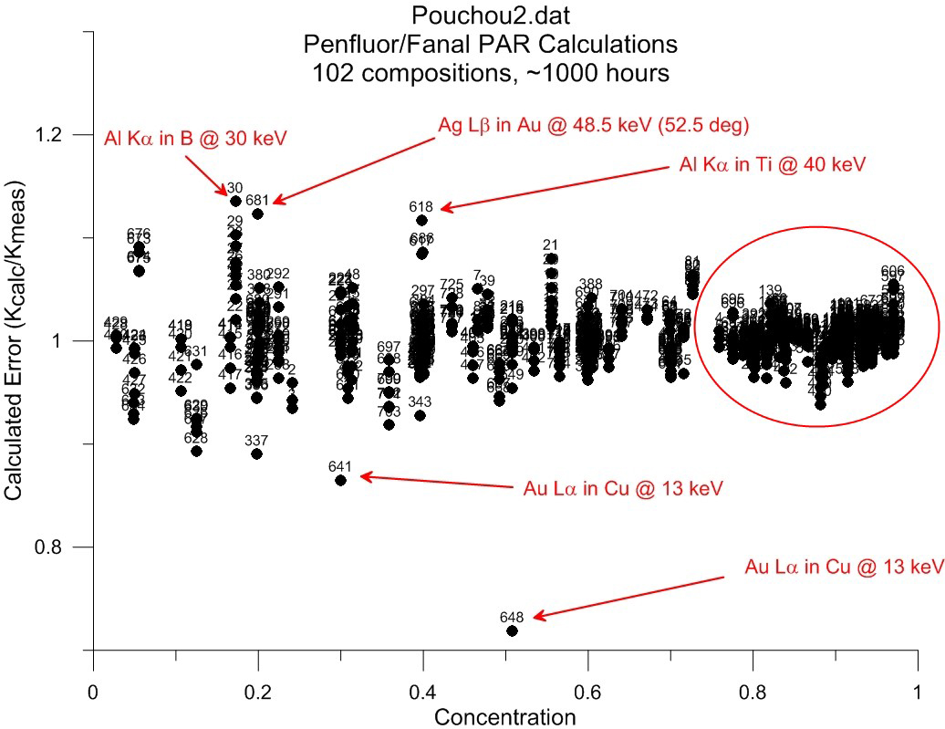

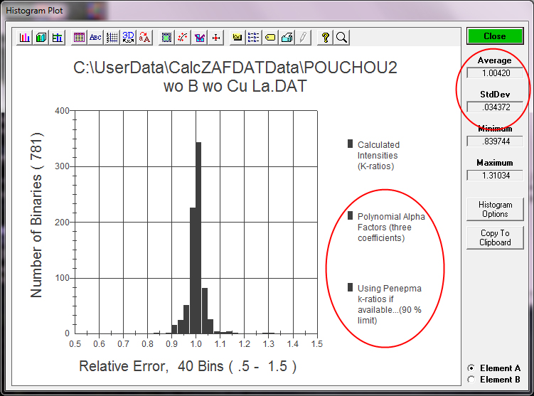

Here is the error histogram plotted for the full Pouchou2.dat dataset using specific compositions calculated using Penfluor/Fanal (Penepma for primary intensities and Fanal for analytical fluorescence):

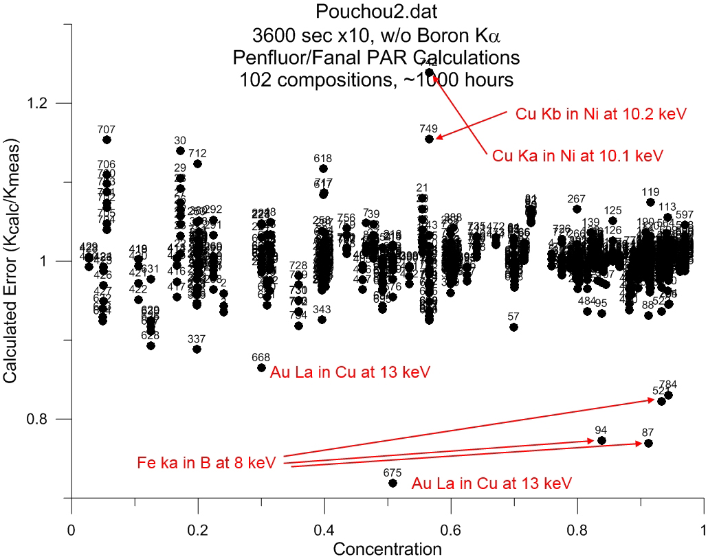

Quite good really, but lets look closer at a few of the outliers by plotting k-ratio error as a function of concentration as seen here (the data labels are the line numbers in the first column in the Pouchou2.dat file):
As one can see, many of these are at very high overvoltages where the absorption correction is very large, except for the Au La measurement at 13 keV which is a low overvoltage measurement.

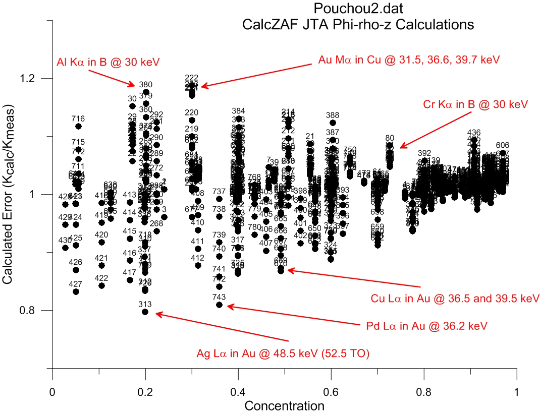

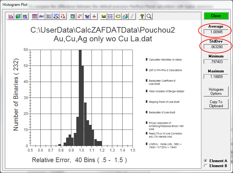

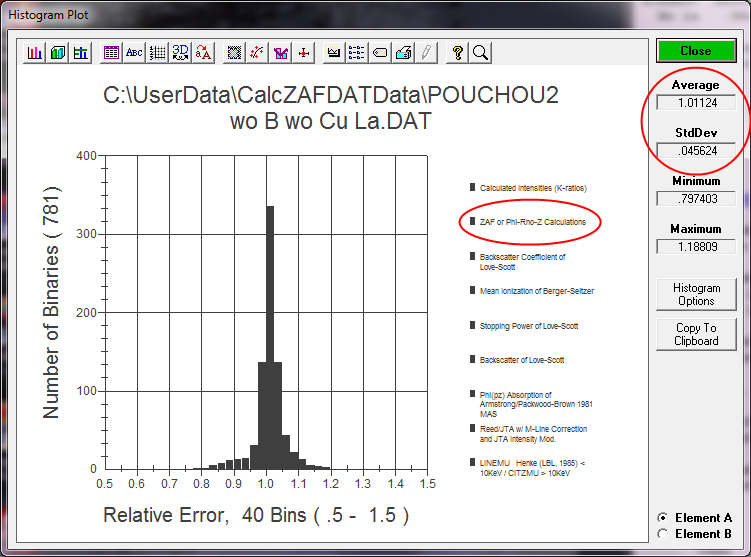

For comparison with the analytical phi-rho-z calculations here is the same plot using the default phi-rho-z in CalcZAF:
The Pouchou2.dat file is included with your CalcZAF.msi installation, but I attach it below for convenience.

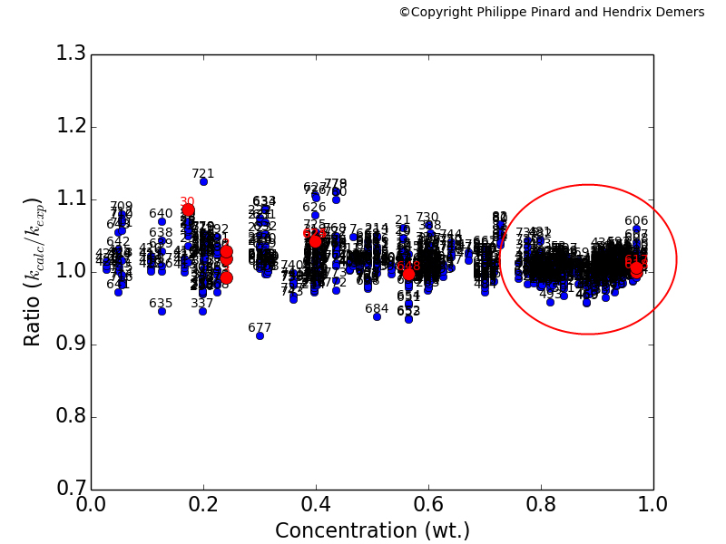

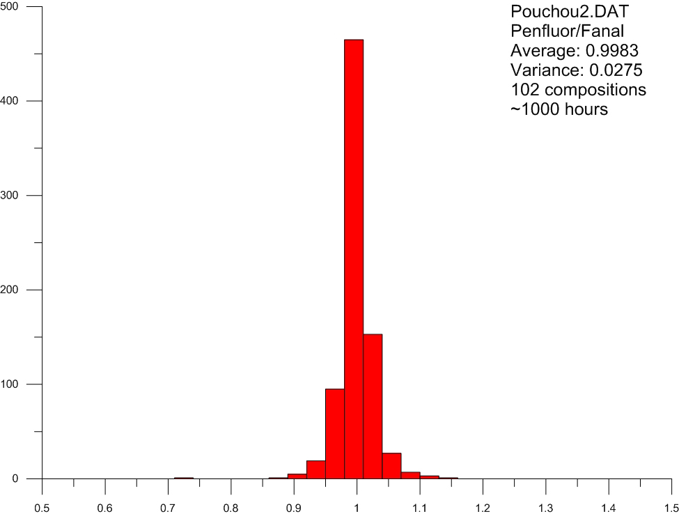

For comparison, results using the full-blown PENEPMA.
The points in red are those highlighted by Probeman in the PENFLUOR/FANAL graph. Note that the limits of the y-axis are different.

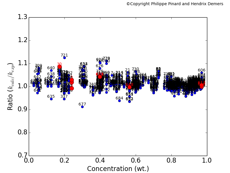

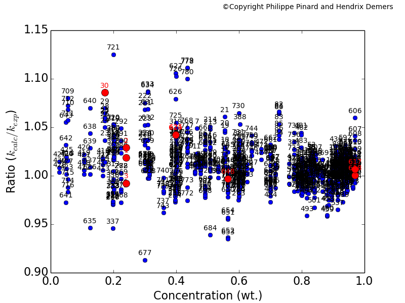

Edit by John: This is excellent!  Would it be possible to re-plot the data with the same axes as the others?  Which version of Penepma was utilized?  Do you see a difference between say Penepma 2008 and 2012?
Philippe Pinard
Same scaling.
The results are from PENEPMA/PENELOPE 2011. The simulations were run until an relative uncertainty of 1% was obtained for the x-ray line of interest. The detector was centered as the specified take-off angle and had an opening of +- 9 deg.
Hi Philippe,
I am surprised that there is so much difference between the Penfluor/Fanal and Penepema results given that the main difference between them is the treatment of fluorescence (Fanal does the fluorescence analytically).
I've got a back burner project to start calculating k-ratios for alpha factors from the full Penepma, but now it's going to get more attention...
Ok, here's another thing I realize after some thinking: if I compare the two graphs directly:
and
it appears to me that the high concentrations errors are more similar and that the Penfluor errors increase as the concentrations are lower. Since the default in Penfluor is to only calculate 3600 sec for each voltage this could mean that the Penfluor k-ratios used to calculate the alpha-factors are of insufficient precision.
I am going to do some comparisons with the full blown Penepma and check this idea...

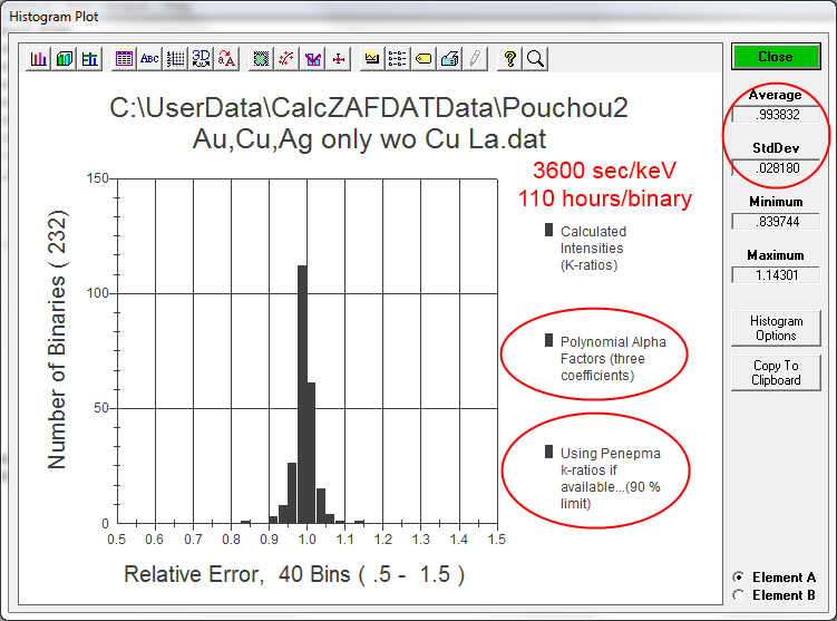

I would be very pleased if you have any experimental data comparing these new fast Monte-Carlo alpha factors with traditional analytical calculations.
OK, I've recalculated the Pouchou binaries using Penfluor/Fanal (without B Ka just as Philippe did above) and here is what I get now:
As you can see the outliers are now all very low overvoltage situations. This is because I used the default 3600 seconds per beam energy to obtain the intensities and at very low overvoltages the precision is insufficient under these circumstances. But this is very promising compared to the analytical codes in CalcZAF.
The advantage of the Penfluor code is that once you have a composition, you can extract multiple elements, x-rays at different takeoff angles and beam energies in seconds.  Because these intensities will be used to calculate k-ratios for alpha factors for matrix corrections for arbitrary compositions within the binary one cannot specify the precision in advance, as one can with Philippe's Penepma runs shown above.
Next I will compare to a 7200 sec per beam energy calculation to see how that improves the precision for these low overvoltage situations. Meanwhile the Monte-Carlo modeling continues...

I been making progress on utilizing Penepma Monte-Carlo derived k-ratios for fast matrix corrections in CalcZAF (and Probe for EPMA and CalcImage), and can show some new results (with newly extracted k-ratios with self-consistent precision levels) starting with the Au, Cu, Ag binary systems in the Pouchou k-ratio database.

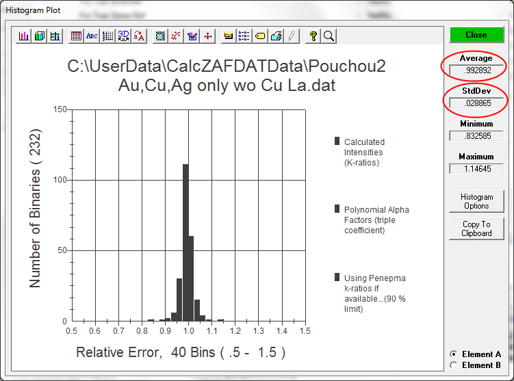

First Au, Cu and Ag binaries calculated at 3600 per keV (x10) times 11 binary compositions (from 1 to 99%) or 110 hours per binary system:
Note that while the preliminary Monte Carlo calculations take a long time, the actual matrix correction runs in seconds, quite comparable to the traditional analytical expressions we all use every day. Next here are the same Au, Cu and Ag binaries but calculated to a significantly higher precision at 14400 sec/keV (x10) times 11 binary compositions or 440 hours per binary system:
Note that the higher precision calculation gives both a better error average (closer to 1.000) and has a smaller variance. This is mostly due to several very low overvoltage situations in the Pouchou database.  Note: as we attempt even lower overvoltage measurements on FEG instruments to reduce our interaction volumes these, very low overvoltage calculations become much more critical.
But the good news is that already we are already getting better accuracy with the above fast Monte-Carlo k-ratios compared to the traditional analytical expressions. For comparison check the same binary compositions calculated using the JTA/Reed phi-rho-z, first without beta line fluorescence:

I've updated the matrix.mdb file for many new binaries. In fact most (though not all) of the binary systems in the Pouchou database have been calculated. For example, I have not yet extracted k-ratios for 75 degree takeoff angles yet!
But enough binaries have been calculated that it's worth comparing to traditional analytical physics expression accuracy. Both calculations below were done using the Pouchou database *without* B Ka and Cu La (there are bigger analytical issues with these emission lines!).
First here is the JTA phi-rho-z with beta fluorescence:
A decent average error of 1.01 and a variance of around 4.5%.  Now let's try the Penepma derived fast Monte-Carlo k-ratios fitted using polynomial alpha factors.
As you can see, an even better average error and the variance has decreased to around 3.4%!  I believe the era of fast Monte-Carlo has arrived...
