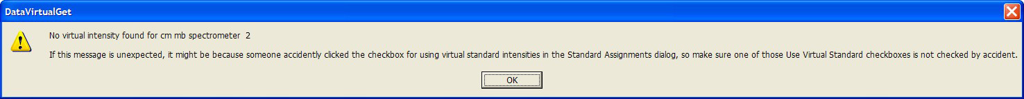

I get this error message with one of my virtual standards. Could you help me find out what I am doing wrong?

Not sure. Please send me your MDB file off-line.

Ok, this makes sense now. If you declared a std as "Virtual", then that means that the standard doesn't physically exist!  Therefore when performing automated peaking on standards from the Automate! window, the program automatically skips virtual standards!
So just peak the element manually from the Acquire! window as you just did, or uncheck the Use Virtual Standard checkbox in Assign Standards dialog. I'll also add warning for those virtual stds that are skipped during peaking.
Can I ask why you are declaring Cm and Am as virtual stds if you actually have them as physical stds :o!
As to why it can't find the 2nd virtual standard intensity, I will look into that.

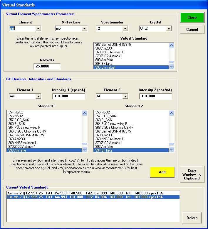

Problem is solved: I had selected Cm fake as the standard: I should have selected Cm virtual. This solved both issues at the same time!
Note: Cm fake is used to create an Am virtual standard.
Thanks for your help, John!

Glad you figured it out, but I'm still interested in why you are declaring Cm and Am as virtual stds if you actually have them as physical stds :o!
Unfortunately I do not have them as physical standards. I wish I had... I am using a calibration curve approach, presented last year at M&M... Following the same we used for Xe.
Quote from: Philipp Poeml on April 20, 2015, 09:46:03 AM
I see. So when you wrote: "Both standards are "pure metals" so have 100% of the element in question",  you didn't mean you actually have them!
Anyway, glad it all works now.
Ok, I see. Well, I had to define them as something in the standard mdb, and metals 100% are the most easy to calculate...
