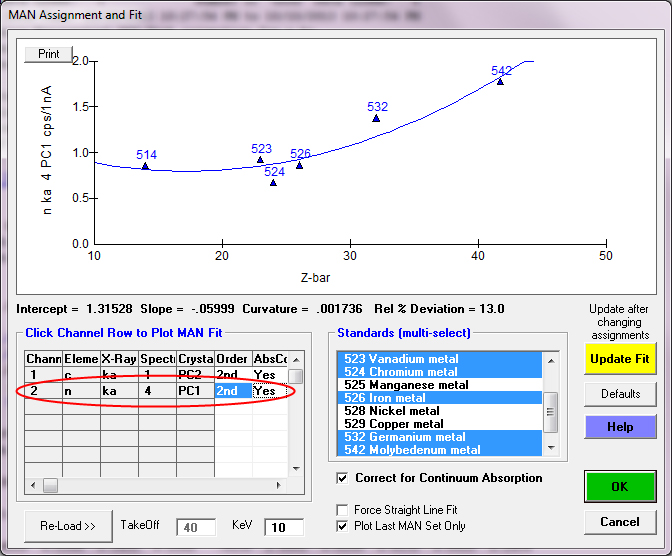

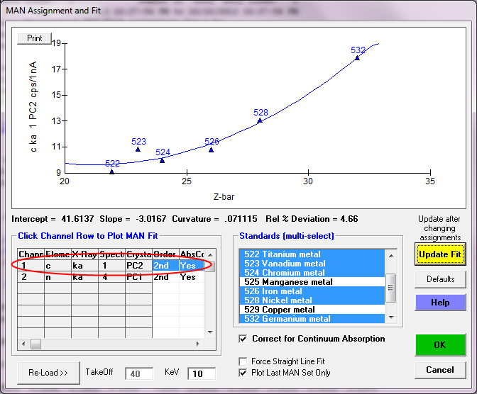

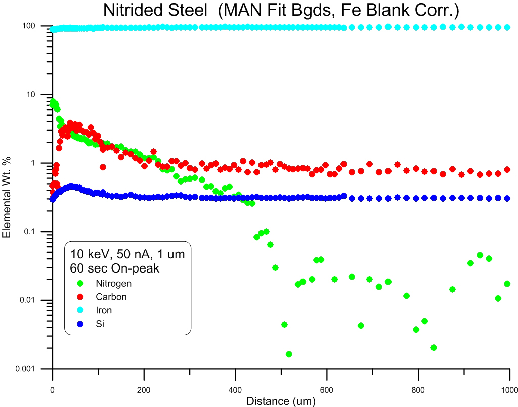

Here's another carbon (and now also nitrogen!) measurement in steel using an MAN background fit for carbon and nitrogen, both without and with a blank correction on a vacuum remelted Fe metal standard (O 310 ppm, N 10 ppm, C assumed 0 PPM).
First here are the MAN fits for carbon (PC2 crystal):
and for nitrogen (PC1 crystal):

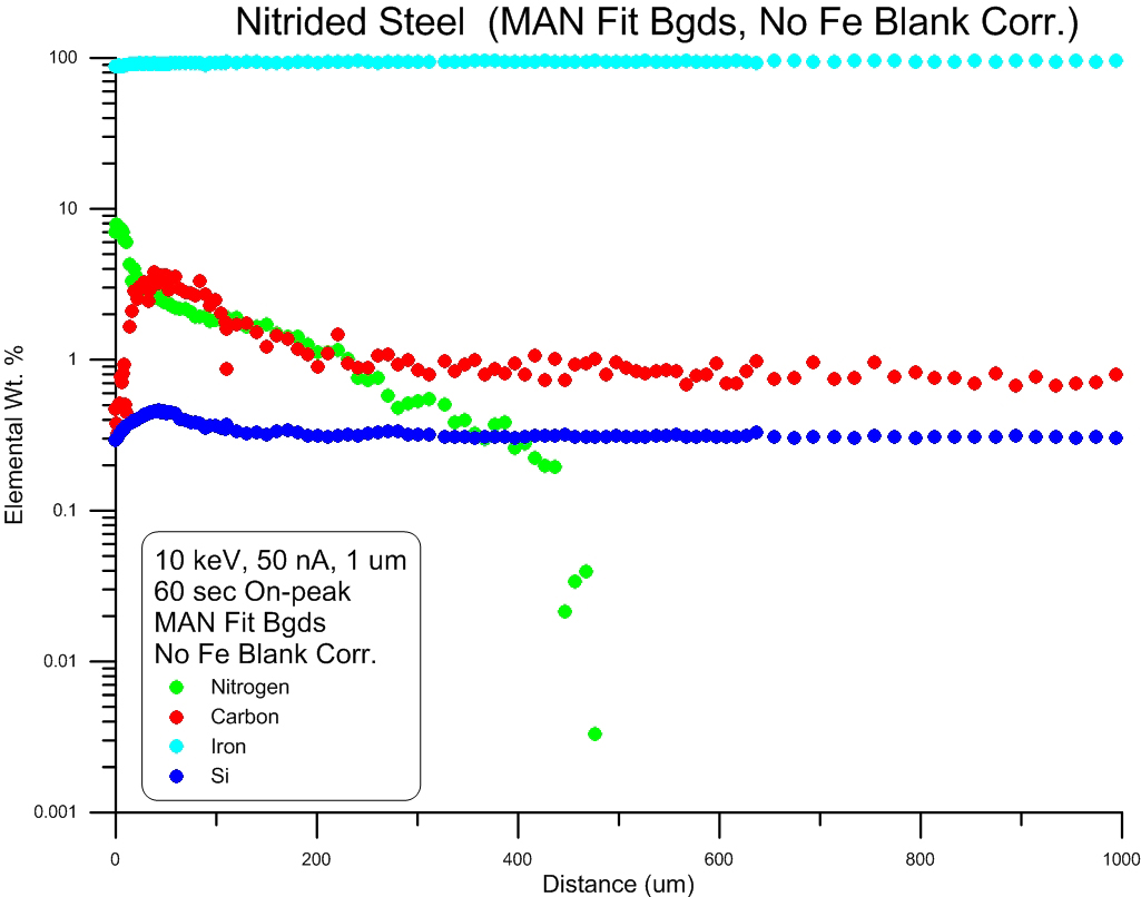

and here are the quantitative plots without the blank correction applied to carbon and nitrogen:
Note that the nitrogen values fall off the bottom of the scale because without the blank correction, the values are a few hundred PPM negative (and cannot be plotted on a log scale), basically the limit of accuracy for the MAN correction.
And now with the blank correction applied to the MAN bgd correction:
Note that the nitrogen values now approach zero (as they should).
This MAN background correction is very similar to the EU ISO method, except that we utilize several standards for the continuum fit model to deal with changes in average atomic number in the sample (up to 7 wt% N and 4 % C which yields an average atomic number of approximately 24.3 as opposed to pure Fe which is of course, around 26).

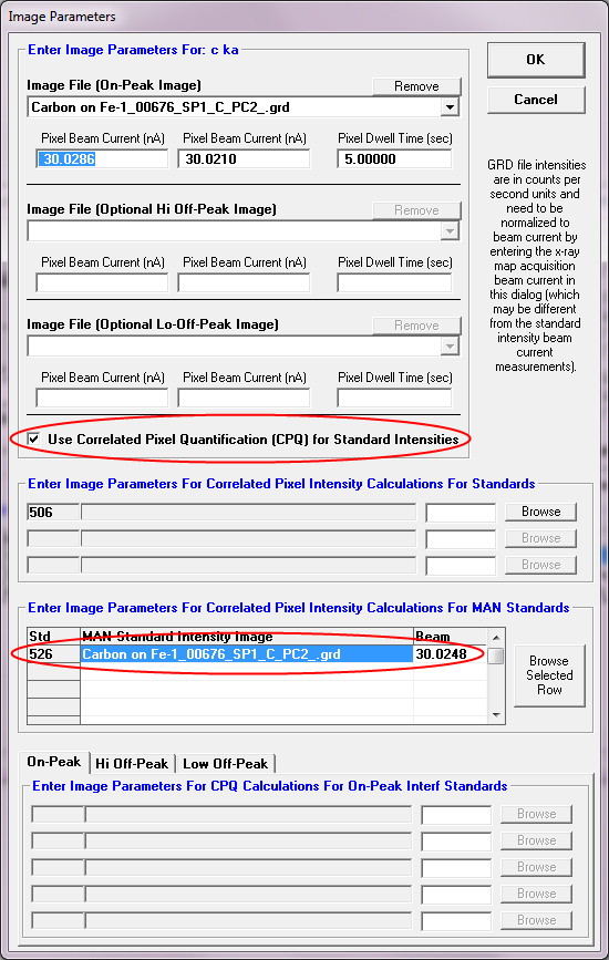

Here are some more carbon beam scan tests using 0.1 um steps to observe the contamination ring smearing effect I've run recently. I still need to do more measurements at higher currents but...
The first attached jpg is carbon ka on a vacuum remelted Fe std using the normal multi-std MAN background correction with multiple metals for the background fit, and with the "blank" correction turned on to improve the accuracy of the MAN fit. Note the large artifact from the carbon contamination ring "smear" as the beam progressively overlaps onto the previous carbon ring.
The next jpg plot is the same carbon beam scan image with the CPQ correction turned on for the MAN assignment of the iron std only. See here:
http://smf.probesoftware.com/index.php?topic=41.msg178#msg178
for a more complete description of the correlated pixel quantification (CPQ) method.
I didn't acquire beam scans on the other MAN std metals which means this is equivalent to the Aachen method of only using Fe for the MAN (on-peak) background measurement for carbon ka. Of course the blank correction needs to be turned off in this case. Otherwise, it's as though one is applying the blank correction twice! In the case of carbon about 300 PPM positive (see normal point analyses below).
The CPQ plot is using the carbon ka on Fe std beam scan for both the unknown image and the also for the CPQ std image so ideally the quant data should zero out.  Therefore, this is only a "sanity check" for PFE and CalcImage but still it's nice to see an average very close to zero.
Note the very small 10-20 PPM variance visible in the carbon CPQ plot which I suspect must be due to the differences in the absorption correction from the noise in the iron and nitrogen signals in the beam scan image (carbon ka absorption correction is around 200% in an Fe matrix).

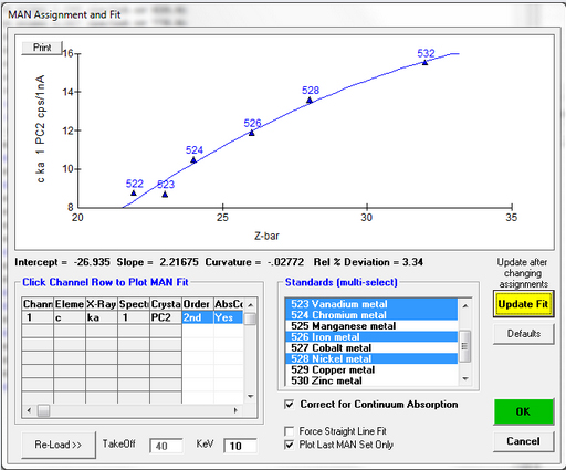

I thought about using the MAN correction for carbon analyses but I would like to caution you here when you cannot keep the carbon contamination minimal (with an air jet for example). Namely because the amount of carbon contamination on your "blank materials" is not constant but material dependent. This has been reported in the Bastin&Heijligers (1986) paper on the binary carbides and we also see it in our analyses (and may be one reason for the variability seen along your MAN fit). It has been suggested that the thermal conductivity of the material (this is how fast/much it heats up under the beam) is responsible and we are currently trying to test this further. Obviously the beam diameter also factors in and needs to be similar to the unknowns.
Therefore, the MAN standards in the appropriate Z-range also need to have similar thermal properties and should be chosen with caution (for example when using a small number of standards).
Quote from: Anette von der Handt on March 28, 2014, 05:59:33 PM
Hi Anette,
Yes, exactly. I agree. That is why the MAN standards selected here:
http://smf.probesoftware.com/index.php?topic=48.msg270#msg270
are all metals (with approximately similar thermal conductivities) as is the unknown material (essentially Fe metal). For carbon analyses, I agree this is an important aspect of controlling dependent variables.

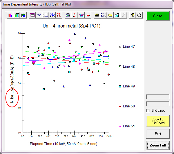

I decided to acquire some data to see if we could quant carbon using the MAN correction on metals. First I had Julie polish and Ag coat one of our standard blocks with about 15 nm of Ag. I then analyzed C, N, Mo, Fe and Si in pure C, AlN, Mo, Fe and Si (for a range of x-ray energies and average Zs), at 10 keV and 50 nA (for improved sensitivity).  I counted 80 seconds on each data point (on-peak MAN only for carbon and nitrogen) and used 16 TDI intervals ( 5 sec each).
First of all, just as shown in the previously acquired data above, the carbon signal shows a small *decrease* over time while all other elements remain stable within precision:
Here is nitrogen Ka:
As for the quant, here you can see that results on a pure Fe std (but acquired separately from the MAN background stds), gives zero within precision for all elements (except for Si at 230 PPM which could be due to the colloidal Si polishing) :
Un    4 iron metal, Results in Elemental Weight Percents
ELEM:        C       N      Mo      Fe      Si
BGDS:      MAN     MAN     LIN     LIN     EXP
TIME:    80.00   80.00   60.00   60.00   60.00
BEAM:    49.75   49.75   49.75   49.75   49.75
ELEM:        C       N      Mo      Fe      Si   SUM
    47   -.023   -.018   -.025 100.090    .023 100.047
    48    .032    .037    .005 100.471    .025 100.570
    49   -.010   -.043   -.006 101.030    .021 100.992
    50    .005    .006   -.004 100.380    .026 100.414
    51   -.013   -.030   -.031 100.456    .021 100.404
AVER:    -.002   -.010   -.012 100.486    .023 100.485
SDEV:     .021    .032    .015    .341    .002    .342
SERR:     .010    .014    .007    .152    .001
%RSD: -1244.94 -331.31 -125.84     .34   10.30
STDS:      506     672     542     526     514
STKF:    .9705   .1485   .9901  1.0000  1.0000
STCT:  23361.3   459.1  4349.2  1085.6 73411.0
UNKF:    .0000  -.0001  -.0001  1.0048   .0002
UNCT:      -.2     -.2     -.5  1090.8    15.0
UNBG:    148.0    13.6     9.2     7.9   134.1
ZCOR:   2.4870  1.5301  1.1661  1.0000  1.1457
KRAW:    .0000  -.0004  -.0001  1.0048   .0002
PKBG:     1.00     .99     .95  139.30    1.11
INT%:     ----    ----    ----    ----    ----
TDI%:    5.364   -.141    ----    ----    ----
DEV%:       .6     3.2    ----    ----    ----
TDIF:  LOG-LIN LOG-LIN    ----    ----    ----
TDIT:   131.80  134.00    ----    ----    ----
TDII:     148.    13.3    ----    ----    ----
TDIL:     5.00    2.59    ----    ----    ----

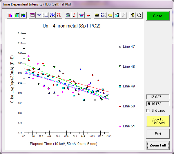

I also performed some "fast" beam scans in Probe Image *on the same spot* on pure Fe and will examine that data next week for TDI effects, but in the meantime here is my question:  is the small decrease in carbon signal over time, something that is observed on other instruments?
I would have thought that the carbon signal would increase over time, not decrease...   so I have to wonder if the cryo baffle (~100 Kelvin) on my instrument is somehow related to this?   I would be very grateful for similar measurement results by other labs...  thanks!
Again this is a freshly polished Fe metal sample coated with 15 nm Ag and measured at 10 keV and 50 nA. In any case, a standard deviation of around 200 PPM for carbon in 80 seconds isn't bad. That is, with a 5% TDI correction (+/- 0.6%). Which would correspond to an absolute TDI correction of ~800 +/- 100 PPM concentration.
Finally, is this decrease in carbon intensity simply related to the so called "decontamination time", as coined by Stuart Kearns, et al.

Though I would have expected the decontamination effect to apply only to the first 10 seconds or so, at most?
I think its the decontamination effect as you mention. Your not hitting it that hard so its taking a long time to remove the surface carbon. What spot size did you use? I did some tests a while back - but I don't know where the TDI curves are. Anyway I decided at 100 nA 15kV 1um beam I wanted to hit the sample for ca, 30-60 secs before analyzing it. The TDI curves were variable in there behavior but generally over the first 30-60 secs the carbon decreased and then flattened. This was using a LN cold trap.
Have you tried the tdi for a longer time/different power - does it flatten our with time - suggestive of decomtamination?
This was 10 keV, 50 nA fully focused.  I have to say I'm a little surprised that you think it might take 30-60 seconds to "de-contaminate", but I guess I could try with a less focused beam.

Here are my results (attached below) from performing 10 stage scans each 32 pixels wide (~4000x or ~94 um wide), using carbon Ka (and nitrogen Ka) on pure Fe (freshly polished and coated with 15 nm of Ag), with each scan repeated on the same area.
The 10 stage scans were separately defined in Probe Image (actually pretty easy to do, but I will have Brian implement a TDI option if this method turns out to be as promising as it seems to look), and therefore each scan took about 32 seconds of actual acquisition time and around 45 seconds each with all the software/hardware overhead involved.
Of course I will also need to modify CalcImage so it automatically loads in these replicate TDI scans so it can extrapolate automatically back to zero time, but that shouldn't be too difficult as Probe Image already time stamps each scan at the beginning and end automatically.  This should work whether the scan is a line scan or a full frame scan...
The total time on each pixel was about 10 seconds, which is what we would likely utilize for trace carbon analyses although of course this could be increased for improved sensitivity.
I have to say this method might be very useful for trace carbon analyses, not to mention beam sensitive samples!   Has anyone heard of this idea previously?  Or tried it yourself?

Having done with Phil here earlier today a C Ka TDI count, I have a comment/suggestion.
A TDI acquisition was done (spot mode) so we aren't talking imaging, but rather the philosophy of TDI upon 'sensitive' material, and we did a similar acquisition and it showed a 'linear' (in the log window).
I was suspicious, so said, instead of having a LONNNGGG dwell period of 12 seconds, let's be devils advocates and see if, like in hydrous alkali glasses, whether there is an immediate change in the first second or so...and guess what, the plot now was exponential on the log window.
We were going to suggest that you might want to implement a modified TDI approach, in allowing the user to pick an option of doing a (variable short time, such as one second)) count for the _first_ measurement, which could pick up any sharp change over the first count period.
I know it might be difficult to implement, but you are a smart guy!
Flattery will get you everywhere!      :-*
Seriously, this would be pretty difficult to implement.  You do know about the option where one can weight the first few TDI measurements?
http://smf.probesoftware.com/index.php?topic=11.msg2520#msg2520
It sort of amounts to the same thing you and Phil are suggesting...
By the way, here are the N Ka data that was acquired at the same time (see attached below). The confidence intervals displayed are for 99%.
Again, by the way, these analyses were performed *without* a blank correction, which would obviously improve these trace measurements.
I would sum up by saying that one can perform excellent trace carbon quantitative analyses using the following methods together:
1. MAN backgrounds
2. Normal matrix corrections
3. Quantitative interference corrections (a la PFE)
4. TDI correction (I generally use asynchronous mode as the new acquisition code doesn't really take any longer than the old synchronous code).
Remember, if you have a suitable standard with a matching matrix, one can alternatively perform a "blank" correction, but not with the interference correction, or you will get a "double" correction on the trace element... though the software will warn you about this!
