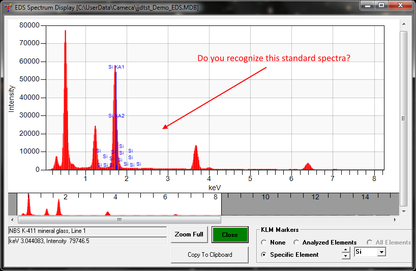

I should add that the Thermo NSS demo mode (when SystemSIXSim.exe is running), always produces a Cu-Al spectrum...  anyone know the actual composition of that material (just for fun)?
The Penepma EDS acquire demo mode will produce actual spectra for the specified standard (which can be quantified along with the demo WDS elements) or a random composition if the sample is an unknown.
Here is an example of a "demo" EDS spectra acquired in PFE using the Penepma Monte Carlo code running inside Probe for EPMA:
