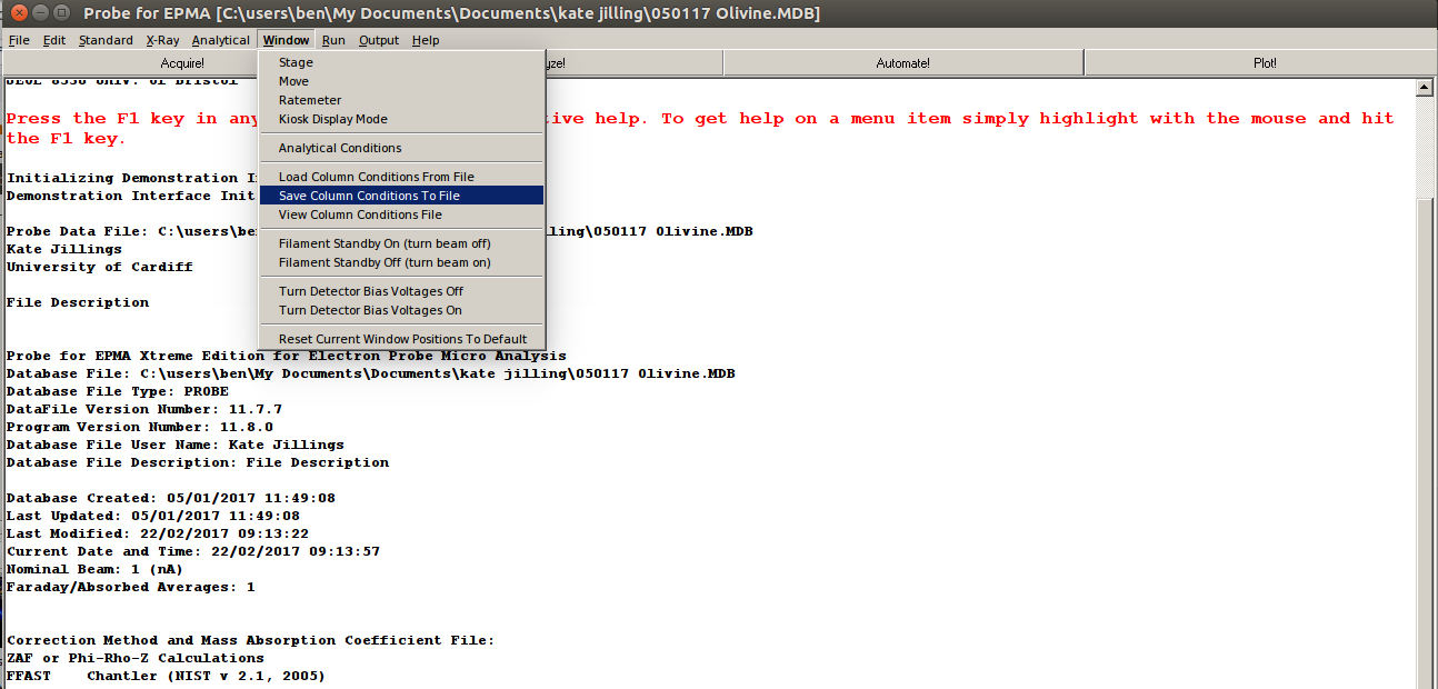

Ben and John, I was just looking at your work around for the focus and shift issue with combined conditions. I tried it with our JEOL 8530F and couldn't get it to work.  Specifically, I couldn't get my PCCs to save.
First, when you say the main window, I assume you are talking about the opening window for PfEPMA.  Is this correct?  When I go Window -- Analytical Conditions --  it won't let me save here.  I can 'save' in the combined conditions setup. But when I go to load, the saved conditions are not in the directory.
Ben, could you post more specific instructions on how to do this?
Hi Dawn,
The only issue I can think of is that you should update PFE to the latest version using the Help menu.  Then you should be able to do exactly as Ben described.
Also, after updating PFE, check your Probewin.ini file and find the keyword "ColumnConditionPresent" and make sure it says:
ColumnConditionPresent=1
#39
Hi Dawn,
Sorry I've only just seen your post - did you sort it. For saving PCC - it should be as shown on screenshot below
